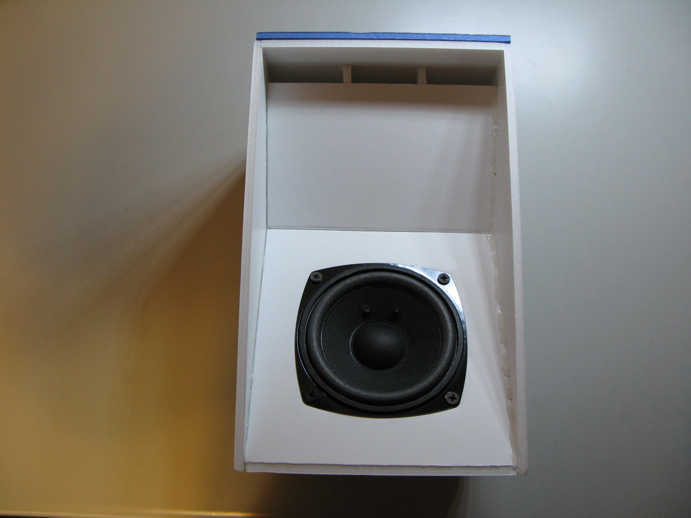

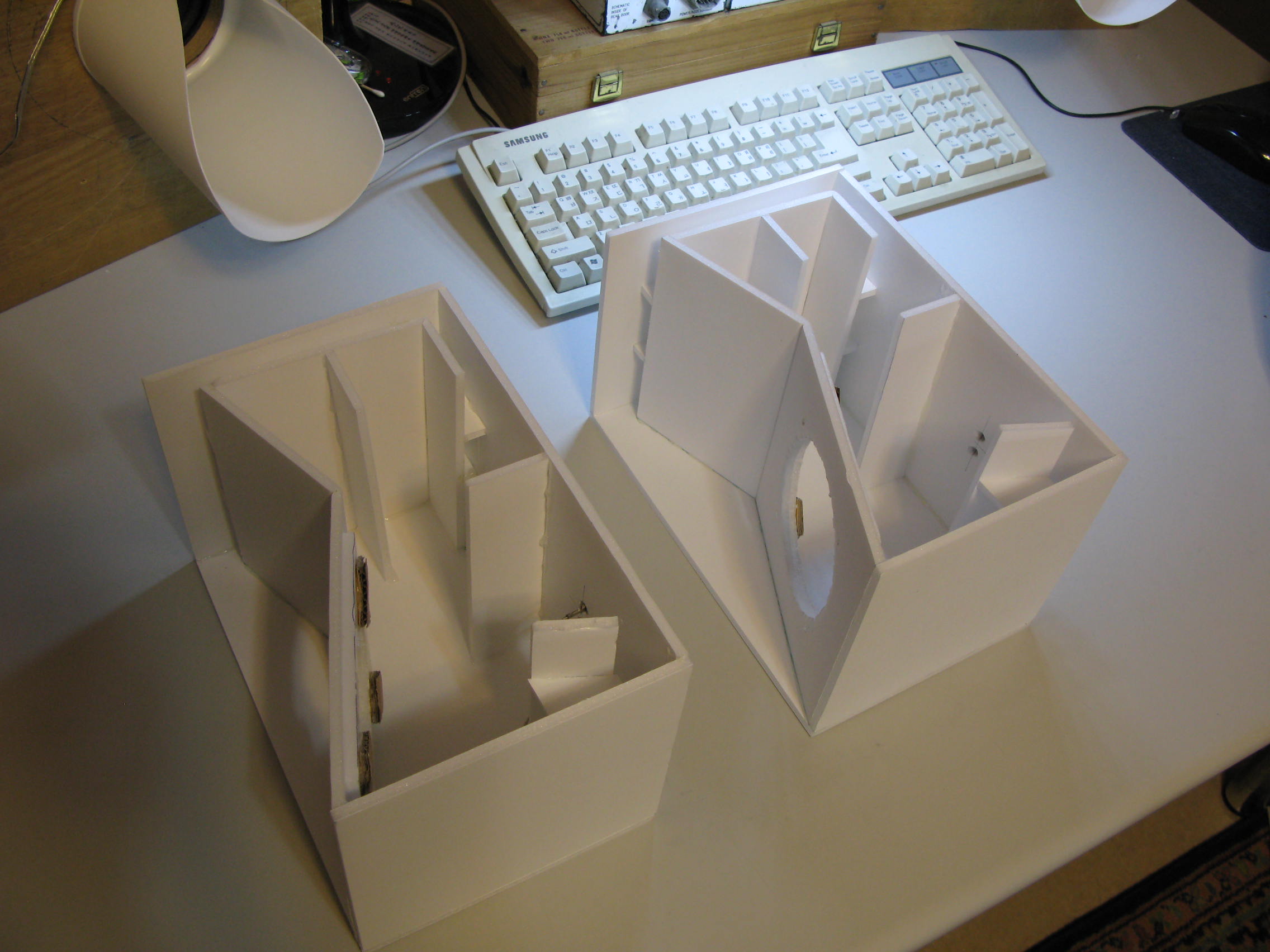

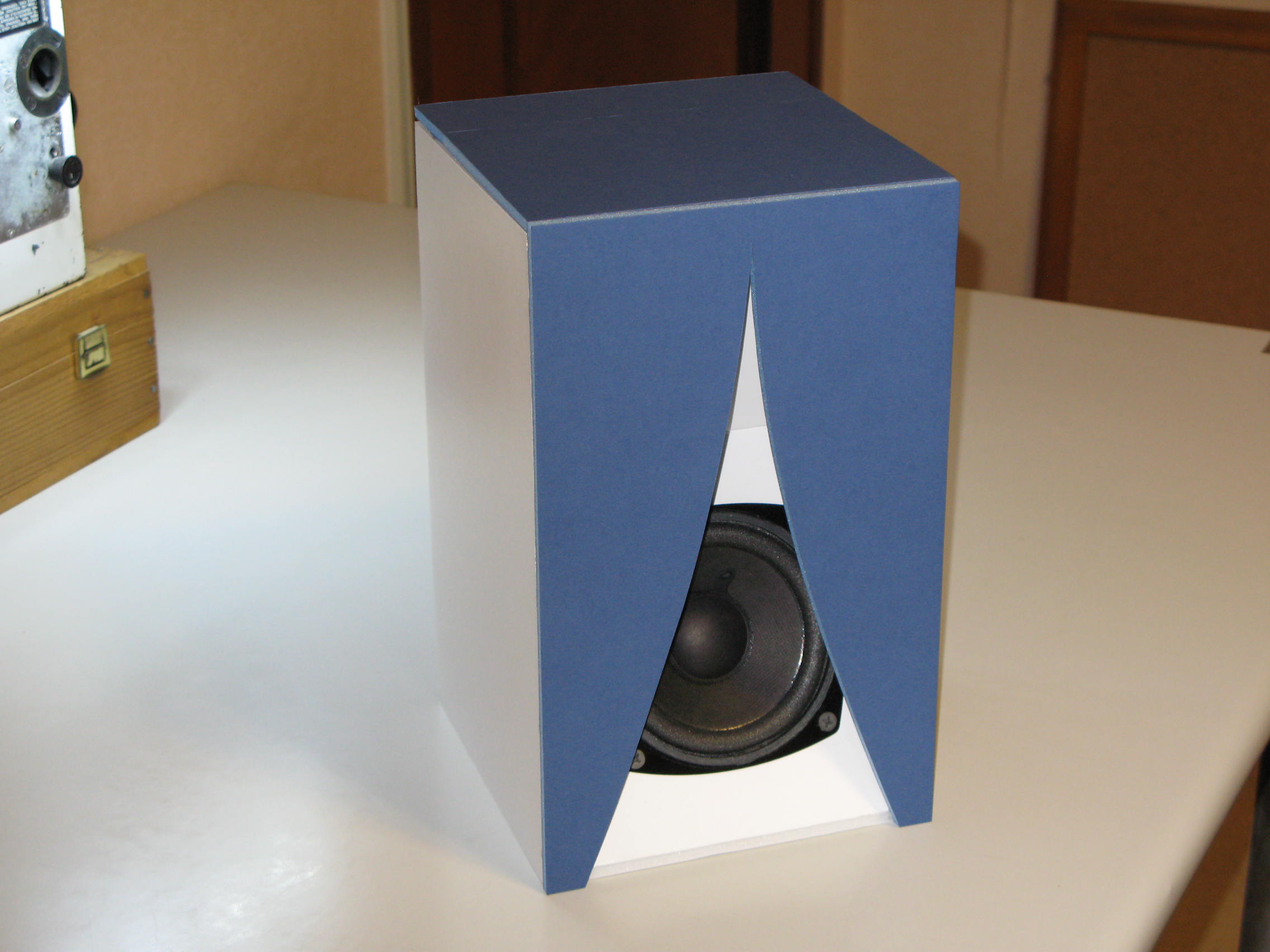

XKi with Sammi 4 inch fullrange

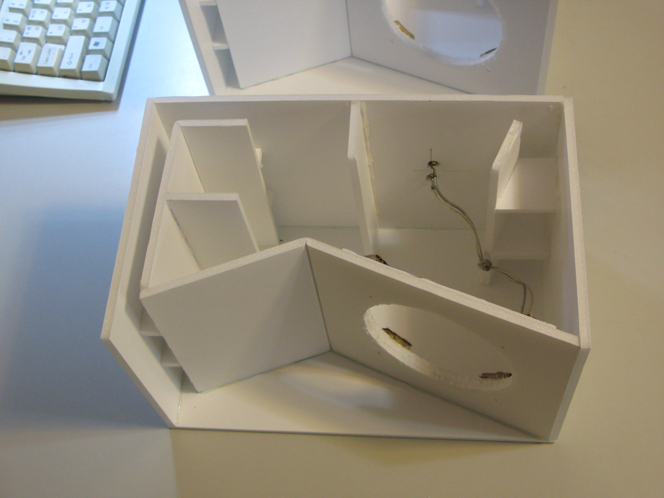

I wanted to make the XKi ever since it was first introduced in January, and I finally got to finish it today.
And it sounds... AWESOME! 😱
The BASS that comes out of this thing is amazing!
Why didn't I make this sooner?(I'm kicking myself)
The driver is a 4 inch Sammi fullranger. Had a couple at hand, and since it's TS params are similar enough(to a newbie's eyes) to that of Alpair A6p which sk971(xrk's brother? LOL) inquired in post #110 and answered in #120, so I gave it a go.
I hope I have the measurement devices and the experience like you guys so I can post some numbers and charts.(well, you never know... 😉)
Anyway, I'm so impressed that I'm thinking of building an 8 inch version with MDF this time.
Great job as always, xrk! Thanks for sharing the design!
And thanks to Freddi also, for helping me discover the Karlson! 😀

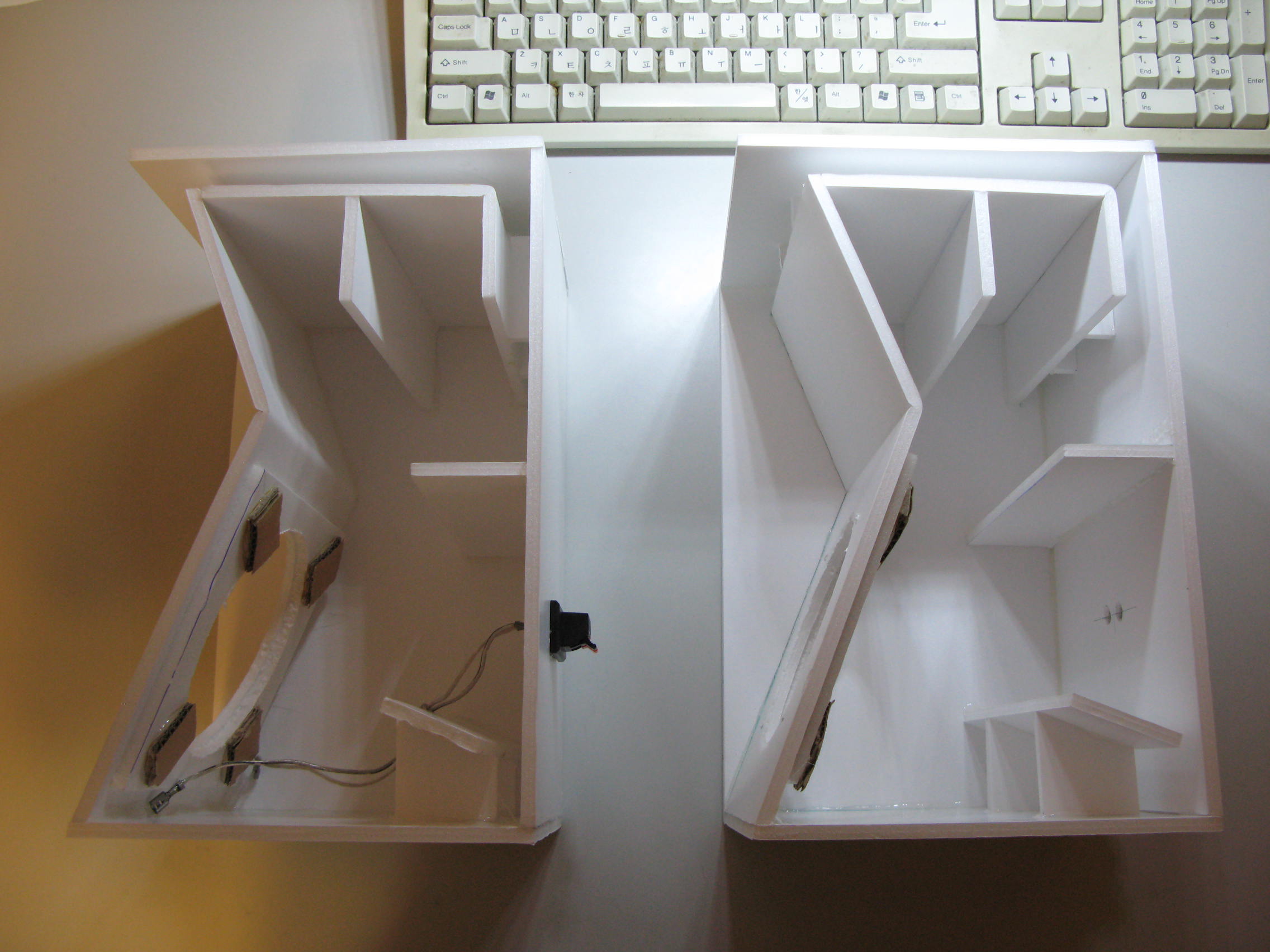

Bolex,
Great looking speakers there! You have some unbelievable foam core crafting skills there. The quality of the workmanship is top notch. I can't even make one that nice looking🙂
Glad they worked out for you. If you have an 8in driver in mind - get me the TS and I will get you an optimal design from volume and vent sizing standpoint. These do have perhaps the most bass bang for the buck of almost any full range speaker.

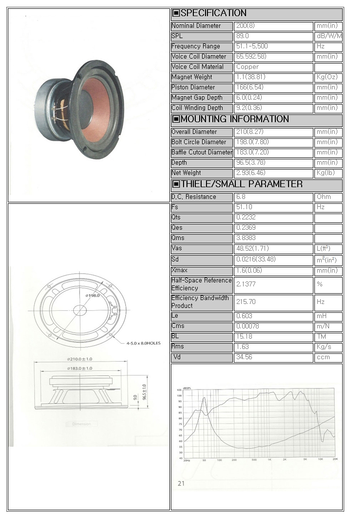

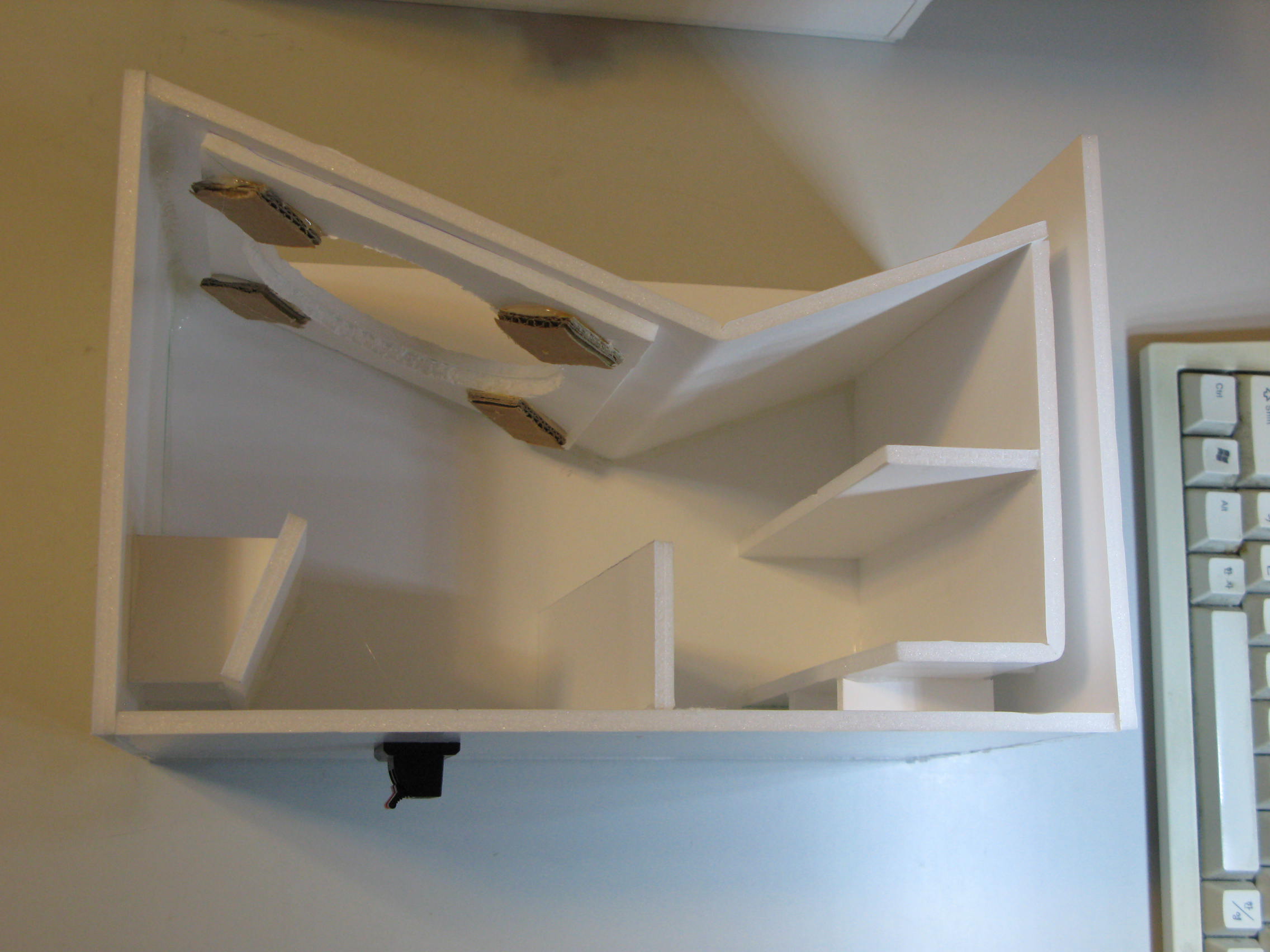

xrk,
Thanks for the kind words. I try my best just to catch up with you.😉
(frankly, I think it's all in the colored foam core, LOL)
I've attached the TS for my 8 incher.
I was trying to get this driver to work in the klam(and load it in a horn/paraline - just having all kinds of fun with it) but no matter what I did, I couldn't get rid of the unwanted sounds(ringing?) coming from the klam.(I must have been doing something wrong😕)
Seems it is much better using an oversized pipe like the 'tube', compared to the klam, but that's just me...
Anyway, this driver's range is limited(51~5500), and I intend to use it in the XKi for a 2 way(ekonowave?), or perhaps as a midrange in a 3 way.
Please let me know what you think.(I assume it is suitable for XKi, but is it...?)
Thanks!
Steve.

Bolex,
Let me plug in the TS to the Akabak model and see what I get. I suspect the Vas is kind of big. 48 liters for an 8in indicates a soft suspension and a strong motor.

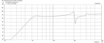

I think it can work but you won't get very deep bass extension due to the very low Qts. Bass SPL=88.5dB at 2.83V, and if you are OK with a 63Hz f3, here is what I came up with:
18 liters (1100 cu in) total volume, width=10in, vent height=0.5in vent width=10.0in, vent length=8.0, front volume is 1/3rd total volume. Make K-aperture as usual with similar areas and aspect ratios of your last build.
This is about a 12 in high box, 9.25in deep, 10in wide box. You will need to increase height or depth a little bit to account for volume loss due to the vent and middle baffle panel and driver. So maybe 13in high x 9.5in deep x 10in wide can work.

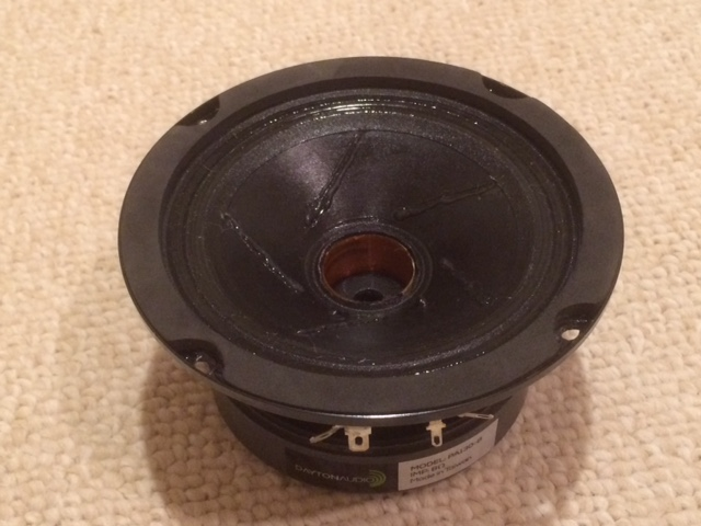

Yo X, did you try any tweaks yet with your PA130?
I have a suggestion/idea: cut a disk from aluminum foil to cover the dustcap. Spray it with Super 77 and apply. It would be easily reversible by warming with a hair dryer etc and pulling it off. If you wanted to get fancy you could do it with a few pie slices to avoid wrinkles.
Yes, it's all in the Daytonator thread...
Sadly, I cannot try the aluminum foil mod on dustcap as the one sample under the knife already has had its cap nipped.
I have one remaining unit but wanted to keep that stock for comparison later. Also, I am good with potentially killing one good $18 driver but can't find the heart to kill two 🙂

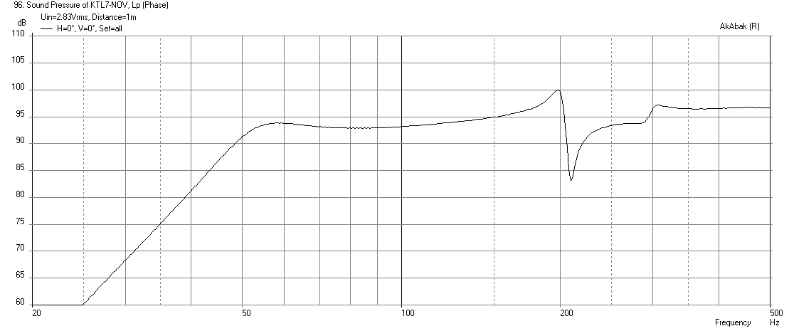

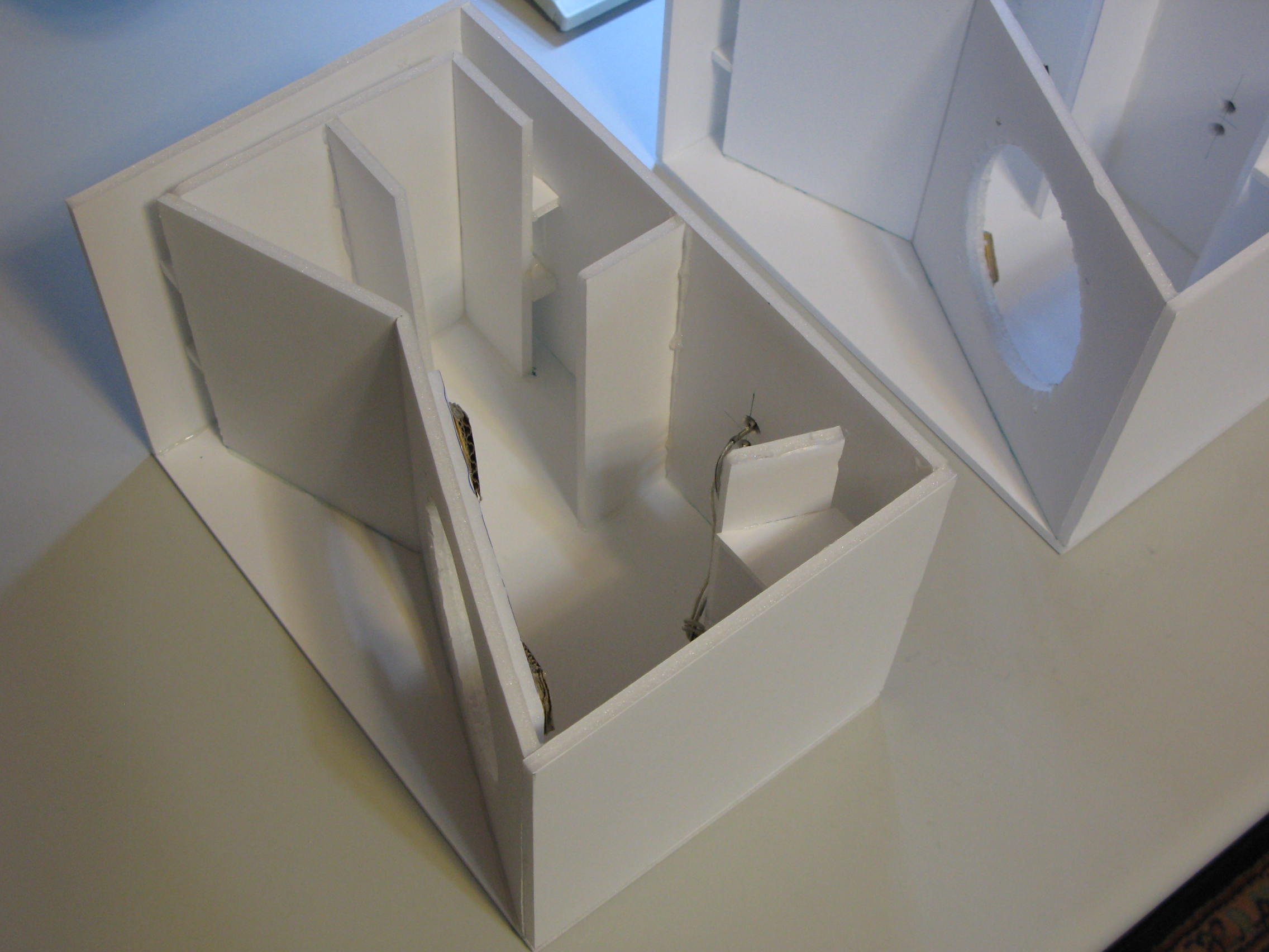

For the A12P, I think I can get a better result with GregB's Karlsonator scaled to 0.67x in all dimensions. Here is the predicted response (-3dB is 48Hz with 93dB sensitivity):
With XKi, I am getting too much of a mid 250Hz overshoot from the band pass effect. It may be doable with more tinkering but I think I would go with Karlsonator at this point for best performance.
- Full Range
- XKi - X's ab initio Karlson 6th Order Bandpass
