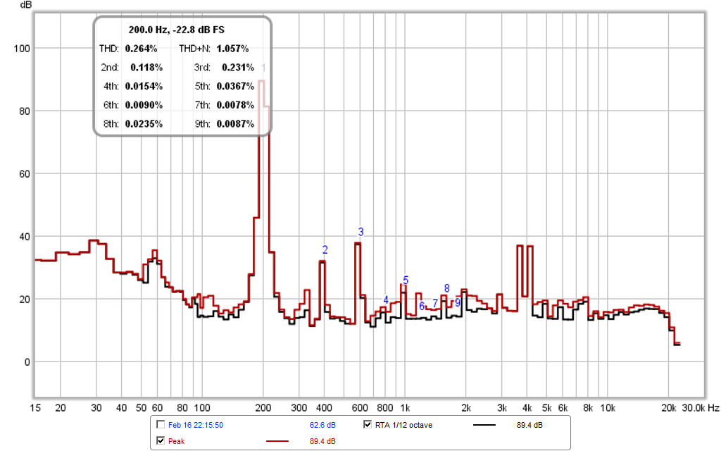

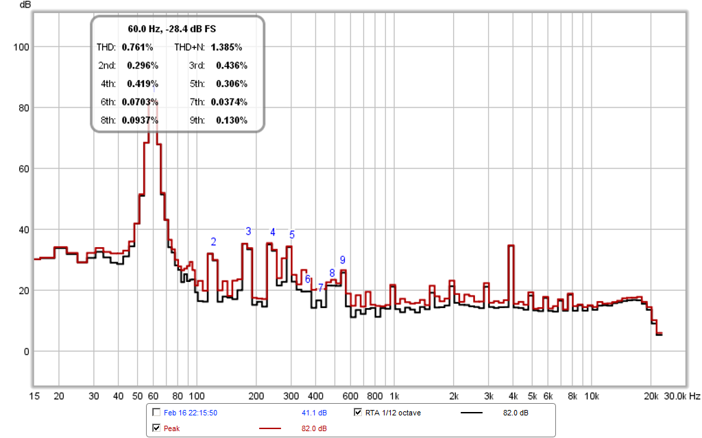

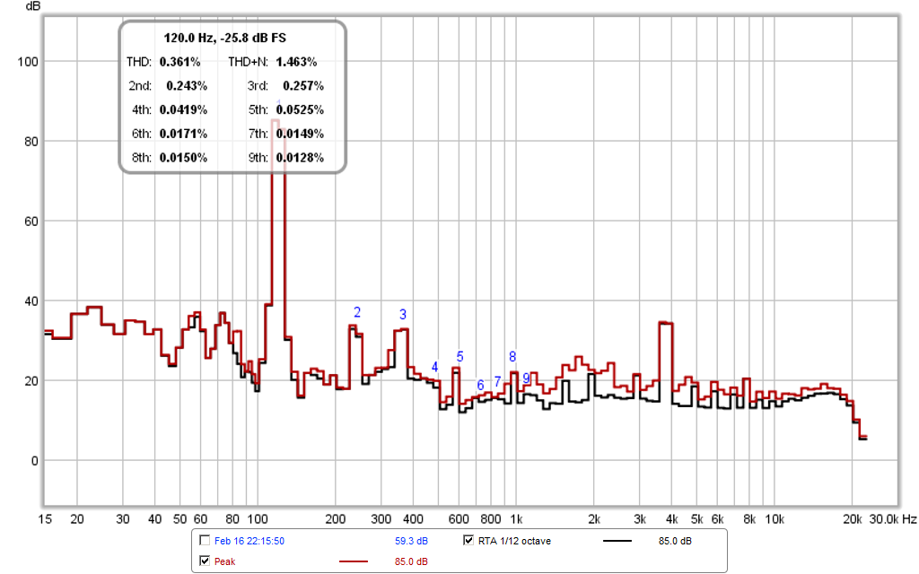

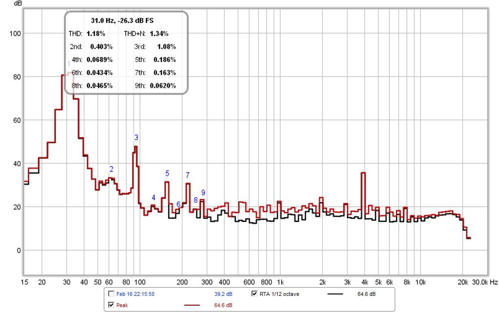

Here are some distortion measurements at 2.83V and 1m for 31Hz, 60Hz, 120Hz, and 200Hz. Also some bass heavy sound clips that I know generally tax the performance of woofers and subs. Clips are from a TC9FD Dagger TL in a FAST with XO at 250Hz. Sub is giving a pretty wide bandwidth performance - about 3 octaves.
RTA was produced using Sine generator in REW and RTA function in REW with 16-sample average. HD is typically less than 1% at 1 watt input and circa 85dB to 90dB.
30Hz:
60Hz:
120Hz:
200Hz:
Let me know what your impressions are after listening to the bass...

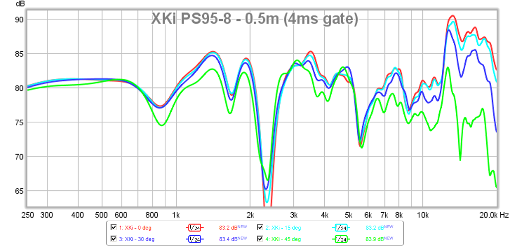

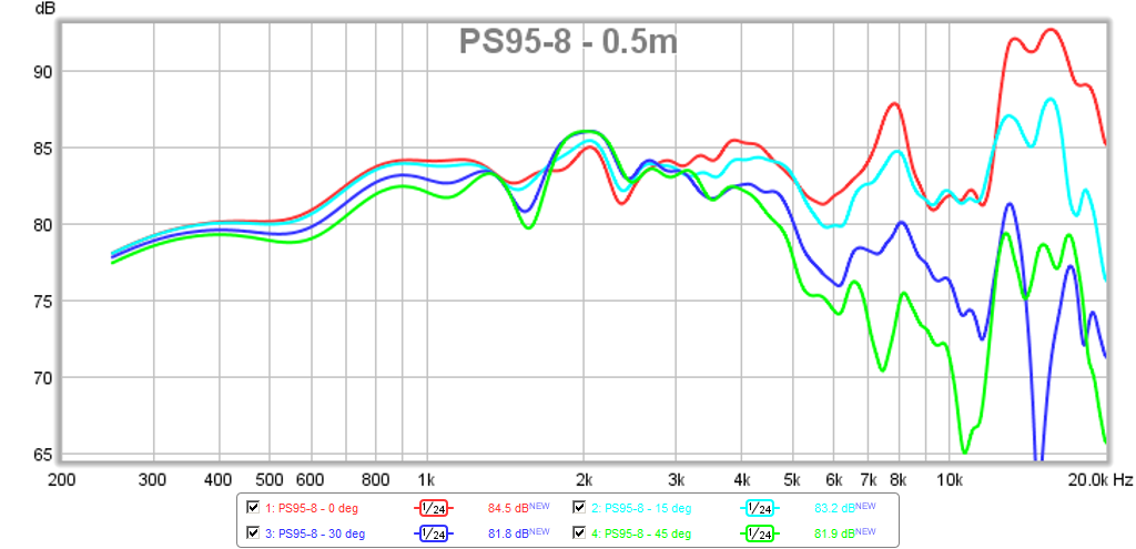

Look at what a K-aperture can do for a messy polar
I did a careful study of some 3in drivers here (http://www.diyaudio.com/forums/full-range/270094-objective-comparison-3in-4in-class-full-range-drivers.html) and took a polar of the new PS95-8 driver from Dayton. It is a nicely built 3in paper cone full range with cast basket.
Here is the polar in an open faced Nautaloss at 0.5m with 4ms gate:
Putting that driver in the XKi I built for the RS100-4 and you get this - quite an amazing improvement in polar uniformity at the cost of a few sharp dips. Less than a 5dB variation between o dg and 45 deg at 10kHz and less than a 2dB variation up to 30 deg, and the mess at 15kHz really cleaned up to a consistent peak rather than wide variability - this means applying EQ can work as it is angularly independent:

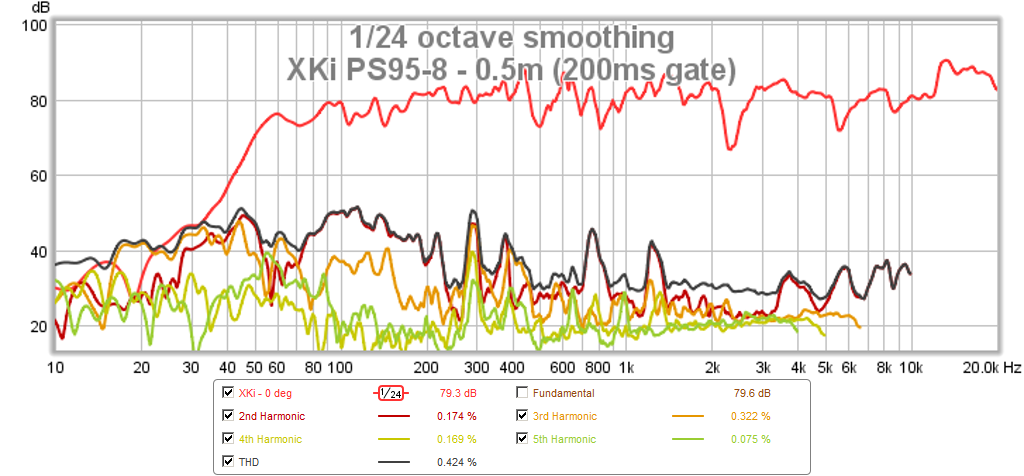

Here is the bass extension and HD, not bad - very listenable and with some "air" due to the enhanced response above 10kHz - like having a super tweeter:
I think I can recommend this new driver - at $23 it's a bargain.

yes - that's quite even coverage - nearly perfect - re:dip - there may be a combination of dimensions to avoid/reduce it - in practice I think the only time it would be a problem would be when sine is applied at the dip frequency. Can you hear "it"? btw - I'm looking for a higher efficiency tweeter to use behind a K-slot - haven't yet measured a GRS 1005 - a transformer would bring nominal sensitivity of a 0.13uF piezo up to around 103dB at 2.8v - I'm not sure what happens when the wavefront from a little round horn hits a K-slot.

I can't hear the dip at 2.4khz when listening to music. It is there when the sine sweep is performed of course. 2.4kHz corresponds to 2.8in which may be the distance from cone to K wing. Perhaps some damping pads glued to backside of K aperture? Even though the XKi was tuned for the RS100, it performs very well with the PS95. Clearly audible 60Hz bass extension. The higher Qts and larger Vas means the cabinet could be bigger and the bass SPL might be brought up a bit. The super tweeter effect is nice - not fatiguing as above 10kHz.
The CHN-70 is too big to put in the same box, besides the Vas is much bigger and means a new box will be needed. I would imagine the 600Hz to 7kHz plateau might be somewhat smoothed but I fear the amplitude may actually increase. That would sound worse.

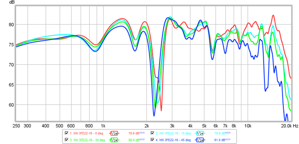

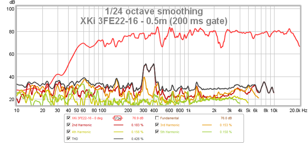

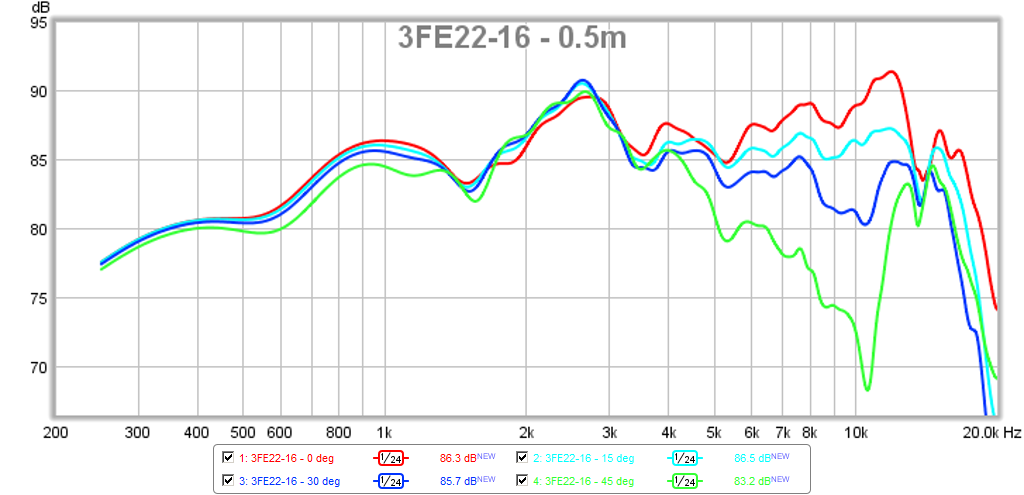

XKi with 3FE22r16
I stuck the 16ohm 3FE22's in the same XKi cabinet and it worked almost as good as the PS95's. Less bass but the output above was very smooth. Again, the polar response uniformity is exceptional.
Here is polar response, again 5dB variation over 45 deg at 10kHz:
For comparison, here is what the polar response of the 3FE22r16 looks like in an open face Nautaloss:
Here is the frequency response and harmonic distortion. I think there is a loose screw on the K-aperture that cause a rattle which shows up at 300Hz-400Hz:
I definitely think that if you are looking for a speaker with a wide sweetspot, this is it. For example, a speaker for listening in the kitchen or workshop where you are walking around and want the sound to be uniform.
at some point you might give this its own little thread with a catchy title touting its relatively wide and even horizontal dispersion up to 10KHz and beyond. Besides being good for areas where people are moving, that evenness can sometimes be an advantage for those seated. The builds would be inexpensive and fun for some people. Would the 2K2 dip look the same if the cabinet is tilted so the baffle is perpendicular to the floor? - guess that's a silly thing to think when the mic could be moved.
