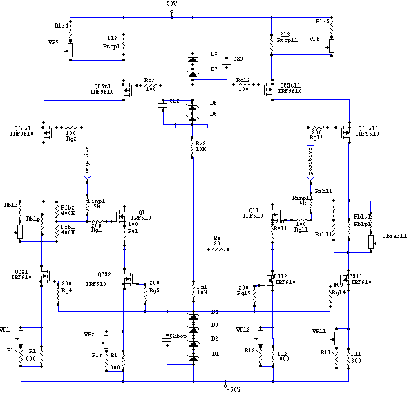

-->I can't read the circuitmaker file
OK, so I am posting a GIF. I thought I had already done this, sorry. Note the voltage setup for bias of power stage (not shown, see postings page 1) are resistive and could be done with Vbe multiplier. It is some time since I looked at the circuit, so you need to verify the component values for whichever current you select. I set up for 30mA in each of the bottom current sources (and thus 60 for the two top ones).
-->Have you asked Nelson about servos? Does he use any? I am sure he must have some tricks up his sleeve to get the circuit to behave without using complicated circuitry, which would spoil the whole fun of having only two gain stages.
I have made macromodels for an op-amp version but have not put it toghether yet. The concept of macromodels (with PCB layout) is great! However, I ended up with revisiting the service manual for Aleph P 1.7 and saw the (same as Aleph) use of a simple bipolar device to sense the current and slave the FET source into compliance. After thinking about it some, I decided it was probably worthwile and better to do this, particularly if some voltage source is added to the Vbe drop which is far too low for my liking. I will make new macromodels etc. to accommodate. I have not asked NP about servos, but it is a natural evolution, particularly if done discreetly to avoid having to mess with biasing or worry about drift with temperature.
Petter
Petter
Just for above design, I wonder there are too many parts should be matched or adjusted. I would think the number of variables should be as minimum as possible.
Q1/Q11 needs to be your best pair.
Bottom 4 current sources can be matched together as a quad
Top 2 current sources can be matched together as a pair

Comments
I see you use MAT02 units at the bottom middle current sources. Those guys will se half the rail voltage (25V or so in this case) and might get hot. The sources of the input pair will always be in the region of zero volts, so it does not matter if you loose more voltage here and thus increase current source compliance while reducing power dissipation. Where you are dropping the most volts are at the top, and I am happy to see that you have compensated for this by adding 10V. If you were going more traditional, you would probably want to add 10V or more at the bottom as well for the outside bottom pair, but as I said, the top is the most critical.
Another trick you can use is to put the PSU caps across rails instead of to ground. You will need higher voltage caps, but you will get much more mileage out of them. As you see, ground is not used at all by the power stage, why reference to it!
It is a matter of taste whether you want to reference the feedback to the output or back up one step.
680R to ground should not be necessary. Also, you might want to consider playing with the 100R bridge between input pair sources since the final gain is limited upwards by the output/input resistors.
Nice work! Let us know how you get on with it.
Petter
Petter
makes me proud
NP´s statement makes me proud!!
BTW the MAT 02 sees about 10 Volts across C-E
About 4 V drop as the sources of the IRF620 are at -4v
another 10V across that 1k resistor (running at 10mA)
another volt across the 100R res.
I´m running it at 40% rated power, you can touch it without
burning your fingers.
You have to carefully select those led´s for about 1,65V at
their current.
Reason for the MAT AND 100R 0.1% (!) is the intrinsic
matching of the 2 devices in one housing.
The combination of 680R and 100R is simply doubled values
from NP´s patent . You can buy a copy from the patentserver
wich is mentioned on Nelsons hp.(3$ per download).
There you can read the reason for that 300R-47R network.
I think you simply need some DC-current path to reference
(ground)
Adjust as follows:
shortcut the gatestoppers of the N and P Powerfets and adjust output to zero with the trimmer in the currentsource in the +v rail.
secondly open the shortcut, let the Fets warm up (1h or so)
readjust DC-offset with trimmers in the gate circuit of outputstage.
You can also swap the ALEPH Current Sink and put in a complementary stage with P-Fets as source followers, but as
the IRFP9140(N) is not really complementary to IRFP240 I´m
not so sure about the behaviour under heavy complex load.
The simple circuit of our genius
indeed works fine either with P or N-MOSFETS
Uli
