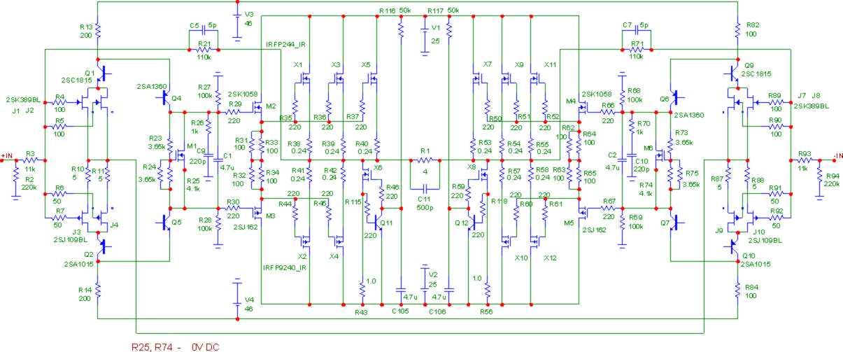

Sorry for my post earlier which was far to skimpy on the technology 🙂
Yes, it is the current sources for the input stage (4 on bottom and 2 on top) that need to "balance" in order for the output of that stage not to go completely bananas. It is not that bad once you have ironed out your design etc, but before that it is painful.
Now that I am at it, I still don't understand why somebody did not just build an X input stage as a ZenX. Using auto-adjust on the current sources and small sense resistors, it should be very easy, and you share the heat over a lot more transistors than for the original Zen. In effect, what one should consider would be a power version of the input stage of the X.
Petter
Petter

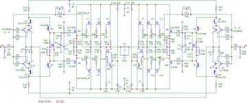

sorry, R25/74 for bias, DC 0V by adjusting potential of Bases Q5(4) and Q7(6). Biasing of CB Bases is the part I don't know how exactly to do. By the sim there is needed around 100pF to put on each to GND, for stability issues. Can they have bad influence on sound ?
