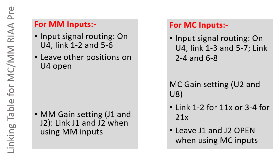

Does the MC amp output around U3 goes to U5 RIAA equalization and further to output J5? I think this happens through jumpers settings a U4.
Is there a jumper map for U4 available?
Sorry for the silly questions. Phono is a new thing for me I am just trying to understand.

U4 uses 4 jumpers to send the input signal to the MC pre and then to the MM stage or just to the MM stage like this:-
X-Altra Mini II document updated with DC test voltages and jumper settings for the MC/MM amp https://hifisonix.com/wordpress/wp-...ra-Mini-II-Preamplifier-Main-Presentation.pdf
