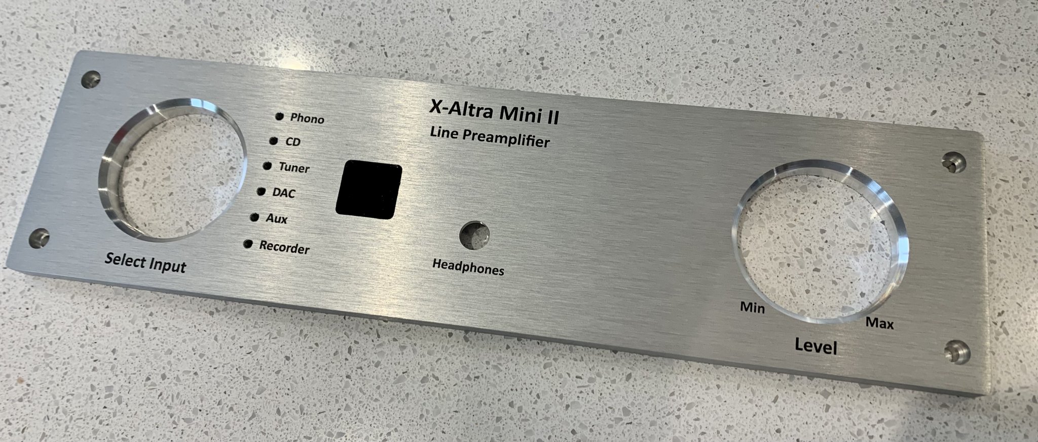

New front plate with the IR window for the remote control upgrade for the X-Altra Mini II arrived today. Assembly and testing over the next few days!
The X-Altra Mini II Apple TV remote controller is now working and debugged. I have a few more tests to do a bit later today, after which I will post up a short video. very nice to sit in my 'listening chair' and use a remote!

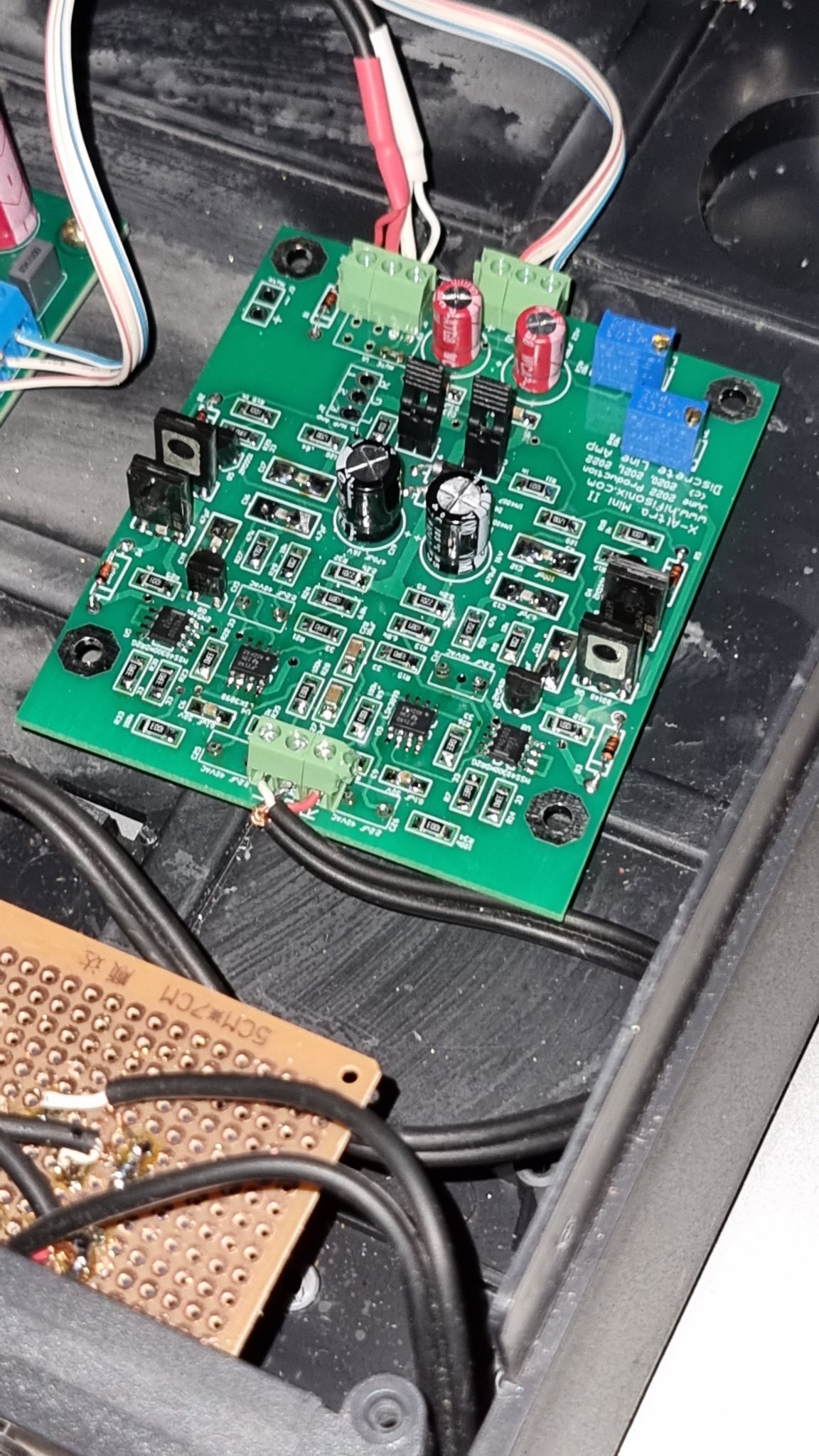

I was going to use my power supply / headphone amp I built last year; I was never able to get the power supply to output 18V all I could get was about 17.5.V. I see you changed the design a little, I did get the new power supply board think the 1/2V is worth building up the new board?
Bill
Bill
Bill, some folks had this issue. You have to select some resistors. The new board uses pots so it’s very easy to adjust.
Gorgeous!

For soldering with the hot air gun putting the vias on the components pad make it difficult and I had to revert to the trusty iron method. Mouser was out of bd139s when I ordered my parts. Purchased a batch of bd139/140 does it help to match these?
