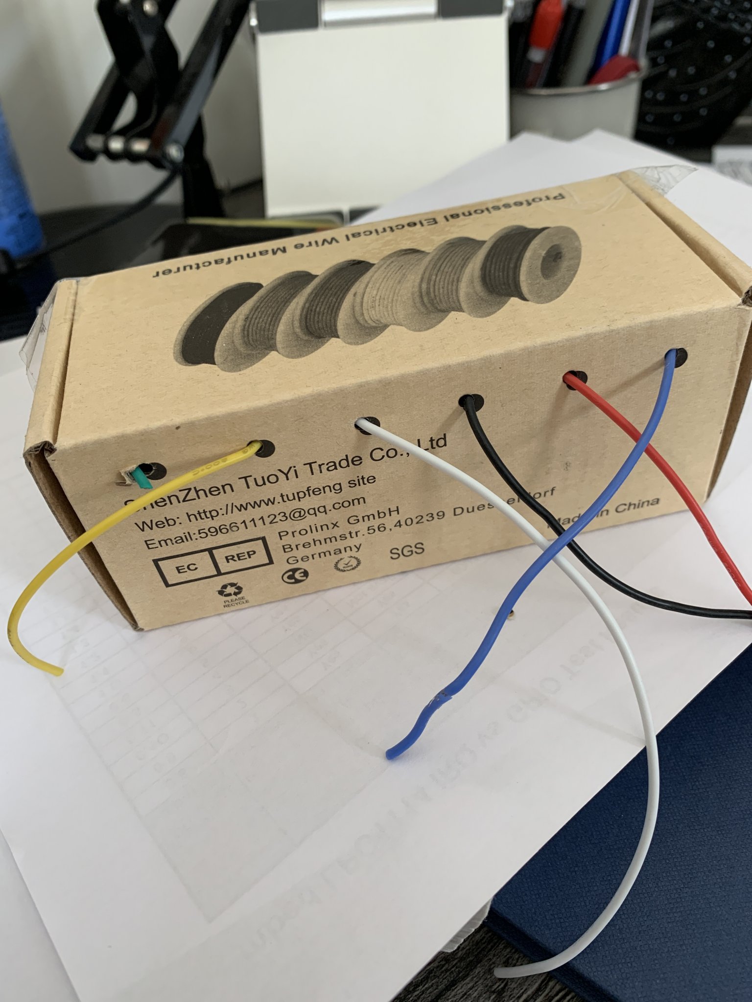

Hi Bonsai,
Very nice preamp. I was wondering what type of board to board wire interconnect are being used? Is direct soldering preferable in this particular setup?
Best Regards
Farooq
Best Regards
Farooq
Hello Farooq, I’m using 20 AWG silicone insulated wire I got off Amazon. Very nice to work with.Hi Bonsai,
Best Regards
Farooq
For signal interconnects, I’m using single and twin core 3mm diameter screened cable from RS Components.
