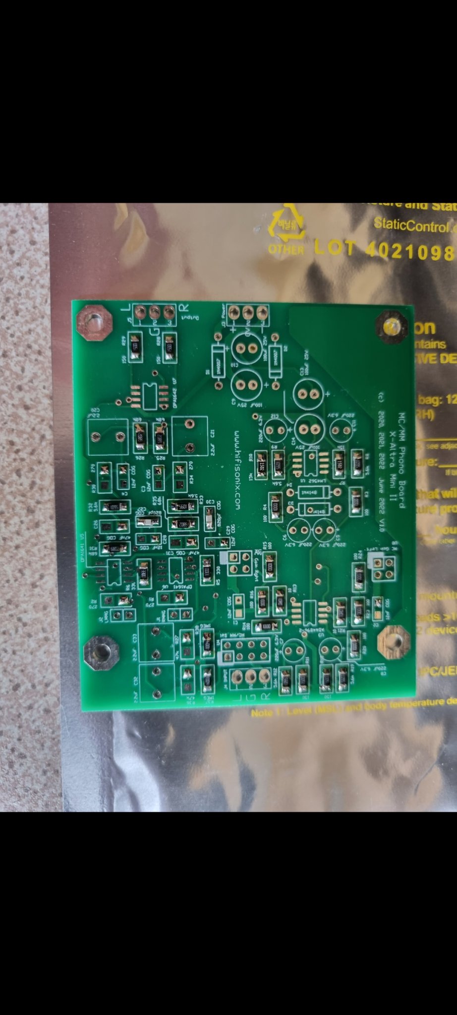

Hi Andrew, in the Phono board R1,2,30,34 are marked 270r on the board but on the Bom are marked up as 150r, which one I'd correct?

Some more differences between Bom and board for for phono, C15,16,17 on the board printed as 1uf listed in the Bom as 1uf part number links to C0402C101J5RACTU which is a 100pf x7r 0402 footprint, which part is correct?

1. HPA-1 Headphone amp - R14 and R23 must be 470 Ohms as in the schematic and on the silkscreen; PCB and schematic are indeed 1N4148
2. MC/MM module - R1,2,30,34 are 270 Ohms. I will update the schematic and BOM; C15,16 and 17 must be 1uF devices 0805 same as C22 and C23 Mouser 187-CL21B105KBFNNNG or equivalent

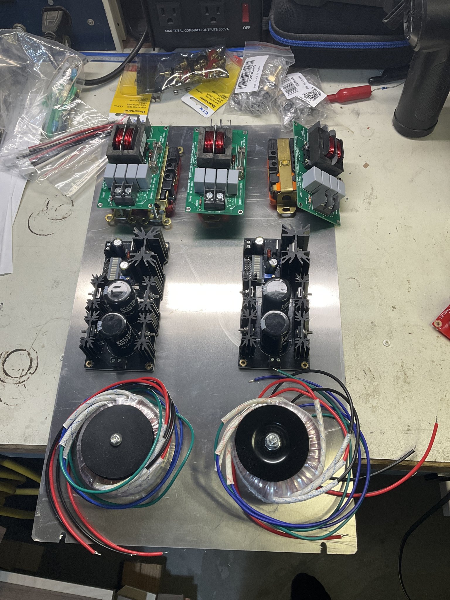

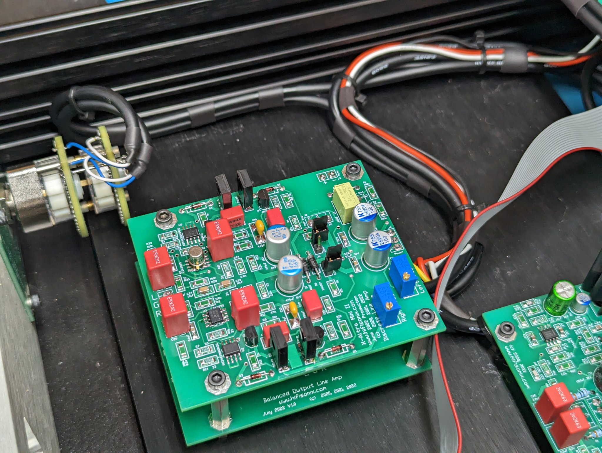

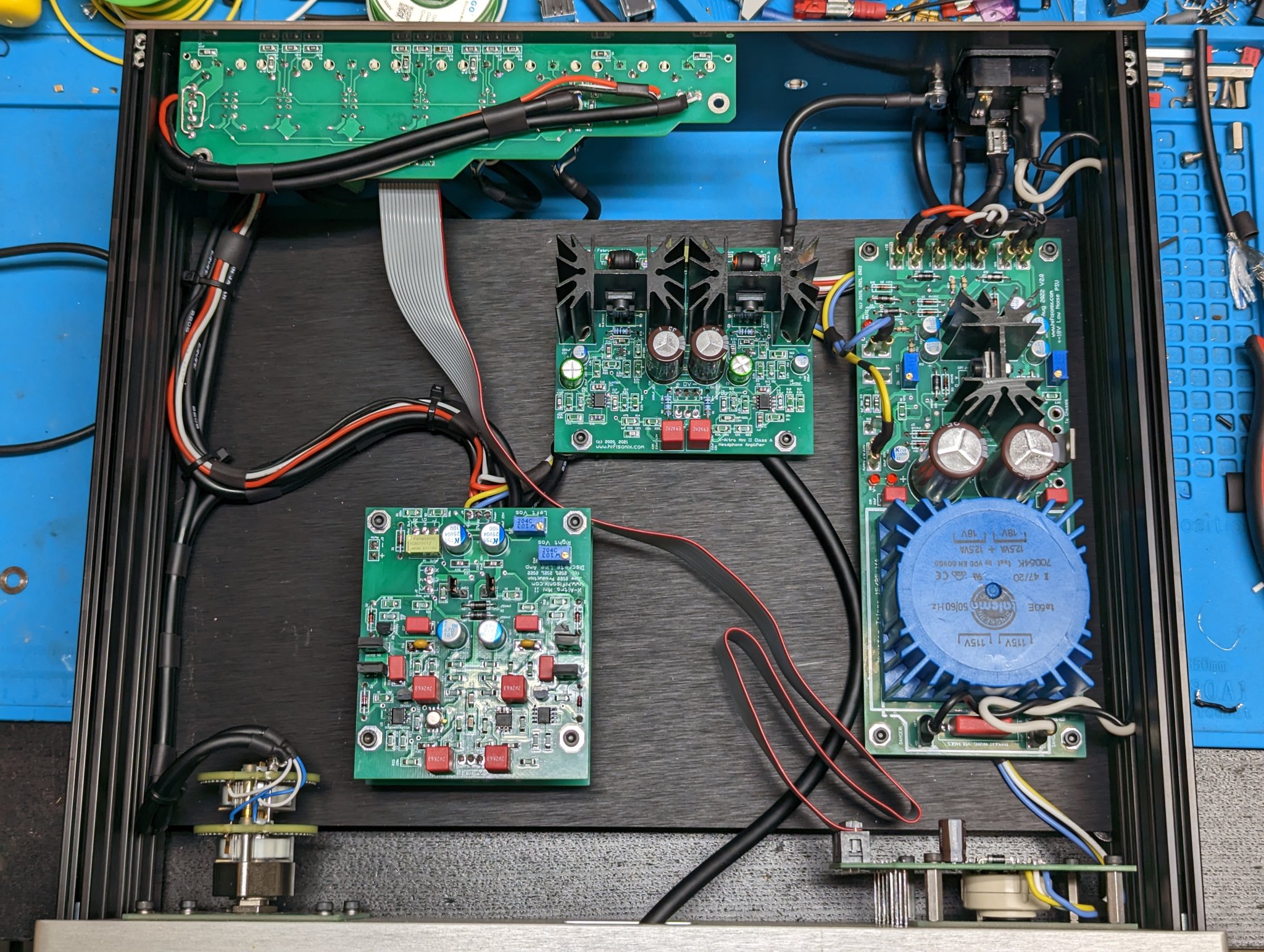

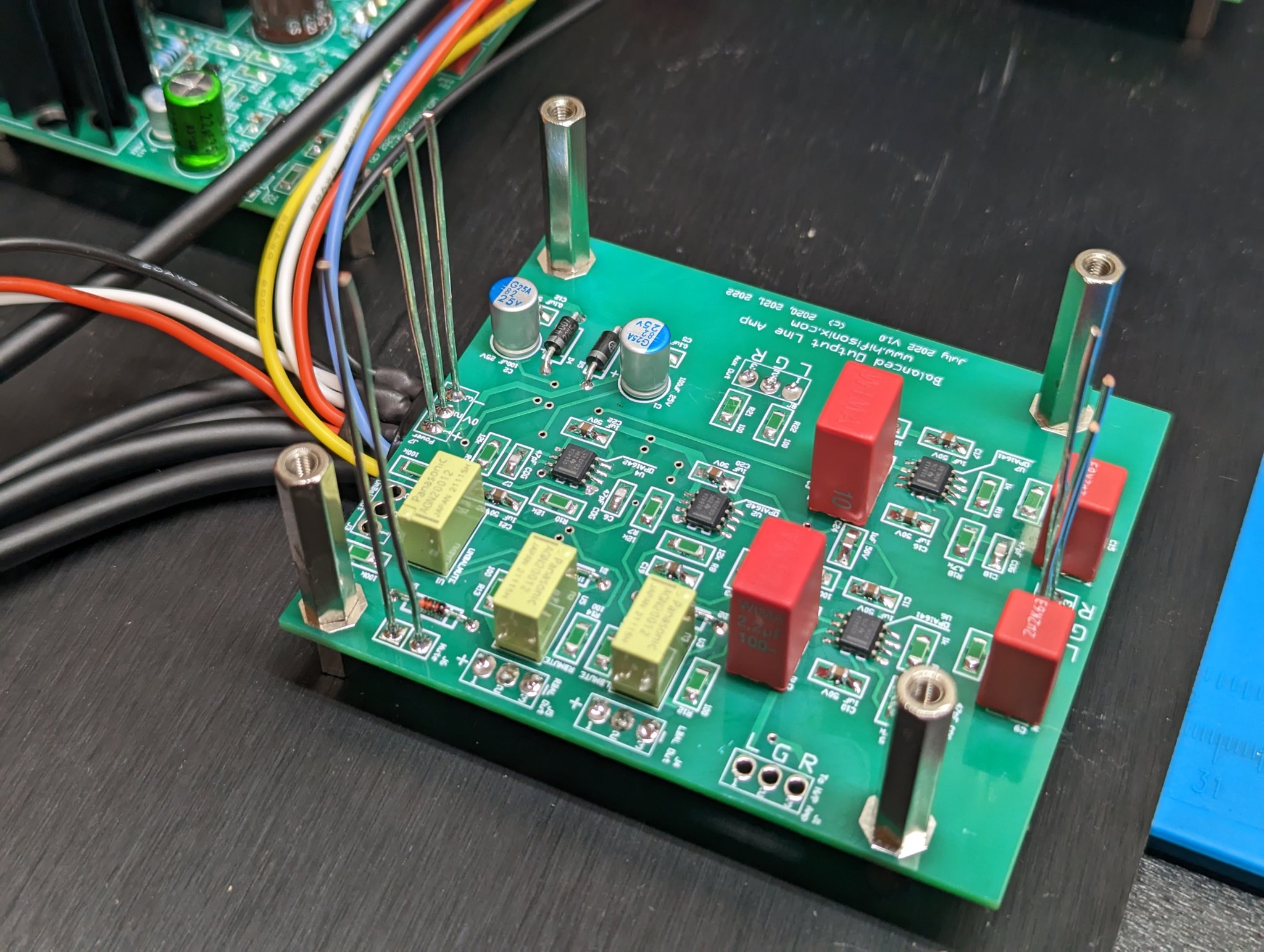

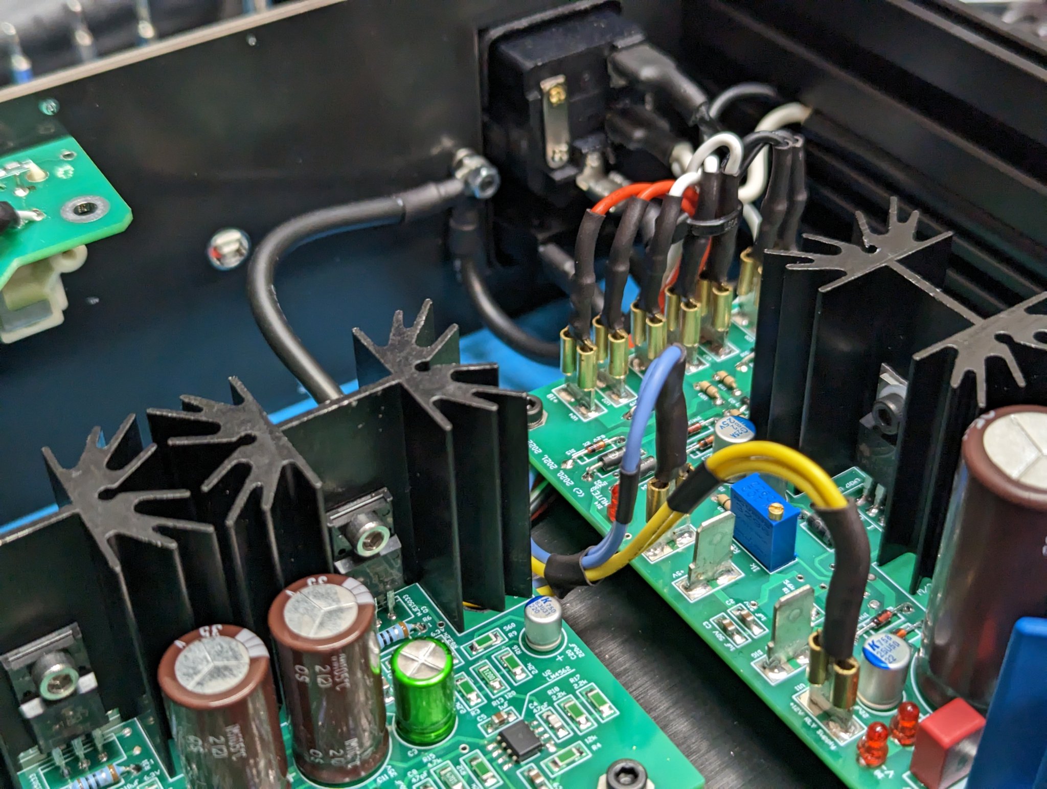

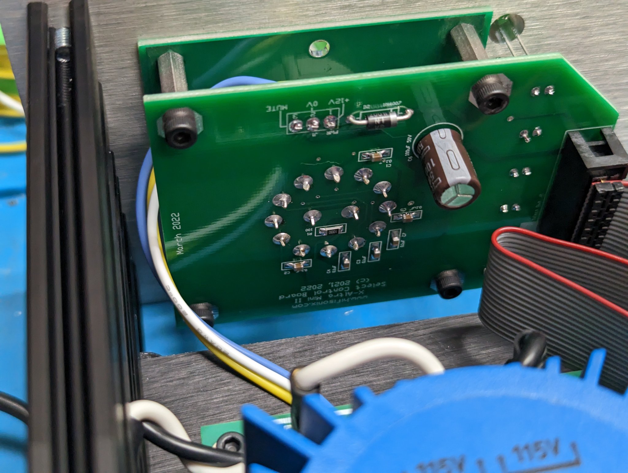

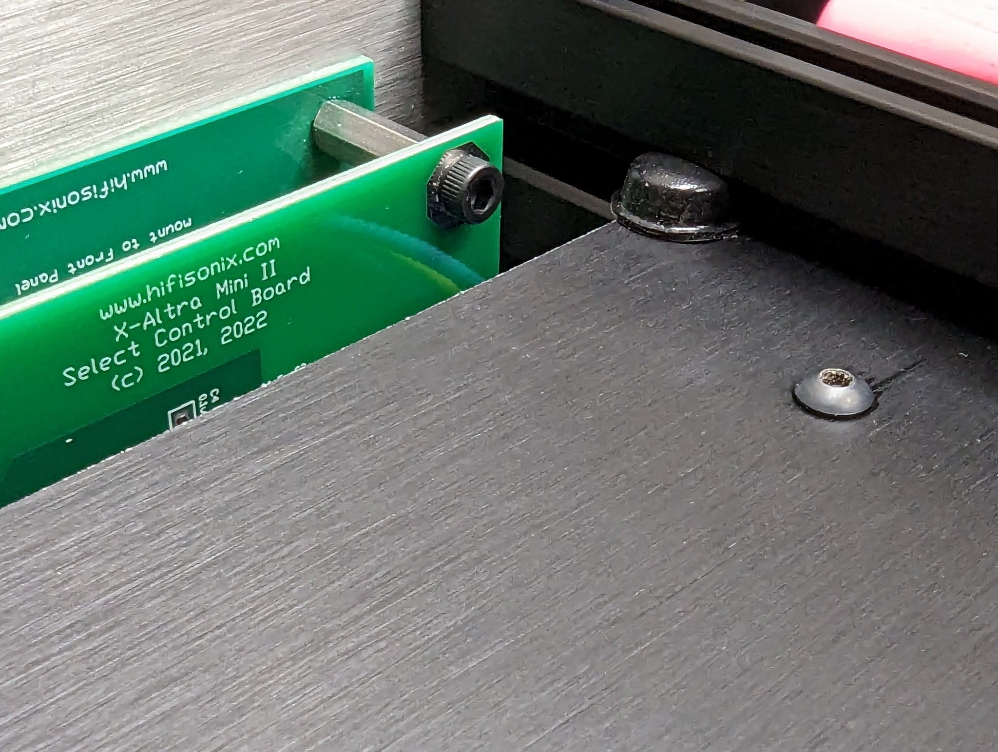

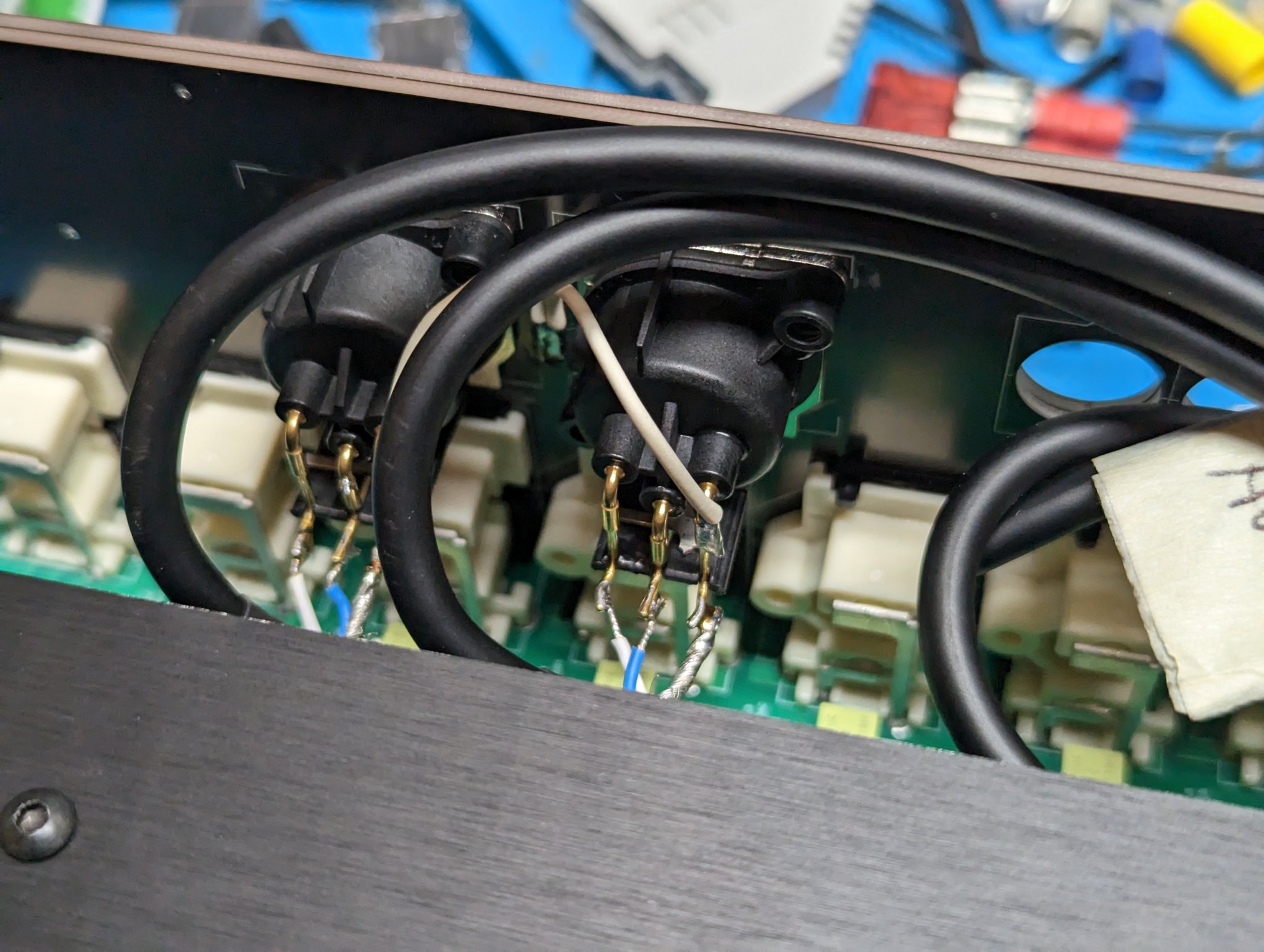

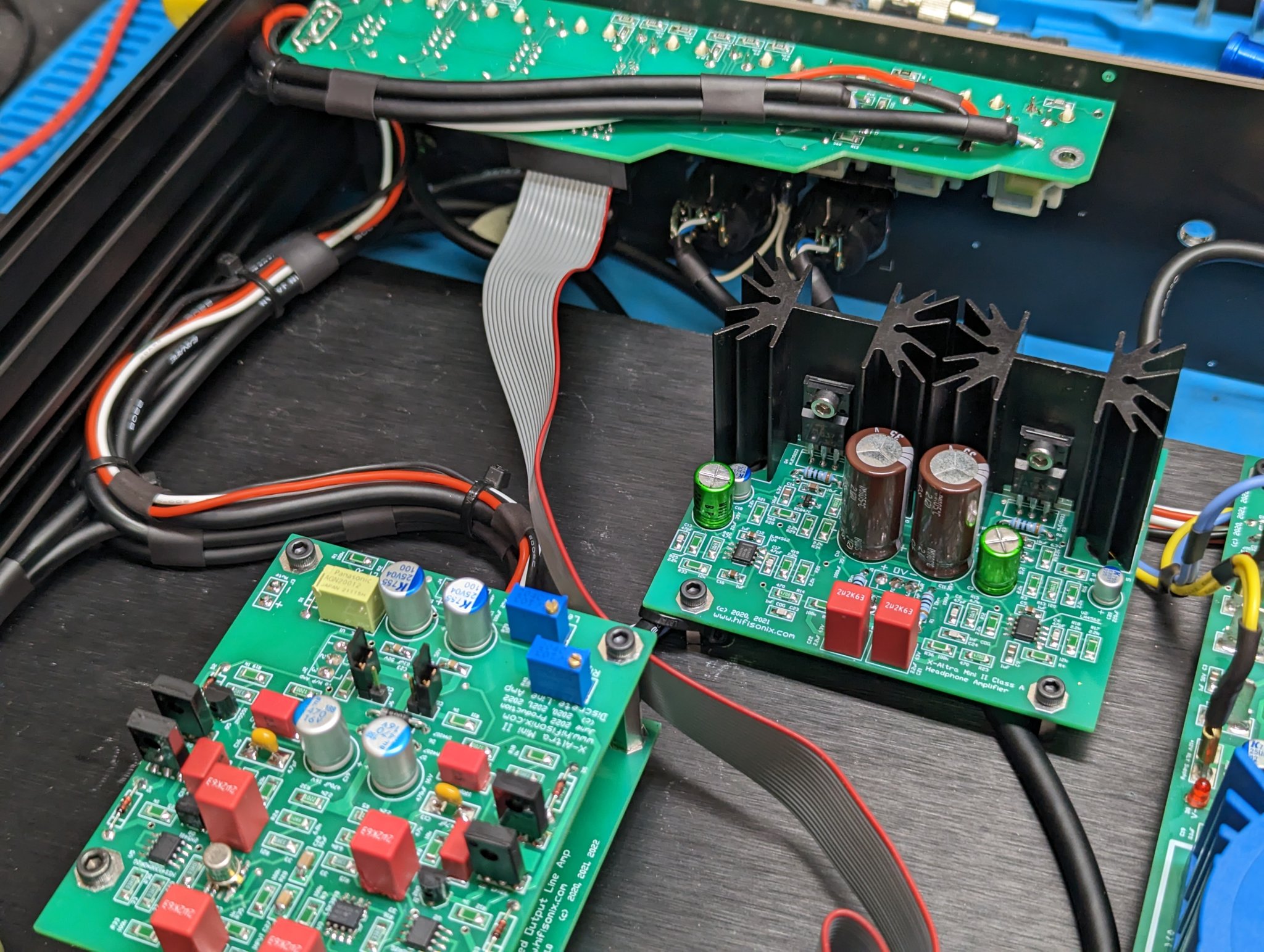

Just working on wiring this all up, I have a question on the headphone board. Both the discrete line amp and Balanced boards have outputs for the headphone board, which one to use? To me the discrete line amp should be better, but I just want to confirm.
Andy, I've put output connection points on both boards for flexibility - some folks will not build the discrete board and others will only want the balanced board. The discrete board will drive the headphone amp no problem with low distortion so that will work very well.

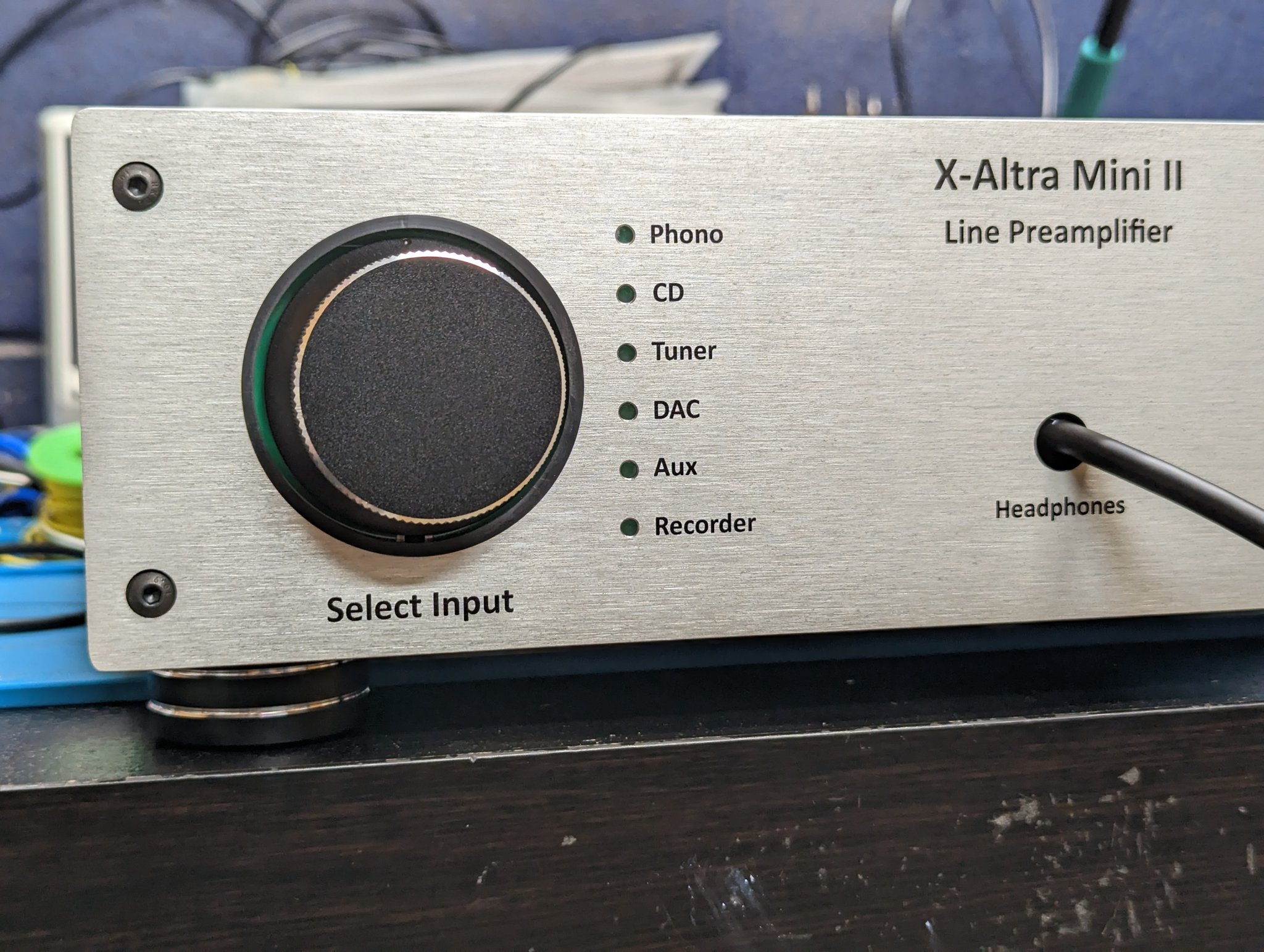

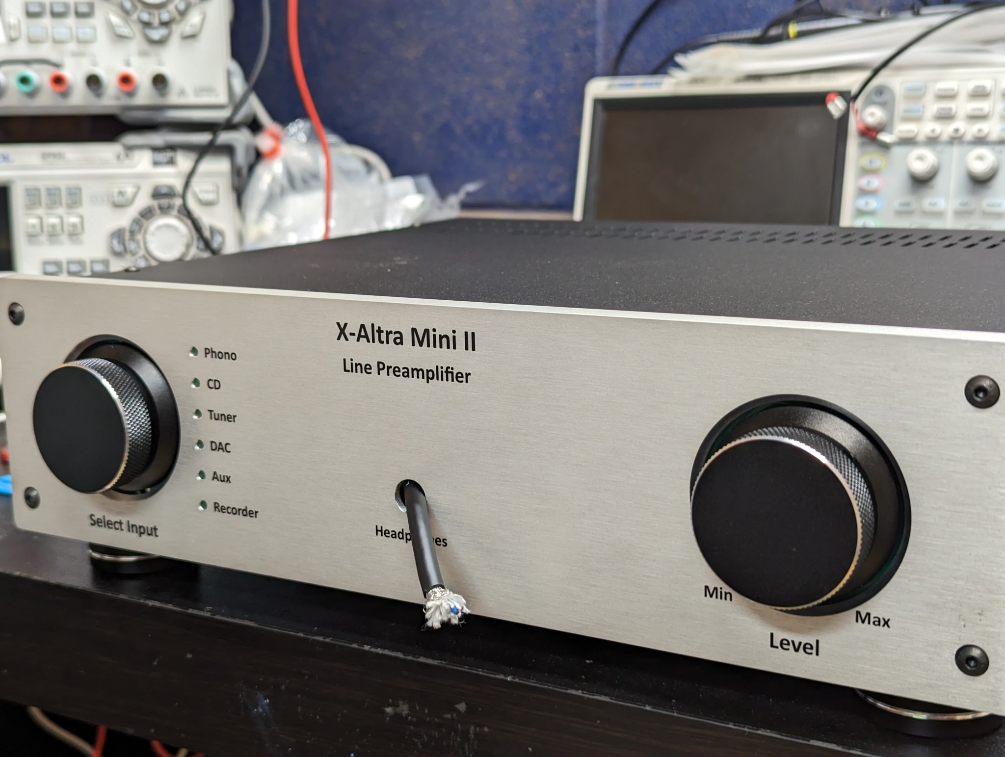

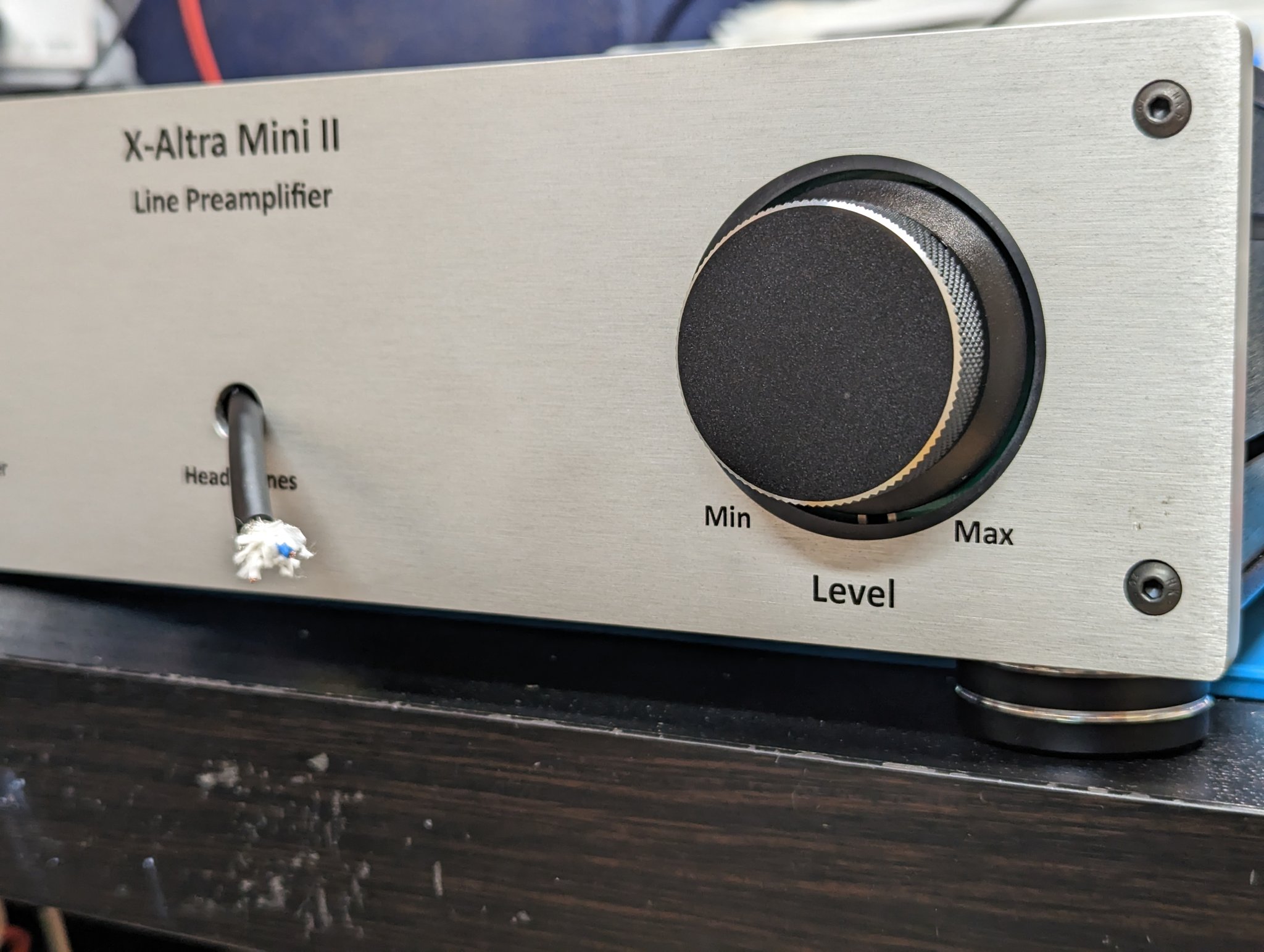

Misson (almost) accomplished 🔥 . Just waiting on the extra RCA jacks for the AUX and the headphone socket board to arrive. Wow it turned out amazing is all I can say right now. This project was not a small undertaking by any means, but the final outcome makes the last couple days of wiring worthwhile. I ran into a few hiccups here and there, but is to be expected with any project that has this many parts.
Thanks @Bonsai for another great project!! I can't wait to get my Phone preamps hooked up to this and get it all in my system. 😀
