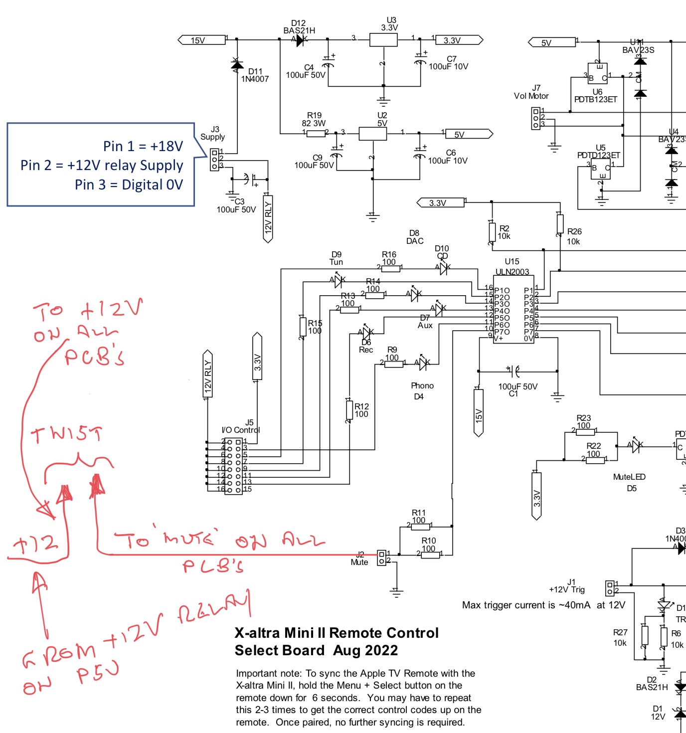

Bill, here is how to wire the mute relays with the Remote Controller Board (RCB)
1. Run the =12V relay from the PSU together with the ‘MUTE’ output from the RCB.
2. The +12V drops off to each +12 V relay supply on each board
3. The ‘MUTE’ drops off onto the adjacent mute control pin
(on a future iteration of the RCB I will connect pin 2 of J2 to pin 2 of J3 make wiring up the mute control easier)
Ok that makes sense, I kind of thought was what was going on but after toasting one board I would ask first. Any particular routing for this cable, I would think it is not much of a noice generator.
That’s correct - just twist the +12V and the Mute line together from each board to the next. The only possible noise would be ‘clicks’ as the relays switch from the fast rise fall times coupling into the amplifier boards but I tested for that and it’s silent.

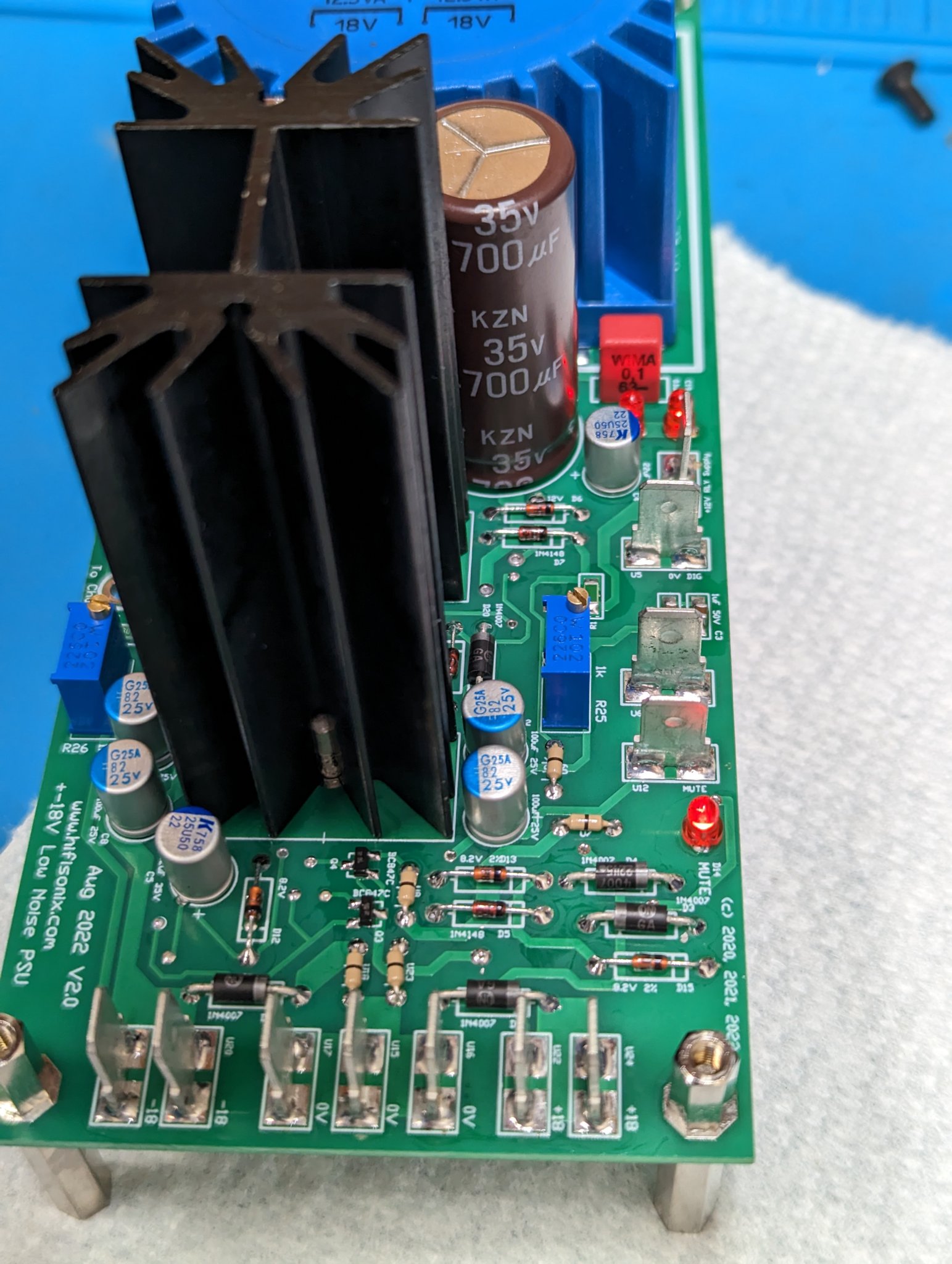

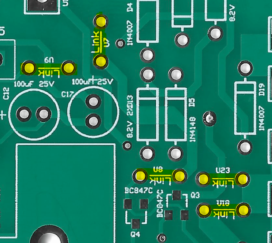

PSU board Done, works like a charm. I went ahead and linked them. One thing i did notice is there are no polarity markings for the LEDs on the silk.
Andy, they must be linked as you have done. I did this to make sure the + and - supplies were completely separately regulated before combining them.
LED silkscreen - apologies for that. Seems the polarity is obscured during the board manufacture. I’ll have to update future boards.

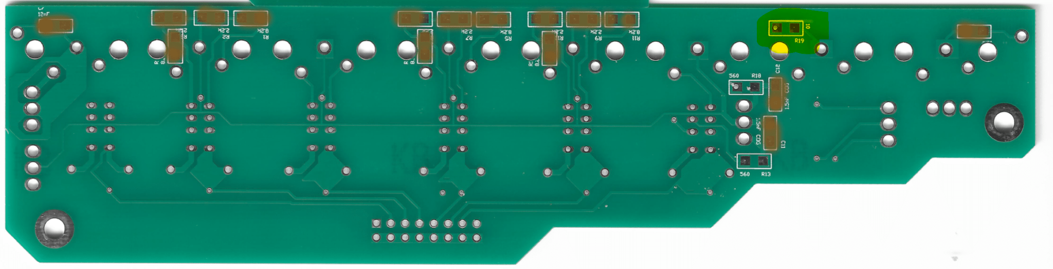

There is a lot of the silk screen cut off on the relay board too, also R19 is not on the BOM.
