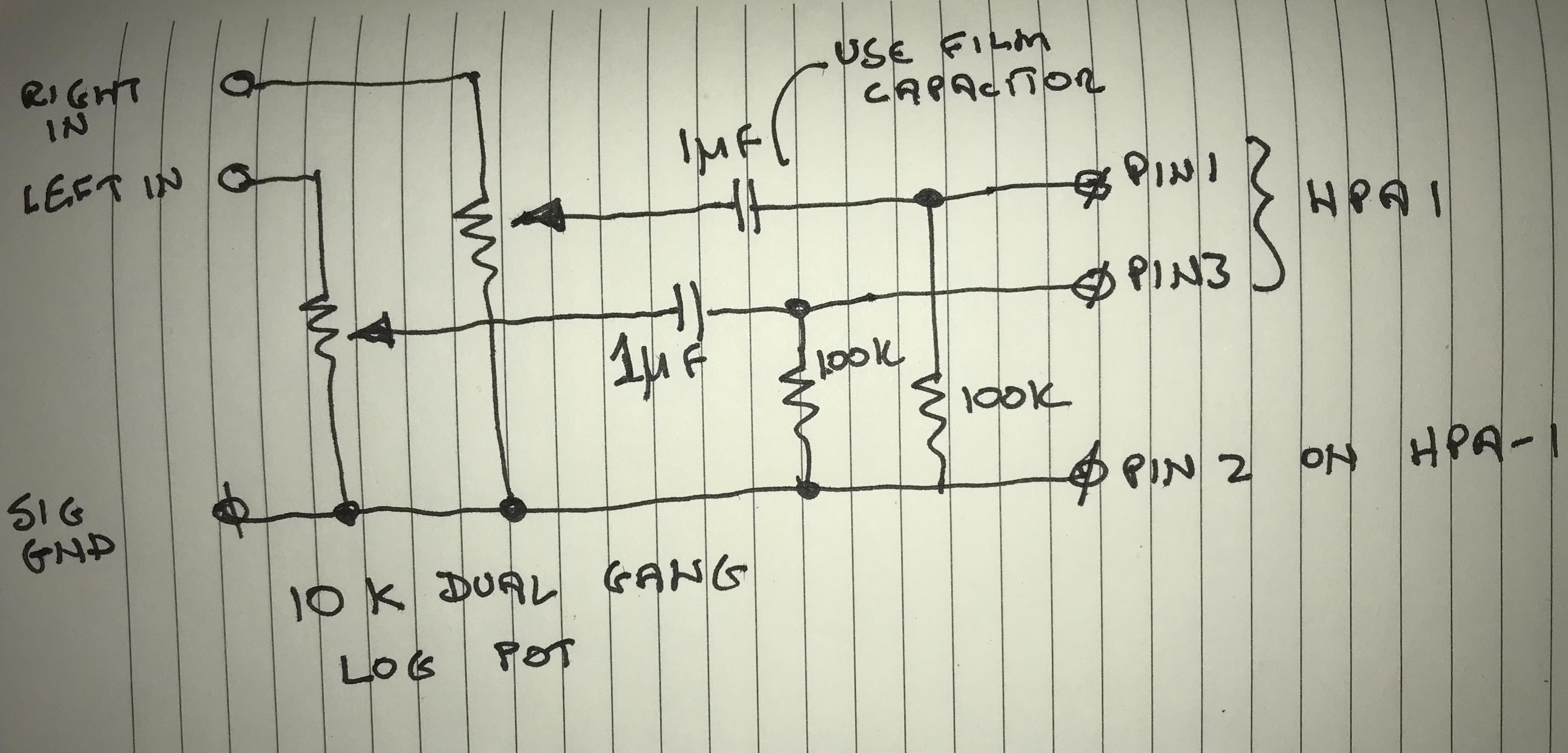

Is it possible to add a volume control? Can I use the HP-out and add a log. potentiometer?

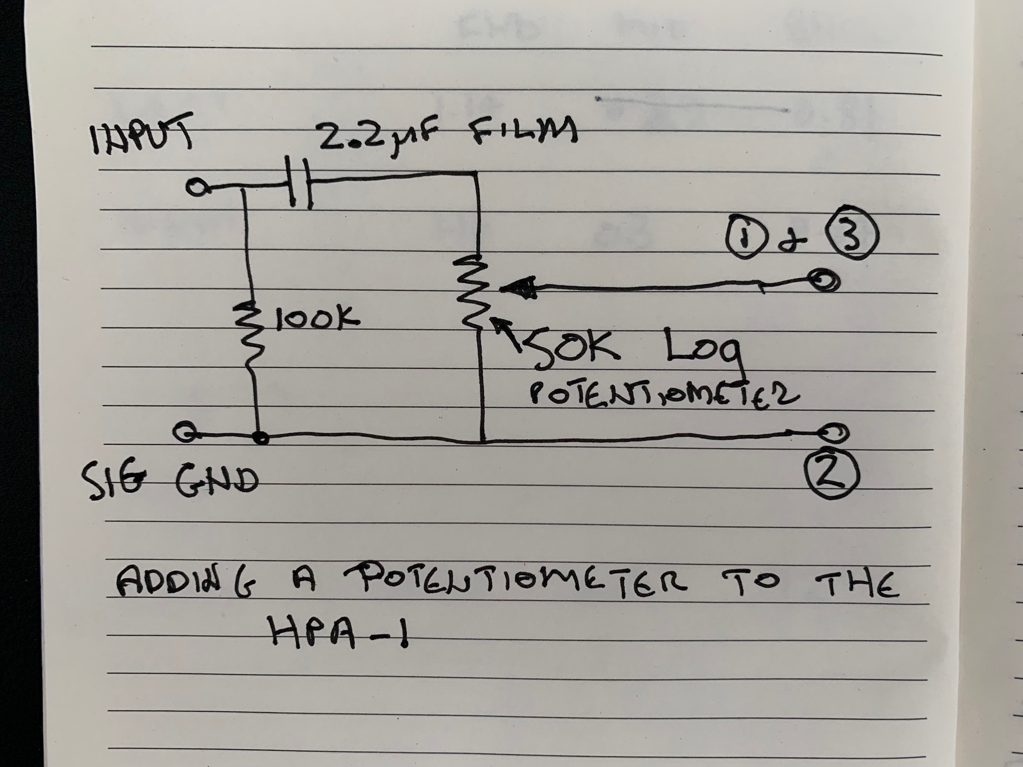

Andrew, if we opted for a jfet based opamp, am I mistaken if I say the DC blocking cap isn't needed?
Here is a better way to connect a lot. This blocks the input opamp bias current from flowing through the pot, which will become noisy after a while. JFET opamps generally don’t have this issue on low value pots of say up to 10 or 20 k Ohms. But with an NE5532A, (which the HPA-1 has been tested with) it will, and even using an LM4562 might cause pot scratching noise.
With the approach shown below you can use a good quality film coupling cap of 1 uF.
Note that the 100 k resistors will load the potentiometer, so you should use a value of 10 k for the pot or lower. Most preamplifiers will have no problem driving a load of greater than 2 k so you should be good to go.
