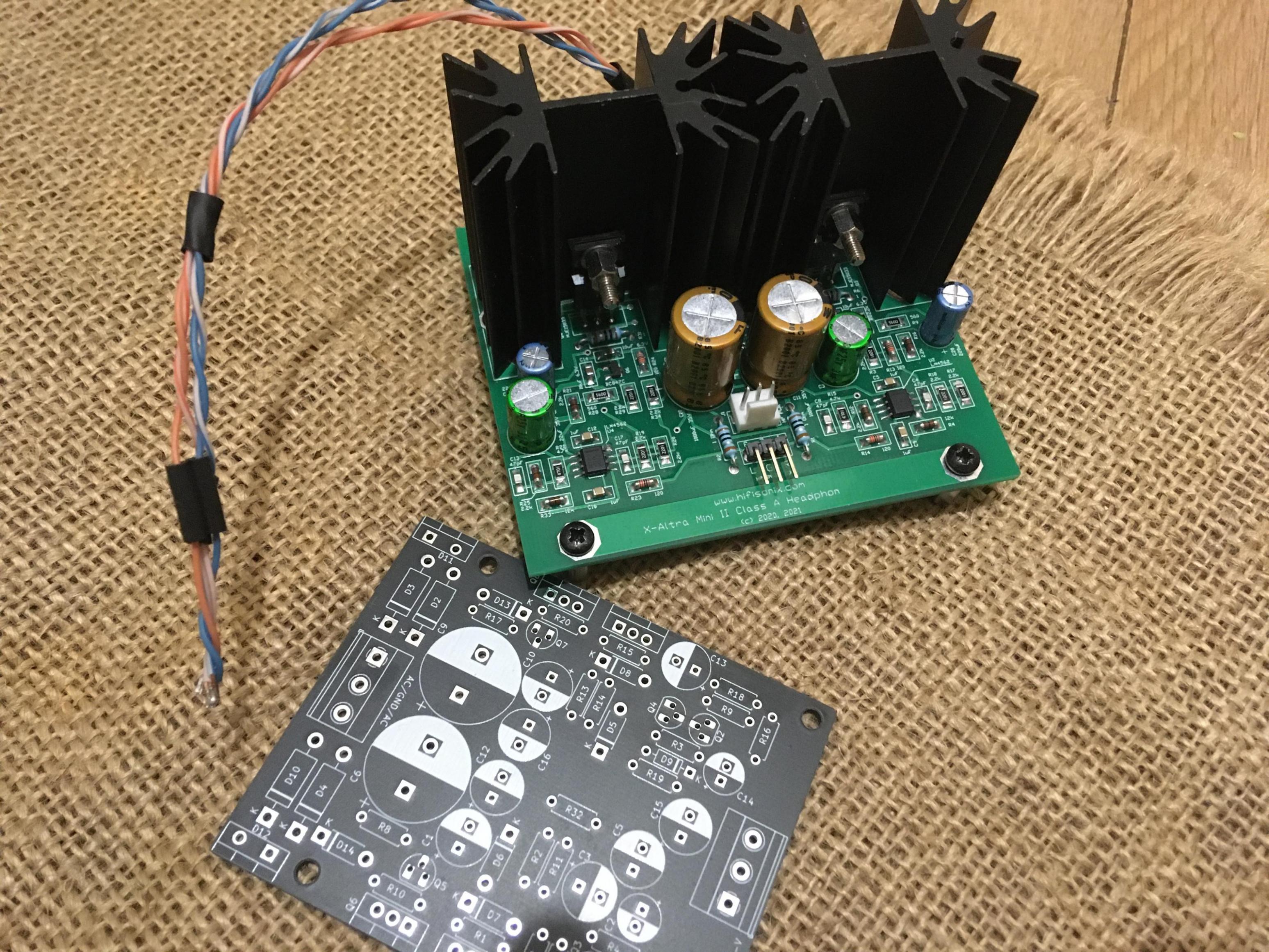

I had company this weekend, but the next steps are to head to the garage and start drilling and filing aluminum. I see I could have done slightly better with psu board layout to make my life easier, but it will all be good.
I want to add some feature to this amp, like symmetric inputs (through a balanced line receiver). So I plan to build my own board, is this allowed?
First I have to redraw the circuit, then add the additional features. I can provide the resulting schematics and board details, if it's finished.
Maybe someone can have a look, if I made some mistake(s) during redrawing?

I haven't looked at it in detail, but it seems you are using EasyEDA. You might want to select a different OpAmp with identical pinout and footprint from the parts library, one that comes with the nice schematic symbols we all know for OpAmps (instead of these ugly boxes with 8 pins). You can search for OPA1642, that should give you the correct footprint with nice schematic symbols. The resulting schematic will be more structured and easier to check for mistakes. You can change the name to whatever you want after you placed the symbols.
