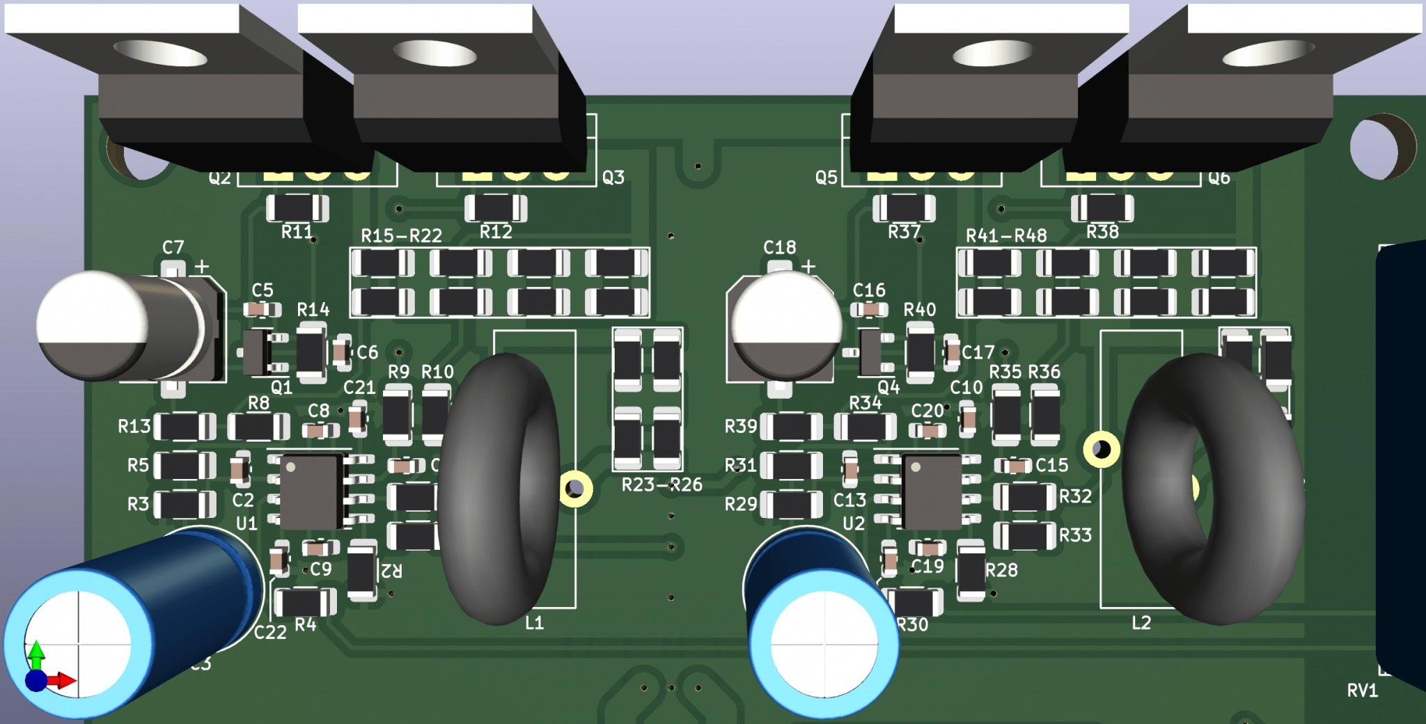

Having difficulty finding a part with a large enough inductance...my design (yes, I'm finally getting to it ahah) doesn't have a THT output resistor to wind a coil around 😀 I can put two in series though
Andrew and Bucket,
Why not wrap your own inductor around the body of a #2 pencil? Or the barrel of a pen? Then use a quick swipe of hot melt glue on the side of the inductor facing the PCB to keep it's shape while handling. Or am I completely missing something??
I figured it out - will be using a 3D printed plastic toroid core, hand-winding it and mounting it vertically 🙂

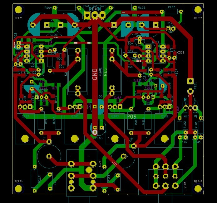

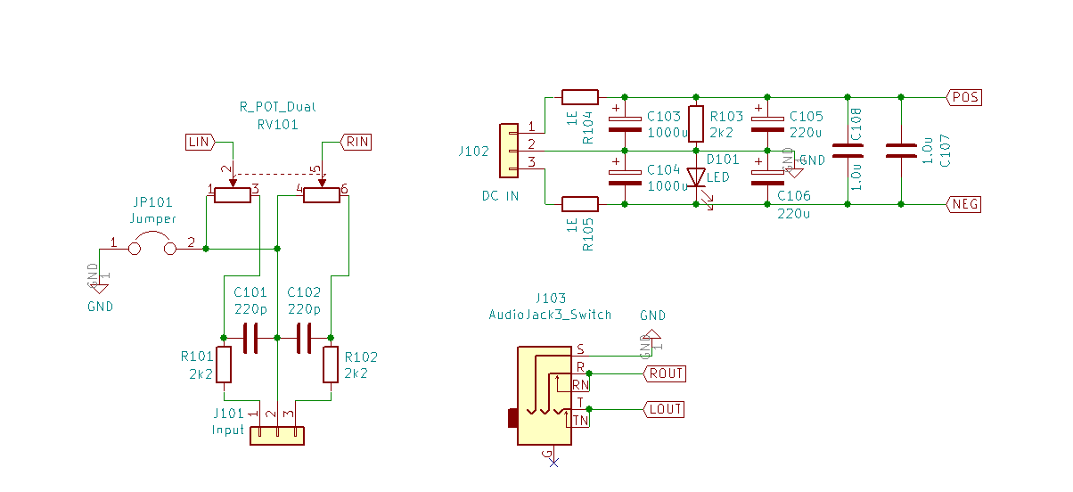

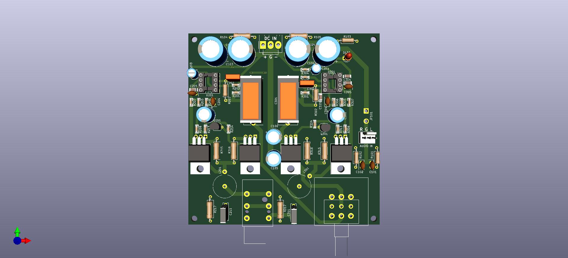

I will try my version, including volume pot and output socket into PCB. I put filter at the input before volume pot, not sure if it's a good idea. Any suggestion is very much appreciated.
You have a big loop area between your power ground and the input signal ground. Run the input signal ground round towards the front and then down the middle of the board to the power connector 0V and connect it star-ground. Keep the signal ground and the power ground as close as possible to each other until you join them back at the main incoming power ground.
Each transistor will dissipate about 1.5W on +-15V rails, so my suggestion is that you put the transistors under the board with the leads bent upwards so they are pressing on a heatsink, or, you bolt them to the bottom plate of the amp assuming the chassis is aluminium 3mm thick minimum.
I can't see where C214/215 are, but they must be as close to the opamps as possible - especially if you are using the LM4562 which have c. 55MHz GBW.
Note, I also built and measured this with the OPA1642 - I think its a bit better sounding with that opamp, but to be honest the measurements were almost exactly the same as the LM4562. Make sure you can get the opamps you are going to use in the DIP8 package otherwise its mostly SO8 nowadays.
Otherwise, layout looks good - nice and compact!
