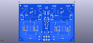

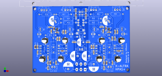

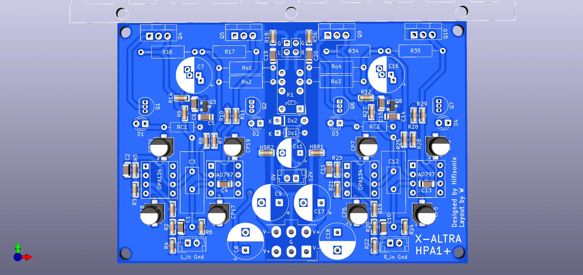

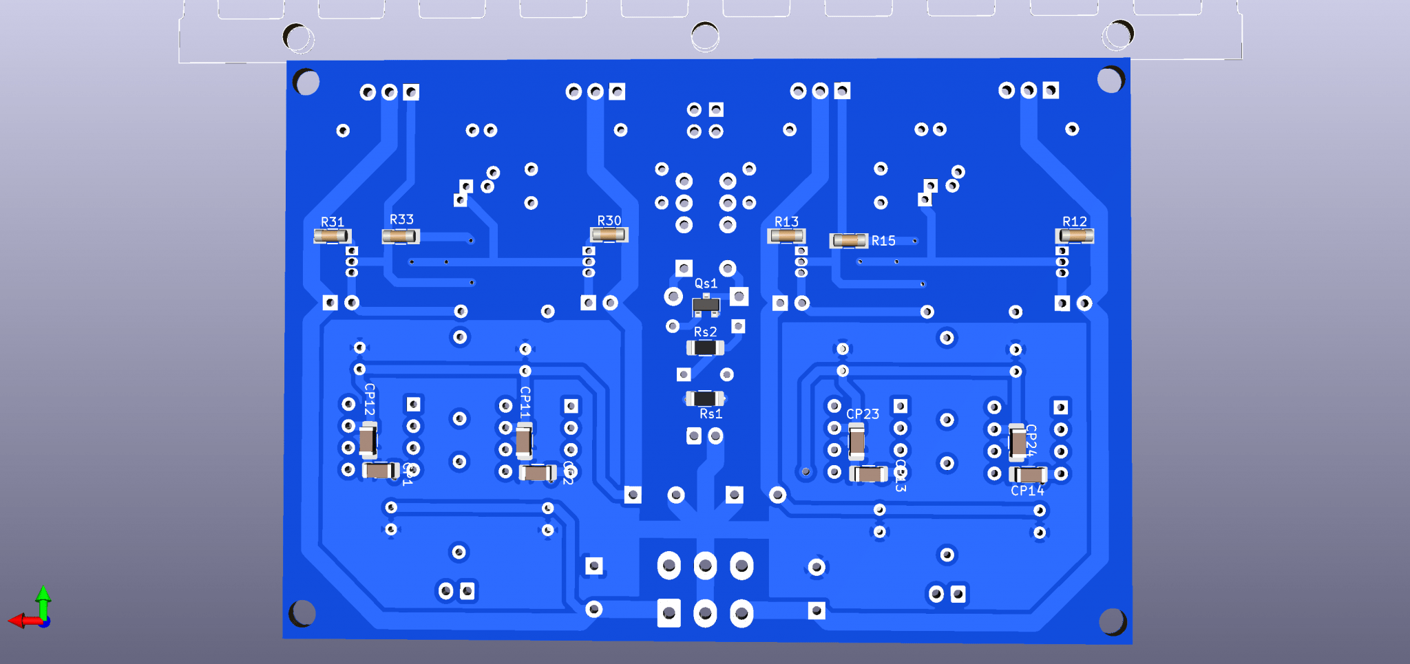

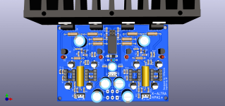

Hi Andrew, I made a layout of the X-Altra HPA-1.
I added a CCS like the original HPA-1, with a red LED and A970/C2240 pair. The coupling cap from U1 to U2 changed to 1uF MKT with 100K. And supply voltage to +/-15V.
It'd be great if you can put some comments in.

wolkegeist,
apologies for the late reply. The constant current sources are very high in your implementation at >25mA. The opamps have to source current into and out of this and I think you will get quite high distortion as a result. I'm using c. 3mA standing current (4.7k on 15V rails) in my current implementation.
For the Zobel, you should take this from the junction of 1 Ohm resistors and not after the output series resistor. I would use 0.1uF (use film or NP0/COG - do not use X7R type devices) and 33 Ohms. The output series resistor is 3.3 Ohms in my implementation. You will need to check the stability with a capacitive load of 500pF to 1nF - you may need to increase the resistor value if the output rings excessively.
I would put a diode across Rs2 in the switch on delay driver for the relay - anode on the cap side, cathode to the supply rail. This will help discharge C51 quickly so if you turn it back on straight after turning it off, you will still get a delay.

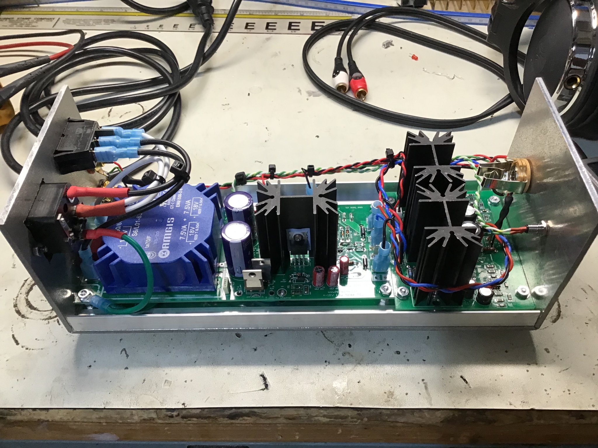

Andrew,
I am casing my unit up will post picture when complete.One issue on the bench when I am using a portable player as a source I get a hum when paused and between tracks. I am hoping it will go away when introduced to my main system in the living room due everything grounded to the same point, but is there a way to prevent hum from the potable devices?

Hello Bill,
you may be picking up noise via the connection between the portable player and the HPA-1.
If you hold the player, does the noise change? does the noise change if you move the interconnect around? If you move the HPA-1 around, does the noise change?
What power supply are you using?

Sorry for long reply, actually it hums with no input. I’m checked the input rca and the ground has continuity to case unsoldered them and still has continuity from the ground to case. Tight fit edge of boards contacting case, could that be issue?
Well when I moved the input wire around hum would come and go so I replaced it with a piece of shielded cable. Now I hear just the faintest hum. The portable players - tried 2 when you stop the music it likes to hum, but when I tried my roon endpoint it works fine so it must be something about the portable players. I still would like to get rid of the faint hum, could be the open cabinet picking up something from the lights in the garage.
The headphone socket must be completely isolated from the chassis so the headphone signal return must only go through the amplifier boards and no other route. It looks like you might be getting a loop through the chassis because the type of socket you are using has the ring in contact with the metalwork. Unscrew the socket so it’s floating and then try again - let me know what you get.

funny, I had a nice isolated locking plug set aside for it and misplaced it and used that one. Thought it would make a difference but it didn’t. I figured out the small residual hum is the inputs being so close to the transformer. I was able to route the wire a little better but I would have to remake the case to get rid of it. For some reason Digikey has no stock on talema but has amigas, they may not be a quite.
Is your socket proper completely isolated from the chassis? Also, make sure when you plug your headphones in, the plug rim is not shorting to the chassis.
I’ll have to add a note about that in the build doc. (Applies to any HP amp BTW). A good brand is Neutrik with the nylon nut - the whole thing is insulated. If you use the chrome nut version, make sure when you plug your phones in the Jack ring rim does not short to the chassis through the nut.
