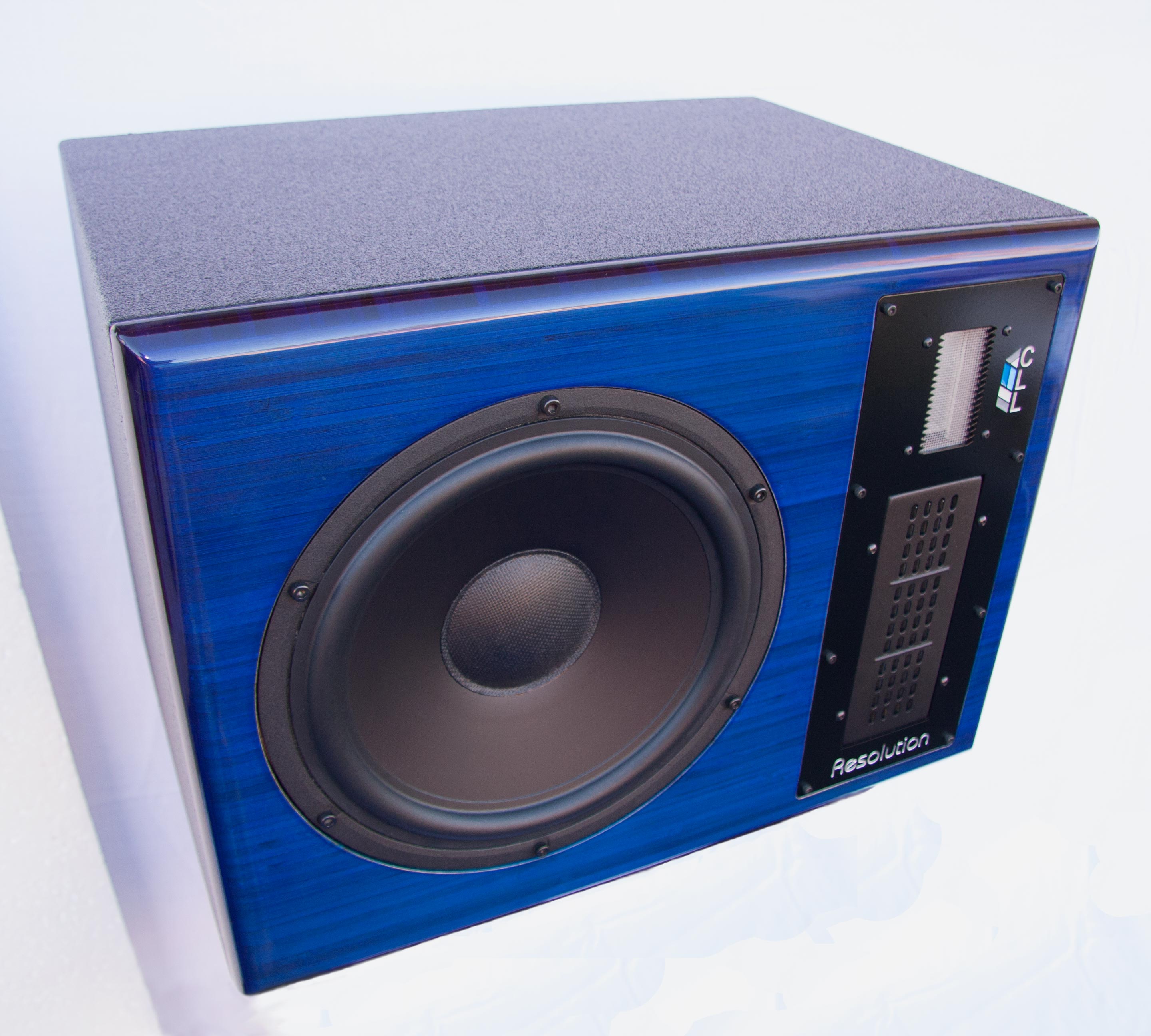

Hello Studiotech,
Still think that your speaker with Raal and ScanSpeak mid-woof was a good design 🙂
Did you find the attenuation needed for the Raal to match the ScansPeak weaked the Raal? Or did it keep all its sounding qualiies despite the resistor in serie ? (I don' rember if you use active or passive!)

Attenuation was not a big deal since three way active with DSP from the Digmoda plate amps. Don't forget there was a BG Neo8-S in between the Raal and scan speak.
Greg

Yes, this is it, I remember now !
Not an easy design : making a Neo 8s with a flat curve between the two others drivers (very different sensivity between the three drivers)! GG ! 70-20 iirc !
