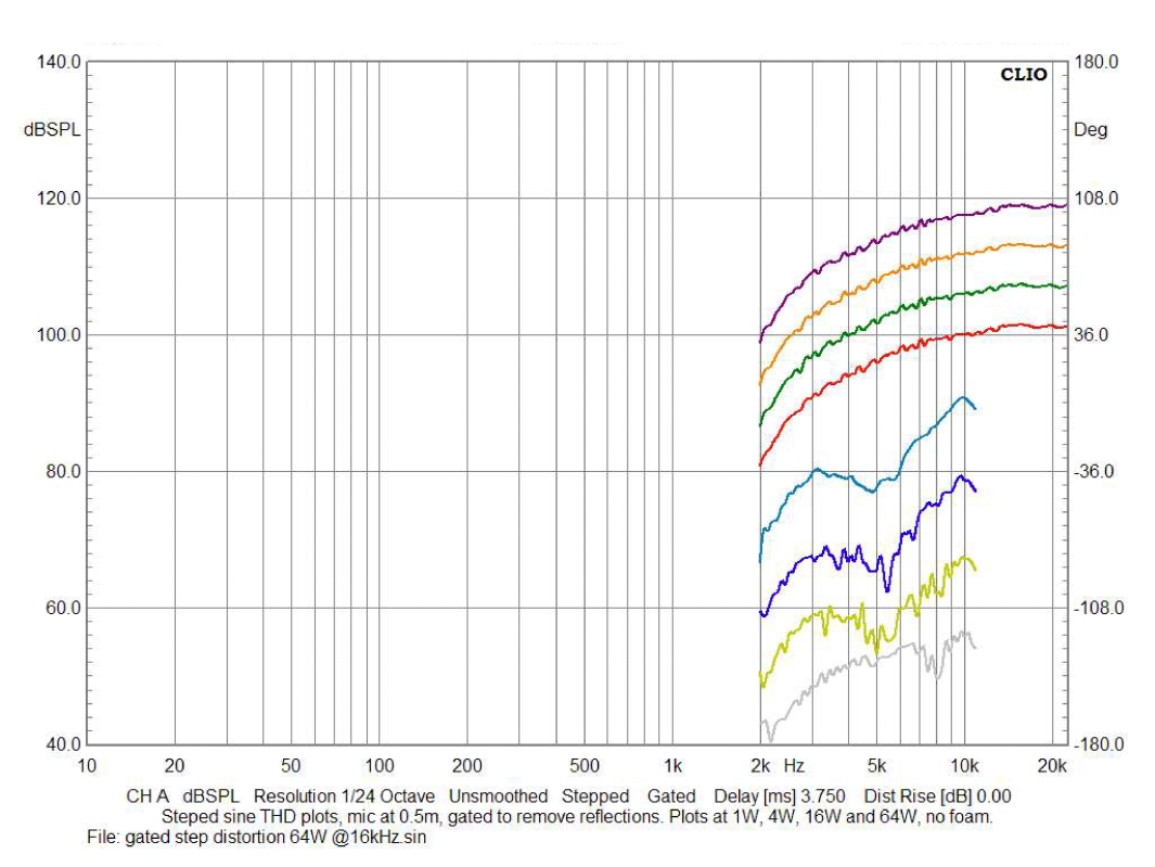

Here is the THD vs. SPL of RAAL 140-15D, without foam pads, crossed with 4th order at 2k5:
Note the THD spectrum and amount vs. SPL. That's the point when we talk audible distortion, not whether we're having -40, -50 at 85-90dB SPL.
So, a full picture can be grasped from (CSD x (THD vs SPL)) and distortion in speakers takes a whole different meaning and interpretation.
Discussions of it becomes pointless with looking only at data fragment gotten by measuring methods borrowed from electronics.

Nice posts!
I have to agree that for my own aesthetics, lack of stored energy is a bigger deal than a flat or smooth frequency response, and the way I normally look for this is at the high-resolution waterfall plots.
I'll have to spend a few days reading this post again. 🙂 Wonder if I can do this type of testing with what I have.

As for the amount of distortion, yes, a tight flat ribbon will initially show greater distortion than a corrugated foil ribbon.
Provided that those two ribbons, have the same decay (they don't, corrugations have breakup), the flat tight one will be worse if you listen to music at 85dB level with no dynamics (Bob Rock?).
However, if you do listen to music that has dynamics, more important part is whether the tweeter will change the "nature" of it's distortion with increasing level. Tight flat ribbons (when properly suspended in homogenous magnetic field) do not appreciably change the distortion spectrum, while corrugated ones tend to "explode" into distortion after a certain level is reached, and it is reached all the time in normal listening.
Cheers!
Would this correlate with compression? That is, that a tweeter with little or no compression would not show this exploding distortion, but a tweeter with appreciable compression (adding +5 db input causes less than 5 db increase in output) ?
