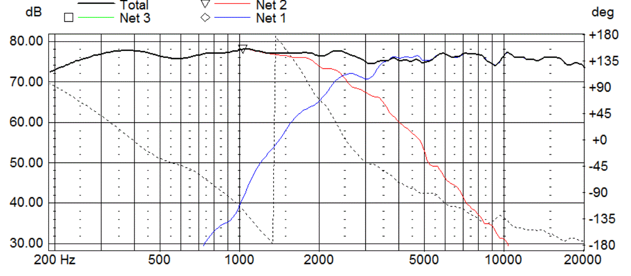

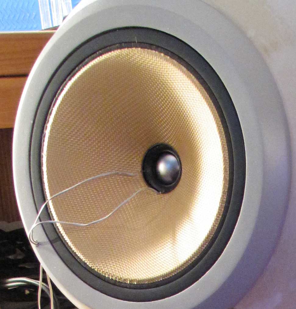

Hey 5th, since you are here... What's the tweeter you have at home right now ?
Quite literally one that suits the application as the choice isn't particularly large.
It's an Aura NT1 Titanium dome. Some new old stock I managed to procure. I've milled them down from original to around 29mm in outside diameter. Then removed the phase plug from the B&W FST and mounted the tweeter coaxially.
They are crossed at 2.5kHz, this way I get an excellent directivity match and a nice region of controlled directivity due to the wave-guide like loading of the cone. The FST makes for an excellent coaxial due to the atypical surround termination. It measures very well.

And a shot of the driver.

Well it does sound rather good. The NT1 has a nice underhung motor and very low distortion over the frequency band that it's operated over. As a proof of concept I used the ND16 from Dayton Audio, which although nice doesn't sound anywhere near as smooth as the NT1. It was a little pushed beyond its limits though.
As I do a lot of listening nearfield the coaxial makes a huge difference. I was shocked at how much better it sounded than the traditionally mounted drivers. The tweeter of course in a wave guide.
If I were to do this again but didn't have access to the FST or NT1 and needed an off the shelf unit I'd probably go for the SEAS C18EN001/M. It doesn't have the sensitivity of the FST, but it does have everything else.
