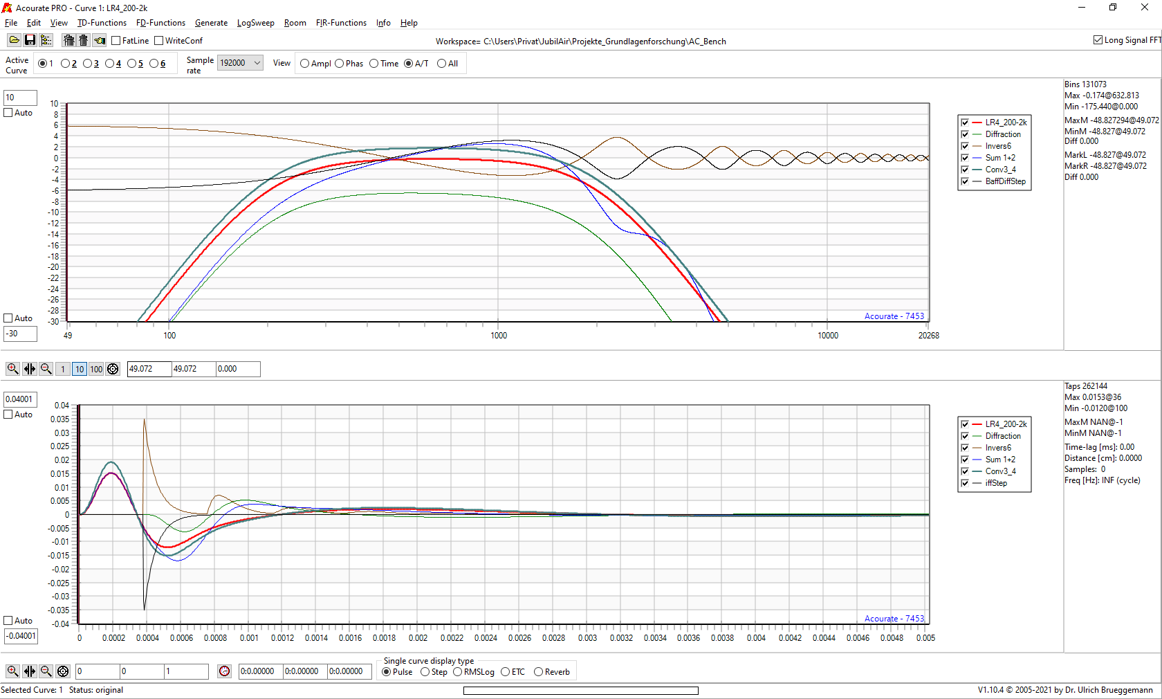

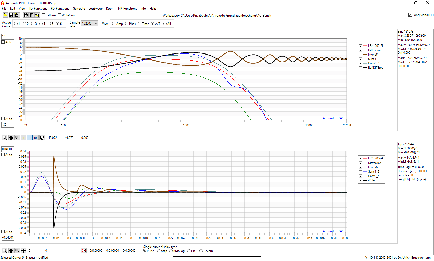

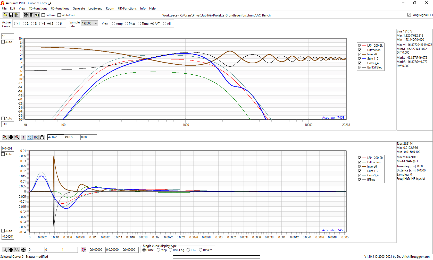

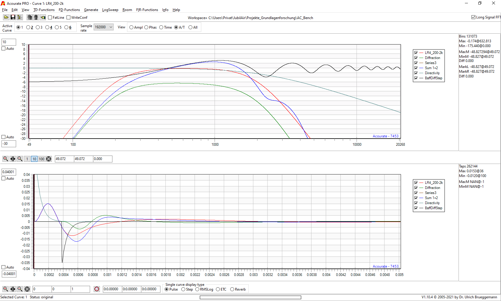

Four pictures to sequentially show what happens performing the filtering/convolution (e.g. of a baffle step):
1_Initial
Shows everyting "native" and as before with ...
Red: The ideal bandpass (LR4 200Hz ... 2kHz)
Green: The modeled diffraction
Blue: The total response as the summed impulse of bandpass and diffraction
Grey: The driver's polar behavior
Black: The difference between the ideal bandpass and the total response, aka the so called "baffle step"
2_AmplitudeInversion
Now generate a filter with the inverse of what is to be corrected:
Black: The baffle step artefact
Brown: The inversed amplitude of this. This is the filter for the convolution.
3_Convolution
Blue: The system's response as before, to be convolved with
Brown: The filter as synthesized before
4_Result
Grey: The result of the convolution process. The curve has been raised by +2dB to separate it from the ideal response we started from.
Red: The ideal bandpass response.
Look at the red (ideal bandpass) and the grey (result of the convolution) data points in the time domain and at the frequency range. They are strictly identical besides the artificial +2dB raise of the convolved result. Where would you expect impulses from impulses from impulses then ... and where would you expect alterations of the tonal balance?

Take II - Addendum to previous post - sorry, it was too late to edit
You may see a cyclic behavior of the (brown) correction filter in graph 3, e.g. in the inverse of the baffle step. This might be the location of the impulse of the impulses of the impulse's successions you were expecting. So, in the filter used for convolution, it is the correction of the correction of the correction of the correction, so to say. And the result stays clean. Very clean.
And then another variant, a hopfefully more acourate answer to your question about the altered tonal balance: It is not "Not" as I stated before. It is a big YES, insted. A YES, of course! You will certainly alter the tonal balance towards more neutrality, e.g. towards less acoustic signature of the speaker.

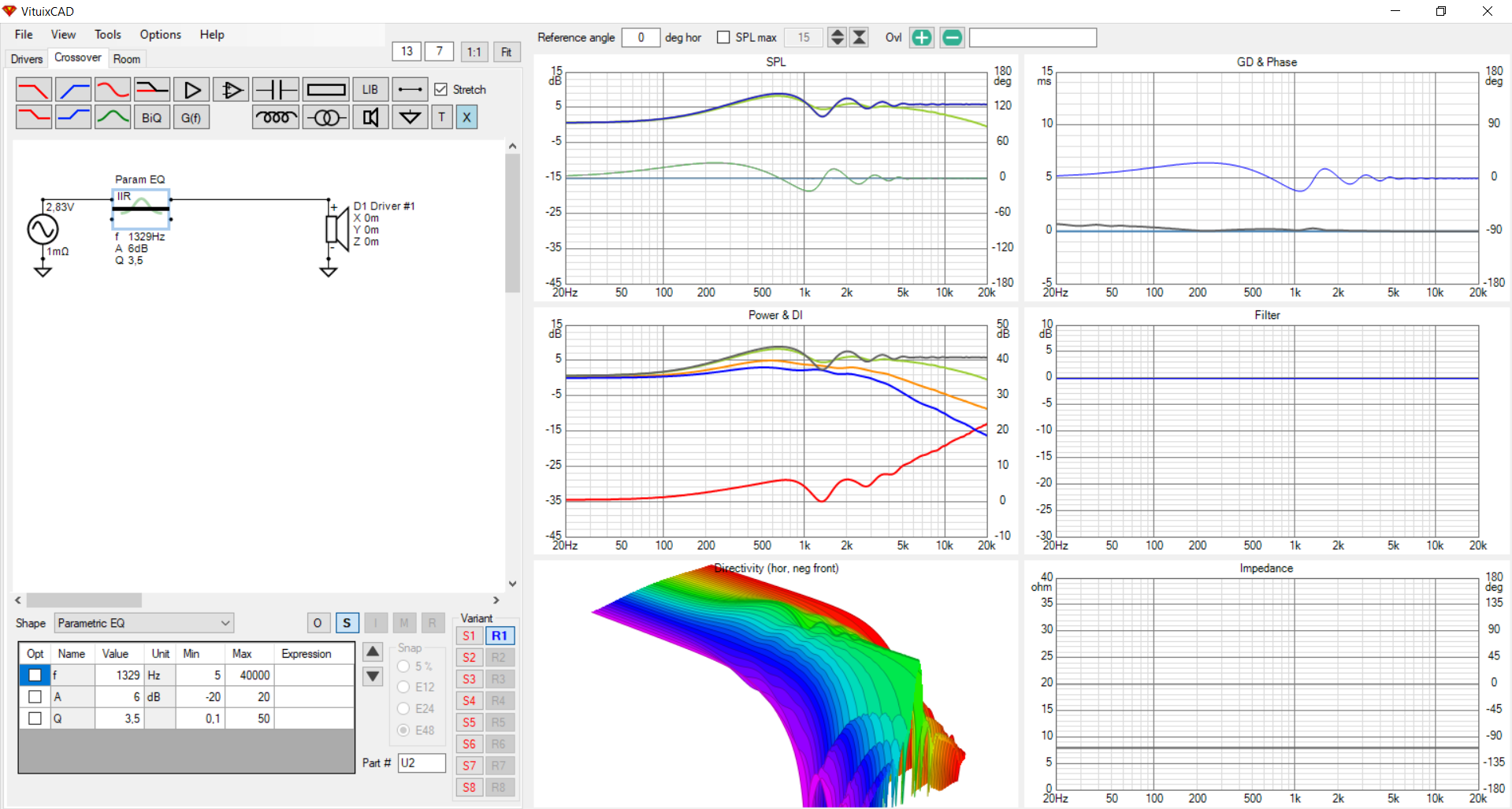

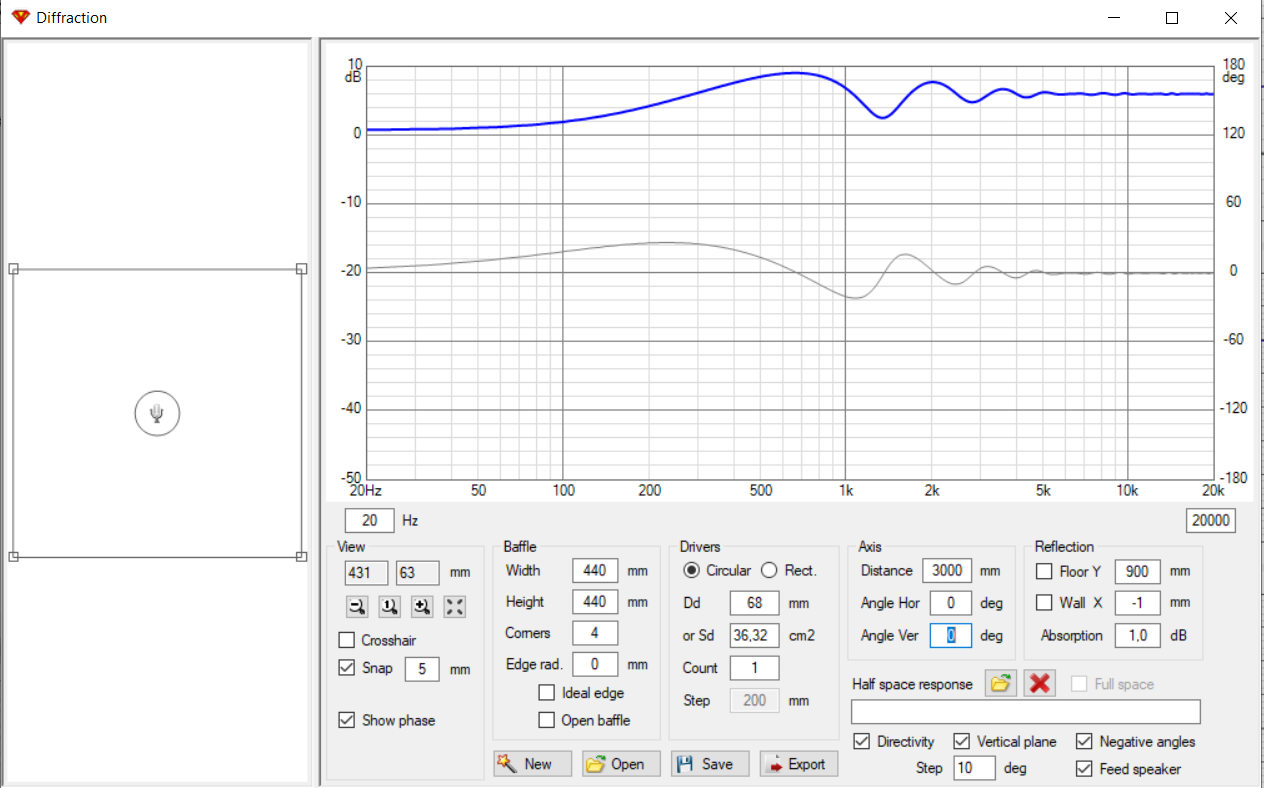

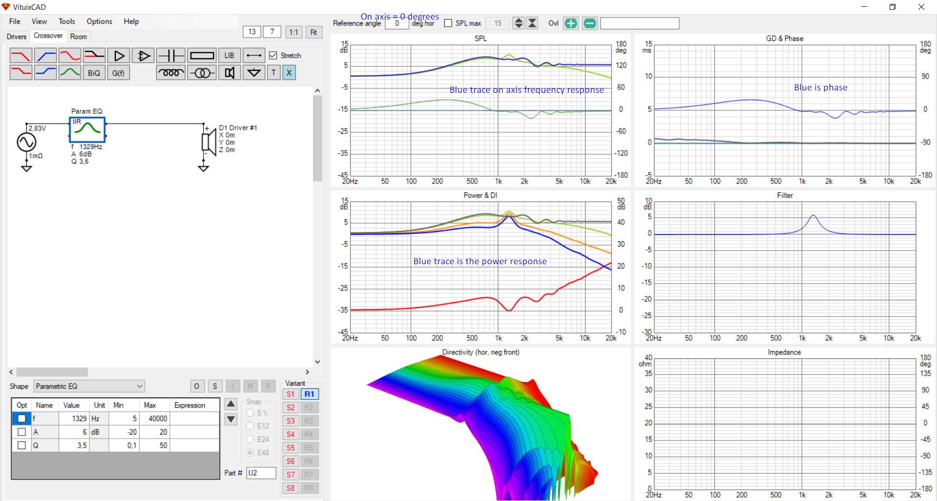

Hi, it is very difficult for me to understand (intuitively) how an EQ would change behavior of acoustic domain in more than one axis (or spot in case of diffraction correction). One can correct perfectly where the mic is measuring, but the correction makes all other angles worse since the issue is in acoustic domain and in 3D and the effect (of diffraction) happens different time than the direct signal from the speaker.
I mean the EQ affects the driver power response whereas the diffraction is zero sum game in regarding to the speaker power response. The driver might have flat power response and it is the diffraction that makes these varying interference patterns to various directions. The driver frequency and impulse response could be perfect until the diffraction comes in and ruins it (after the driver has done its job as well as it possibly can). Or the driver response could be anything else than perfect and still the diffraction adds precisely the same effect as before. The diffraction doesn't mind what the signal from the driver is and what the driver is.
If I think about that a convolution (counter acting in time domain?) somehow the issues I don't think it can because the diffraction at baffle edge and the driver emits the sound at different time. I mean the driver would have to emit a "counter smear" for the diffraction to cancel out, but this only affects one location in space and everywhere else the response gets even weirder.
I admit I don't fully understand the FIR and convolution and stuff but surely it doesn't control the baffle edge, only the driver output.
Attached is an example, I'm not sure if I'm doing it right but it is a VituixCad diffraction simulation ~3" driver at 44cm rectangular baffle. With and without a single parametric EQ filter demonstrating what happens if you correct a diffraction dip (or peak). Makes the situation a lot worse. I don't know how to do a convolution, but I believe it is possible to simulate in VituixCAD if somebody wants to try. Attachment contains the vituixcad project and frequency response files from the diffraction simulator.

@tmuikku, I find your example illustrative. The blue curve, speaker power in the second attachment (second graph.. middle left) shows that before specifically doing anything about the diffraction, it averages out to be fairly smooth. EQ would change this.
One way you could generalise it may be that all energy gets to the edge and diffracts, it doesn't necessarily get frequency specific due to that unless you stand in one spot and experience the comb filtering, and therefore there may be diffracted energy present even when it doesn't show up on a response plot. So if you do try to correct the response variations you are doing a kind of symptomatic treatment.
All this even before considering the room.
