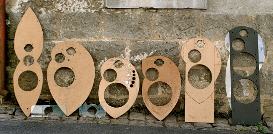

Asymmetric designs can be quite convenient, indeed, but come along with the hefty penalty of an asymmetric radiation behavior into the room, also. I therefore abandonned asymmetric designs altogether in my later designs for non-nearfield systems.... HF diffraction ... small ripples in FR due to symmetrical positioning of tweeter on the baffle
You can very well archieve a decent diffraction behavior along even with a crosswise mirrored symmetrical design/positioning of any driver on a baffle instead. Symmetry is not primarly correlated as such with a problematic diffraction behavior.
You may try to shape your baffle edges not linearly in order to steadily increase the time delay till diffraction along the rotating angle (from center). So you may end up with symmetrical, curved baffle shapes instead of asymmetric straight ones.
https://www.audiovintage.fr/leforum/viewtopic.php?t=1379
bizarre ! they at least succeeded to center the woofer !

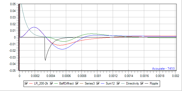

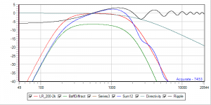

Some modelling / simulation?
In the example below, a circular baffle with a radius of 11.32cm was modeled on an experimental basis, which would be equipped with a smaller midrange driver.
A radius of 11.32 cm corresponds to a time delay of 0.33 ms and thus half of the maximum possible physiological ITD of 0.66 ms at an azimuth of 90 ° for a natural sound event. An ITD of 0.33ms thus roughly corresponds to a sound event from a horizontal angle of 30° (sin 30° = 0.5 and 0.5 * 0.66ms = 0.33ms). Which corresponds to a lateral installation of a loudspeaker in an equilateral 60 ° stereo triangle.
Graphs:
The red curve models a 4th order LR bandpass with crossover frequencies at 200Hz and 2kHz, and corresponds to the target-on-axis frequency response of the midrange driver (and also of the whole midrange of the whole speaker).
The gray curve roughly models the off-axis drop in the sound pressure of the midrange driver towards high frequencies.
The green curve selectively models the baffle diffraction. The frequency curve of the baffle diffraction corresponds to that of the midrange driver, which was convolved with its off-axis characteristics: Since high frequencies are bundled, they have less of an effect on the edge of the baffle. Since the room geometry changes from half-space to full-space at the edge of the baffle, the diffraction level is reduced by -6dB compared to the useful signal. Furthermore, in the time domain window, the impulse appears inverted, as it is a pressure loss when the wave drops into full space at the baffle edge.
The blue curve is the result of adding the two impulse responses, the ideal midrange (red) and the diffraction (green), into a single impulse.
The black curve corresponds to the difference between the ideal midrange and the diffraction.
Comments:
There is agreement that a well-controlled frequency response is of the utmost importance. This is mainly and traditionally based on tonal considerations. Frequency response and impulse response, however, have a clear, 1: 1 relationship and can be converted into one another. Thus, a pulse curve in the time domain corresponds exactly to a sound pressure curve across the frequency scale and vice versa.
The present simulation, based on a synthesized pulse course and frequency response specifications, assumes a worst-case, circular baffle with a correspondingly problematic, worst-case baffle diffraction. The black curve shows their frequency response anomaly compared to a perfect, diffraction-free system. This lies in the pass range of the bandpass between 200Hz and 2kHz within delta 7dB. That means in the graph in the range of -4dB… + 3dB.
Since this is a worst-case scenario, it can be assumed that even only moderately better baffles are likely to have significantly smaller on-axis level irregularities. This means that even moderate, tonally well-tolerated irregularities in the frequency response also have the potential to impair spatial locatability. For this reason it seems right to aim for “ruler flat” frequency responses in relation to the listening position.
Corresponding meticulous equalization by means of DSP appears to be quite sensible. This ensures that at least one point in the room, the sweet spot for the best possible solo listening pleasure, has optimal conditions for both tonal balance and spatial location. This correction by means of DSP refers exclusively to the direct sound, which in the time domain only applies until the first room interference occurs.
In this very example and in a digital multiway system, you simply could apply perfect DSP by convolving the midrange's driver input signal with an impulse corresponding to the inversed amplitude of the black curve. This would eliminate all (or at least nearly all) of the effects induced by the baffle diffraction. You would end up with a near-perfect impulse corresponding to the initial one from the red data points = the theoretically perfect LR 4 Bandpass from 200Hz to 2kHz.
For non-DSP corrected and therefore less well filtered systems it might prove useful to optimize the baffle diffraction not only within an ITD of 0.66ms (which is a must). But also to take special care of tit’s behavior within 0.33ms. Since this value corresponds to the azimuthal acoustic events within the conventional 60 ° stereo setup.
Whether with or without DSP, the aim for a psychoacoustic diffraction behavior that appears as minimal as possible by means of constructive methods is part of the functional aesthetics of loudspeaker construction. DSP can do practically everything, even if it can be used as a successful but exclusive “brute force” measure to correct problematic diffraction behavior. Enzo Ferrari once remarked the following about the then young aerodynamics: "L’aerodinamica si addice a gente che non sa costruire motori". He was wrong and right in his vanity and his pride. In this sense, the baffle diffraction should be optimized as a primary designer goal. With and in spite of the possibilities of the DSP.
Nota Bene: These statements are based on assumptions. Well-founded contradictions, better values, theories and models are therefore always welcome.
Those are cute shapes in 2D. In 3D they may look horrible
Yes, quite weird, indeed. Form Follows Function ... You don't need to go 3d along with these kind of countours. Try it yourself in 2d and you will see. You can add such a shape to your regular rectangular speaker box front for first experiences and measurements. Really nothing 3d. How goes the saying? Flat is beautyful? Or so?

Sorry for coming late, but edit time has expired: This green curve not only has reversed polarity in the time domain, but also it is delayed by 0.33ms, of course. To simulate for the time lag for the 11.32cm baffle radius....
While I follow the rest of your post, I fail on this part. It’s clear by itself, but what assumption lies under it?Some modelling / simulation?
The (only) assumption is related to the psychoacoustic decoding of a (any!) two-peaked impulse into a (virtual and ambiguous) perception of azimutal informations. I have searched for studies about this, but didn't find anything in the literature so far in order to verify or falsify this assumption. I would very much like to know wheter this is plain BS or not.
If this assumption would be true, then this would establish a relation between the direct signal from the center of the driver and the delayed signal from the baffle diffraction on one side, and the potential blurring of azimutal perception on the other side: T_center_driver_to_baffle_edge would get a similar meaning as the TID by the specific psychoacoustic processing.
Yes. And I don’t see much contradiction in what you write later on. I agree on most of it.digitalthor said:… a DSP is a line-level tool …
But I do not quite understand this story about Geddes and “spaciousness” and “imaging”. Geometrically, I understand an “image” as one specific 2D representation of “space” (3D in these terms)? So “space” would be “image” plus the dimension of “depth” along with the psychoacoustic interpretation of ths perceived "soundfield"? Oh my, these terms ... isn't "field" 2D again ... And again much psychoacoustic processing we still do not unterstand well. Diving into the scull, we unfortunately do not have any longer these precise models as we have for the acoustic world outside the scull.
Anyway, maybe I should have better written “ … DSP can do practically everything, even if it can be used as a successful but exclusive “brute force” measure to compensate or minimize problematic diffraction behavior, at least for one point within the auditorium.” And I think it is quite evident from my writing that I strongly advocate the correct physical design of baffles in order to smooth the diffraction effects. Before applying any DSP in order to correct for an eventually misbehaving diffraction. By the way, I also opt for aerodynamics before motor power, but certainly do appreciate and welcome both options.
I think we must not underestimate the power of masking. Recognizing a second, almost identical signal, weaker than the first and several hundreds of microseconds later is highly problematic for us.
Also, the diffraction signal reaches both our ears too. The ‘comparator’ in our brains that receives the neural pulses from our ears might be fooled, we can’t rule that out completely, but it is not very likely.
