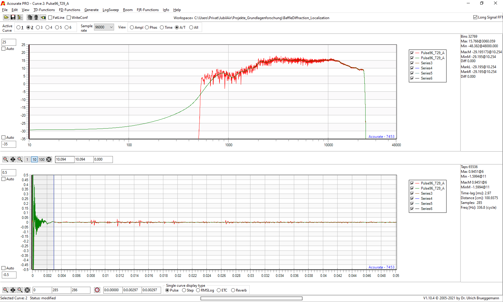

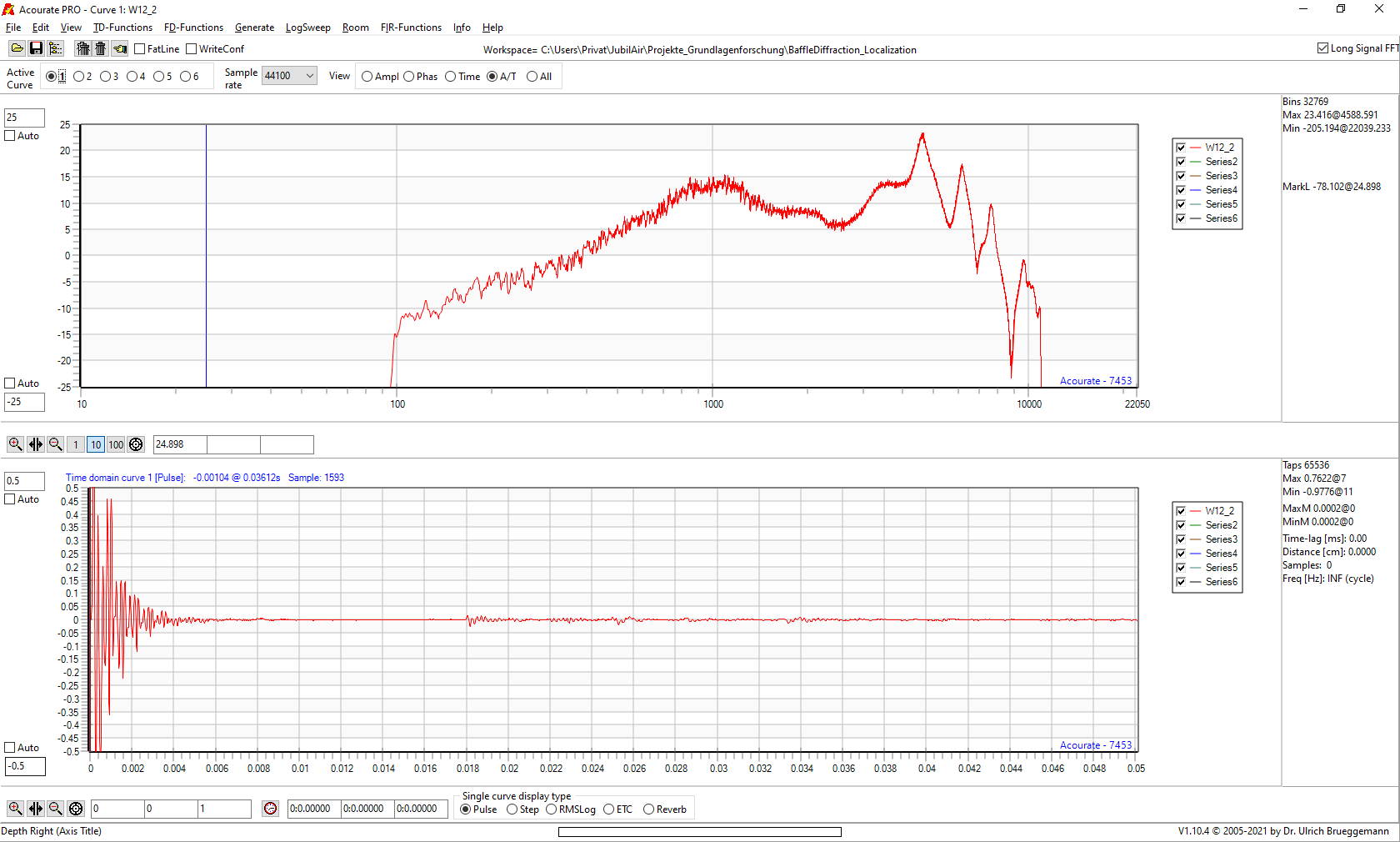

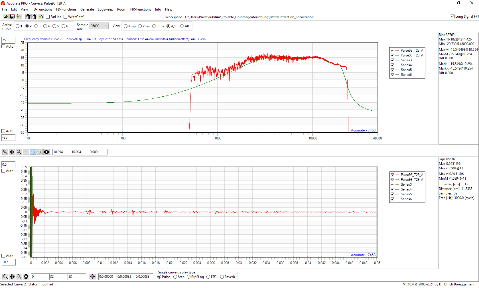

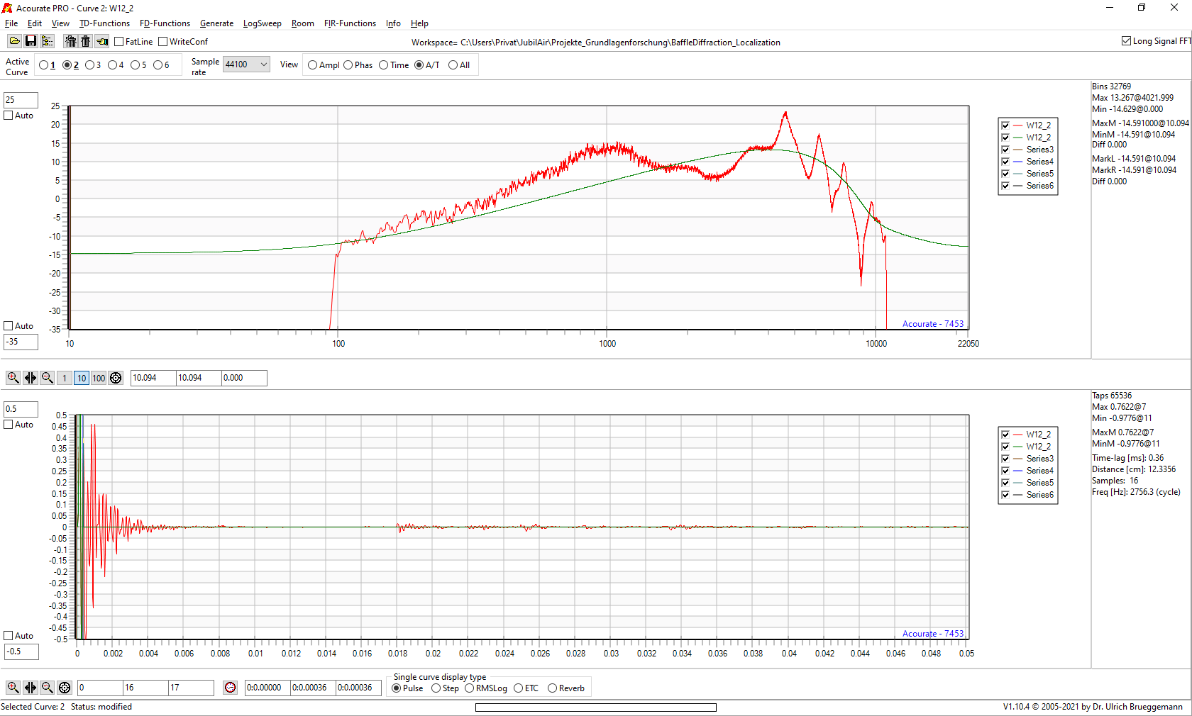

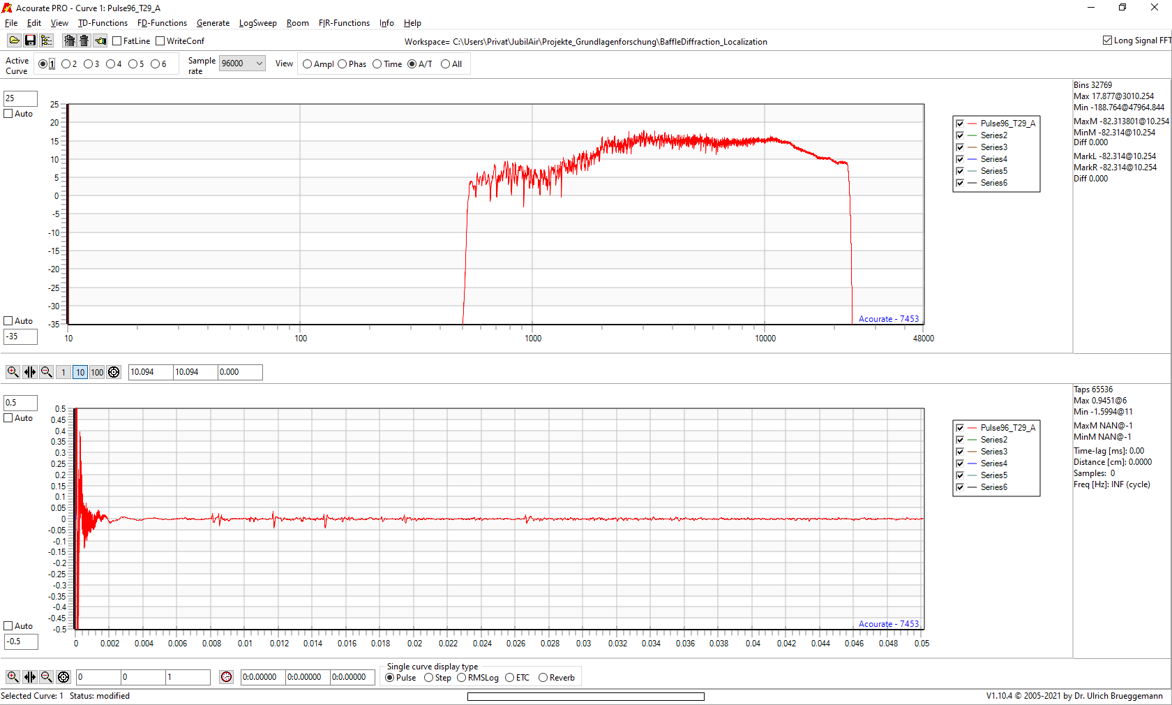

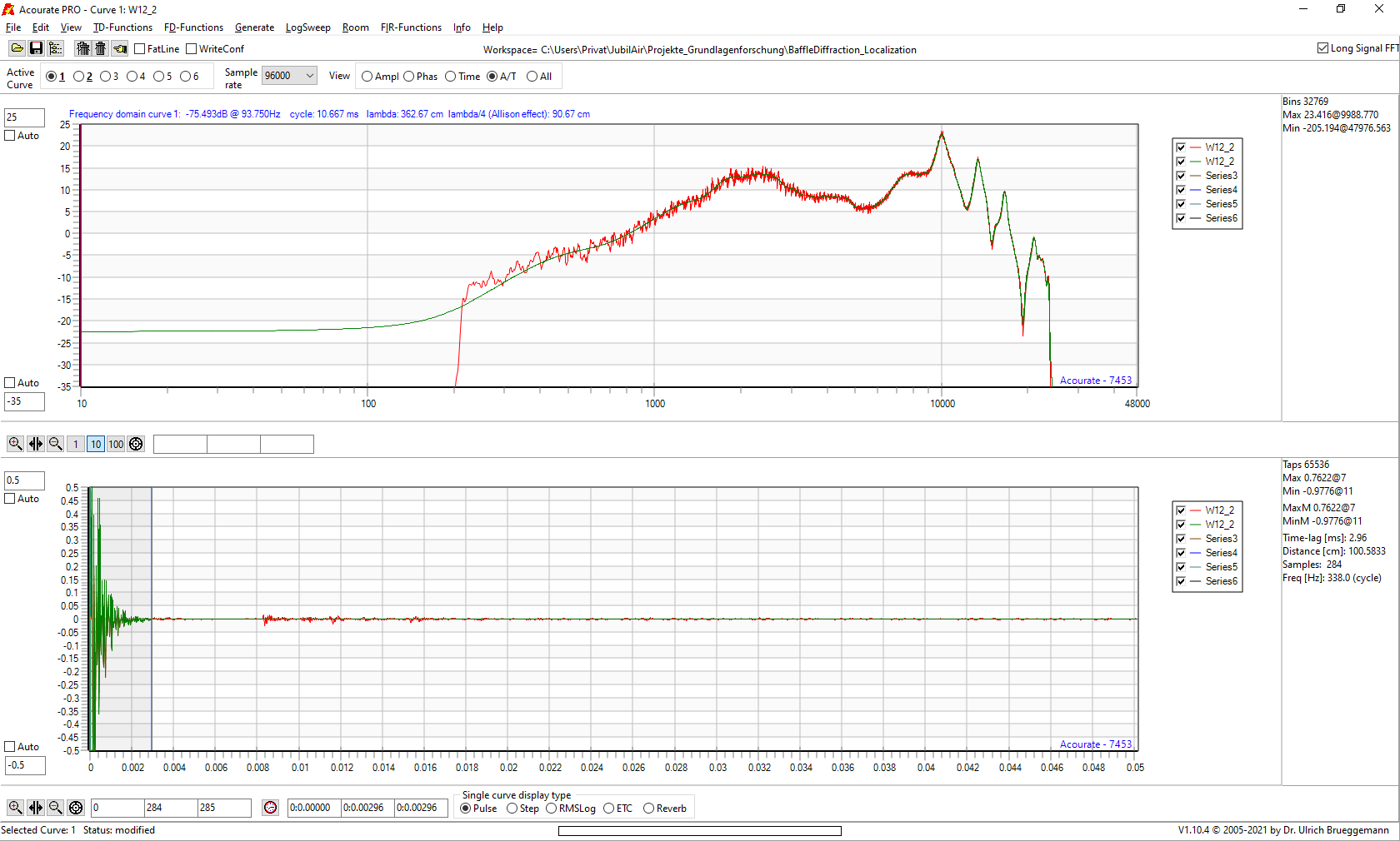

It's two measurements sets. Once for an Excel W12CY001 Midrange and then for an Excel T29M001 tweeter. Both sets include
1_Long:
Red is the first part of the impulse with a long truncaton, roughly including every echo within a time lag corresponding to 15m. So including the room where the measurement took place.
2_No_Floor:
Red is as above.
Green is the the first part of the impulse truncated so to exclude any room influences (a time lag corresponding to sound travelling for 1m, e.g. excluding the floor reflection)
3_No_Baffle_Diffraction:
Red is as before.
Green is tuncated to a time lag of corresponding to a circular baffle of r=11.23cm. Therefore, with this truncation, you will null the baffle diffraction. And now look at the frequency domain window: You will see that trying to generate such a ridiculously short filter, which would exclude the baffle diffration, would come along with quite absurd results. Even for the tweeter case. Nota bene: This would generate quite an effective filter. But a filter simply not suited for regular audio.
So the two take home message would be:
- You will always influence on the baffle diffraction effects when filtering a driver by this method of DSP
and in the reversed logic
- You cannot selectively exclude baffle diffraction effects when filtering a driver.
If you want to stick to controlling the driver but not the baffle diffraction by DSP at the same time, then you have one possibility left: You can make your baffle really wide. There you go. Speaking of meters, then ....

#608, Aha! You are talking about temporal EQ stuff I was still on the IIR EQ. Windowing (truncated time) is exactly how would one measure problems on the loudspeaker leaving the room out. Diffraction is contained within the measurement window but when one does full "spinorama" measurements and simulation diffraction effects are pretty easily spotted from the polar /power, as in the VituixCad example I posted earlier with ideal driver on a baffle simulation. With such information the diffraction can be ignored while designing an EQ or crossover.
I still think we are mostly speaking about the same stuff but there is still some confusion, at least I believe so. I try explain my point of view once more 😀
For example this is wrong statement or wrongly written thought (or I'm misunderstanding):
since no matter what the driver response is the baffle diffraction adds precisely the same effect to the output at given mic position regardless what the driver output is (what ever EQ).
Example: If there is dip on 1.5kHz at 2 meters away 17 degrees left from the axis, compared to a location next to it, the dip will always be there (due to diffraction superimposing to the direct sound) no matter what the frequency response of the driver is. Now if you want to have that dip disappear at that spot with EQ you boost the 1.5kHz either with IIR ( or FIR with "countersmear" ) to the direction ( and location ) but you end up boosting the 1.5kHz everywhere else so the dip still remains comparing to spot next to it we compared before the EQ. Only thing one can actually do to fix the dip, between these measurement spots, is to make the diffraction disappear = change the physical acoustic properties of the loudspeaker.
I'm not sure if you can convince me to think otherwise but you can try 😀 I'll read at least. These are fun things to think about, very complex stuff.

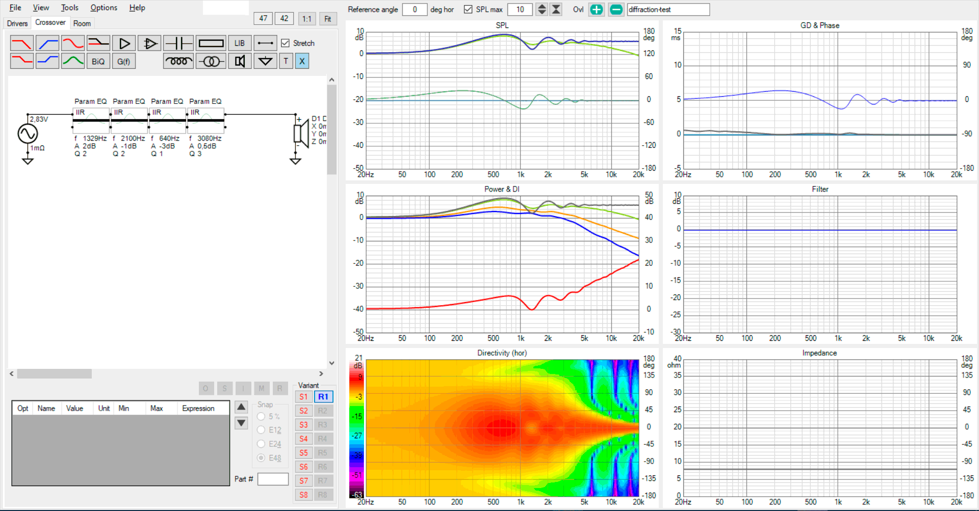

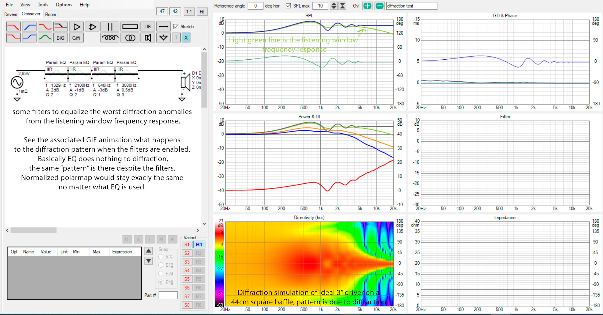

Quick animation, same diffraction simulation as last time back in post #567. This time the directivity window is set to polarmap instead of surface chart like last time. One file contains the legend and the other is a GIF animation that is attempt to show that no EQ will change the underlying pattern diffraction imposes on the loudspeaker response.
The EQ filters make listening window response (= listening zone) more flat but the inroom (power response) suffers and the diffraction is still the same. I could put normalization on for the directivity window but that would give the same (unchanging) view no matter what EQ is applied.
