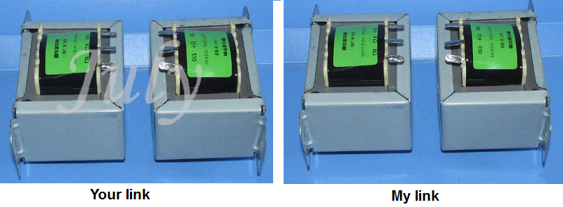

A rather sketchy looking one - the pictures make you think pair but I think the price quoted is for one
I found the same thing here, 8K push pull 5W output transformer, frequency response 12HZ 45KHZ 3DB, suitable for 6C16 5842 5686 and other tubes|Transformers| - AliExpress
They say "Quantity: 1 + 99 Pair available" look as they go in pairs.
With outputs 2Ω and 4Ω on the connections 4 and 8Ω you get Raa=4k.
Transformers with 3wire 110/220V are not symetrical.To use it as an OPT you need 2x 115V, series 230V and parallel 115V.For the two 115V to be paralleled they have to be identical.
Mona
That's not quite the same thing though. The one I listed has "Amorphous dual C-type iron core" while the one you listed does not. By saying they are the same you might be saying that those words are meaningless marketing. If so I appreciate the feedback. Actually I thought that one was too expensive compared to other options but I had to post it because I'd never seen a transformer held together by a hose clamp.
I figured that the 0-110-220 inputs must not be symmetrical but given some of other things I have seen in listings I decided to ask just in case. Thanks.
My Corean is not so good 😀 so I only look at the pictures.And I don't see much difference 😕

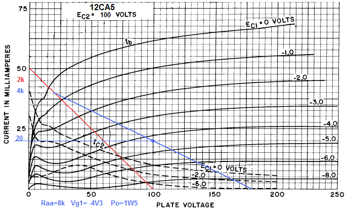

Only the bias -5V I think and an output perhaps just over 1W.
I think you are right on the bias. While the data sheet gives -4V at 110V plate and screen voltage(and -4.5V at 125V) it looks to my novice eye that it would be better to bias at roughly -5. That looks like a swing of slightly over 160V peak to peak in PP for a 10V peak to peak input with an 8000 Ohm transformer load to give 1.6W.

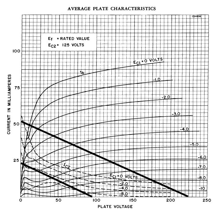

I do sort of question this. Biased at that point with plate and G2 at 96V it looks like a 10V peak to peak signal will stay firmly in class A. At -10V on the grid the tube isn't shut off yet. Maybe that isn't something to worry about?

Yes, if you bias too high you will lose power. When biased in class A, where both tubes are providing transconductance over the entire cycle, the load resistance is half Ra-a. The load on each tube is 1/4 Ra-a, but with two in parallel R doubles. When one tube cuts off, it transitions to 1/4 Ra-a, increasing the current swing in the active tube. You get a “kinked” load line, but only if you drive hard enough to cut the lower tube off. It’s not a sharp transition, it happens gradually as one tube loses transconductance (curves getting bunched up at the bottom) and the other still has plenty. Somewhere there is an optimum bias for best overall linearity (where the composite gm’s tend to be more constant) - it may not be the same as for optimum power. Low voltage amps tend not to be the most linear because of so many other constraints, one of which is to get a useable amount of power.
@Ketje - fair enough. That makes sense and is why I did the rough power scaling that I mentioned earlier (I was fully expecting to see about 0.7 W per tube based on a purely V squared rule that works very well given the two operating points I have found on most data sheets).
@wg_ski - Thank you. I think you might have cleared up one thing even if you have raised some other questions.

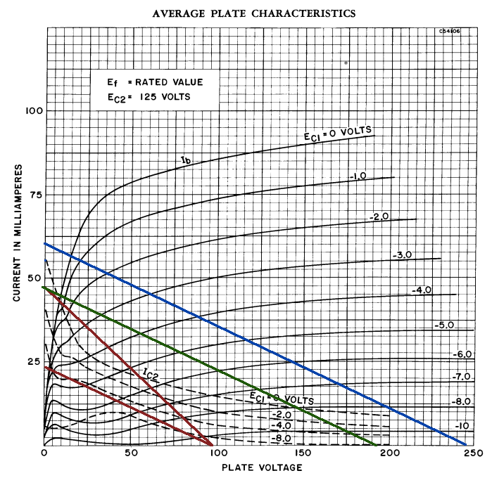

First, if I re-draw the load curve using the values from the data sheet (V plate and screen at 125, plate current of 32mA, load of 4000 Ohms) and biased at -4.5V. I didn't fire up Gimp again to shift the line but a rough guess says that leads to a minimum voltage around 24V with a max current of 60mA. Using the power output calculators from a couple of sites that talk about drawing load lines that would indicate more like 3W max power when the data sheet says 1.5W for those conditions. Are these sites just being way too simplistic by calculating power as (HT - Vmin)*Imax/2? Note that I'm not worried about distortion (right now) and whether it is a good idea to run all the way to cutoff; that will come later.
Sort of 1.5. Related to the calculations I did yesterday and the rough stuff in the last paragraph it seems like I might simply have the wrong idea of a good zero signal plate current for push pull operation. How does one chose this given that the data sheets almost invariably give only SE operation data?
Second, can I ask for clarification due to the negative sign. By higher bias do you mean closer to zero or larger absolute value?
If you assume you are running fully class B, the most voltage swing you could expect is about 70 volts. With an 8k CT transformer, the class B load line is 2k, giving 35 mA of current swing and 1.25 watts of power. To get that much, you would have to bias well under 1/4 of that. Linearity might be pretty poor, and biasing up at 17.5 mA would result in a 4K ohm class A load line, and half the power. You might be better off (in this application) getting a 4K a-a transformer instead of 8k, and plan to run in class A push pull up at 35 mA or so. These things are usually run single ended, with a 2k load, when operating off 110 V B+.
According to the data sheet they are designed to run SE into a 3.5k at 110 B+ (or 4k at 125) so yes I am looking to run what is likely to be fully class A PP. Logic suggests that I can't shift the load line infinitely far to the right so I have the green curve that would need to be biased to around 24mA. This might have problems on the negative swing but it's PP so the other side will be working well.
The blue curve is great and the Valve Wizard doesn't say anything against it but I don't see how the inductance of the transformer can supply that much voltage. If it can a bias of -4ish looks good.
Clearly I'll be putting a pot on the biasing voltage divider to play around with different values! BTW, these things have a 5W dissipation so the blue curve stays under 70% of it at all points.
