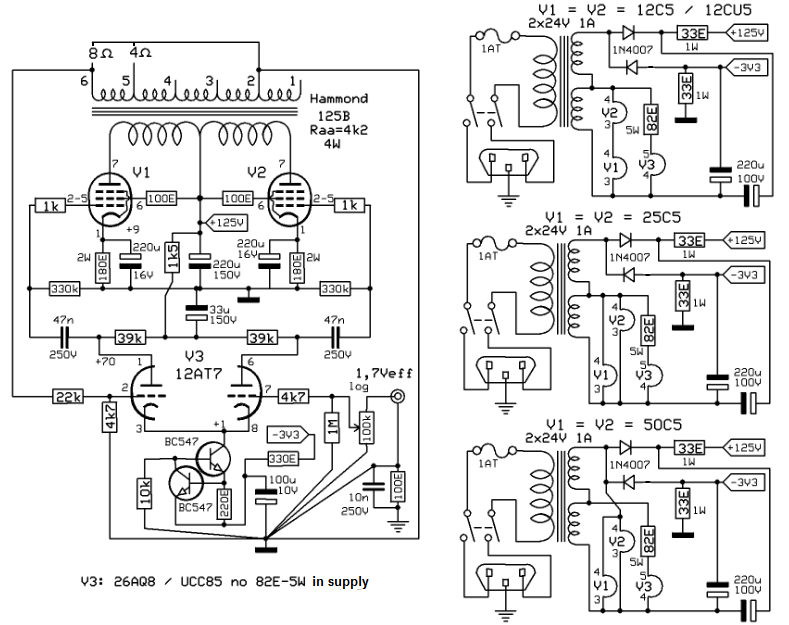

Look at the low voltage amplifier designed by forum member Pilovis : Low Voltage (60V) Stereo Tube Amplifier for Dummies (2+2W)
This design does use a high current tube that does not need a real output transformer to get a nice low frequency response, and the power transformer is also cheap. It is possible to use different input tubes and power transformers. For instance, the UABC80 / 28AK8 tube does have a triode section that is electrically identical to 6SL7, and the filament does work about at the same voltage as the power tube PL504 / 27GB5. This will simplify the power supply section. It should be possible to build this circuit with other sweep tubes as well. I havent'built this amplifier yet, but it has been built successfully by several people already and the power output at low distortion level is a little bit less than 1W - this should be enough for your goal, I guess, if you use a high efficiency speaker.
That's a great call. I should have listed his build as another inspiration. I remember thinking that the idea of a stereo output that is simply two identical mono outputs (as far as I can tell) seems a little bit odd. Still it is clearly in the running as I start to nail down ideas.
You don’t really need to use exotic tubes. A pair of 12C5 or 12W6 ($3) in push pull will work fine into a 2 to 3k a-a load off 100-ish volts. And produce a couple of watts, not a fraction of a watt. A small center tapped power transformer of the appropriate voltage (10 or so volts CT) can be used as the output transformer. The little Antek toroids will work here, and have decent enough frequency response for this purpose. And they have appropriate power transformers at around the same price. That’s the cheapest way I know to get the iron. If you found an old line-operated hot chassis amp to cannibalize, it probably would have the right output transformers in it.

When I went back and looked at Pilovis's circuit today I had another reminder of why I bookmarked it but went to look at different options; I look from his circuit to the PL504 data sheet and I see little reason to assume it would make a good output. I believe that it does but I went looking for combinations of tubes where I could clearly see the reasoning for the selections.
You certainly could use horizontal sweep tubes for outputs at low voltage, but you don’t have to be limited to them. A 12W6 and a socket cost less than a sweep tube, more expensive (compactron or magnoval) socket, and often a top cap. And draw half the heater current while still having useful plate current at 100 volt screen. Octal sweeps tend to command higher prices, but they do have some in the $5-6 range. The supply is dwindling. There are probably enough old “line operated radio” outputs around to keep tinkerers supplied for a while. Now if you wanted to make 50+ watts off of 200 or 300 volts, sweeps are the way to go.

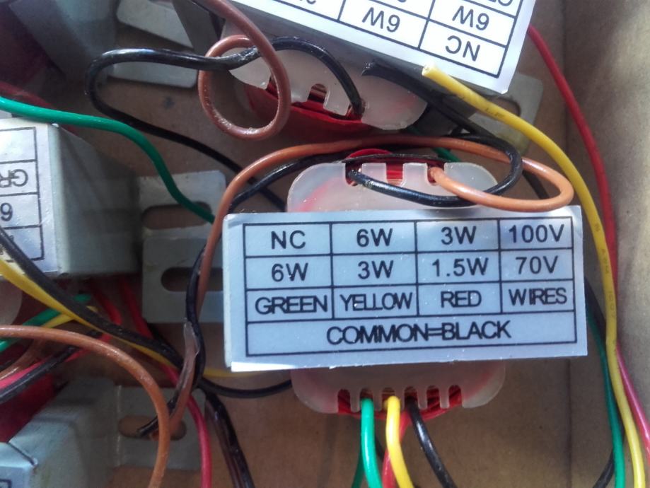

maybe a 70V or 100V line transformer might fit the requirements for a cheap OPT for a push pull amp?

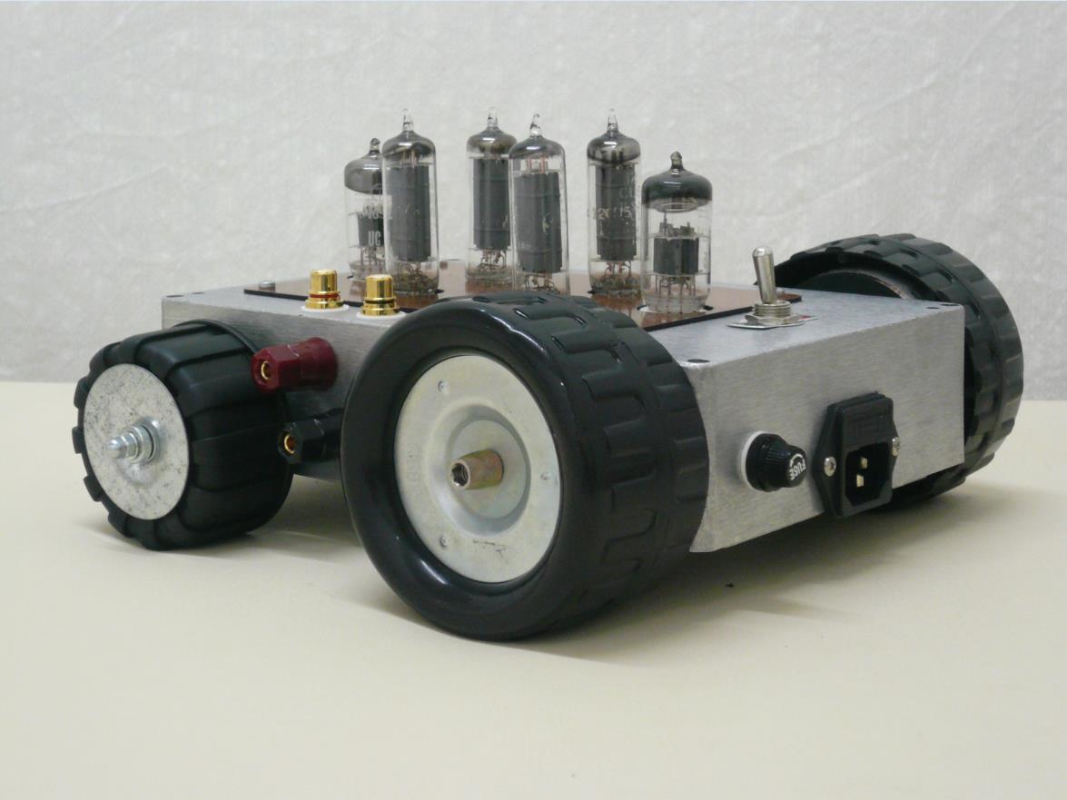

Long time ago i proposed a low voltage amp.It was build by a forum member with toroidal outputs, not the Hammonds i proposed.With the four tansformers it looked like a car with the toroids as wheels.

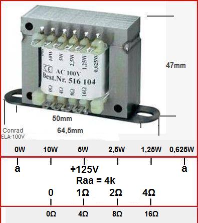

But you could also use 100V line transformers as mondogenerator pointed out.
Here the schematic (a bit more simple then the original) with supplys for different possible tubes.And also how to use a line transformer.
If the amp oscillates invert the anode connections of the output tubes.
That is because there is no indication witch connection is the start of the winding.

That looks, at least at a first glance, rather close to my first pass at a design. I'll post a schematic later (perhaps this weekend) after I get something that looks neat and organized in LTSpice. I like the confirmation that a the 12AT6 by itself is enough to drive the 12C5.
Not for push pull. The power taps need to be related by a factor of 4 to make a center tapped transformer. You might be able to get away with single ended operation at a low enough DC bias. Some line matching transformers tolerate this, others just saturate.
In post 12, the last tap is off by one position but it’s the right idea.

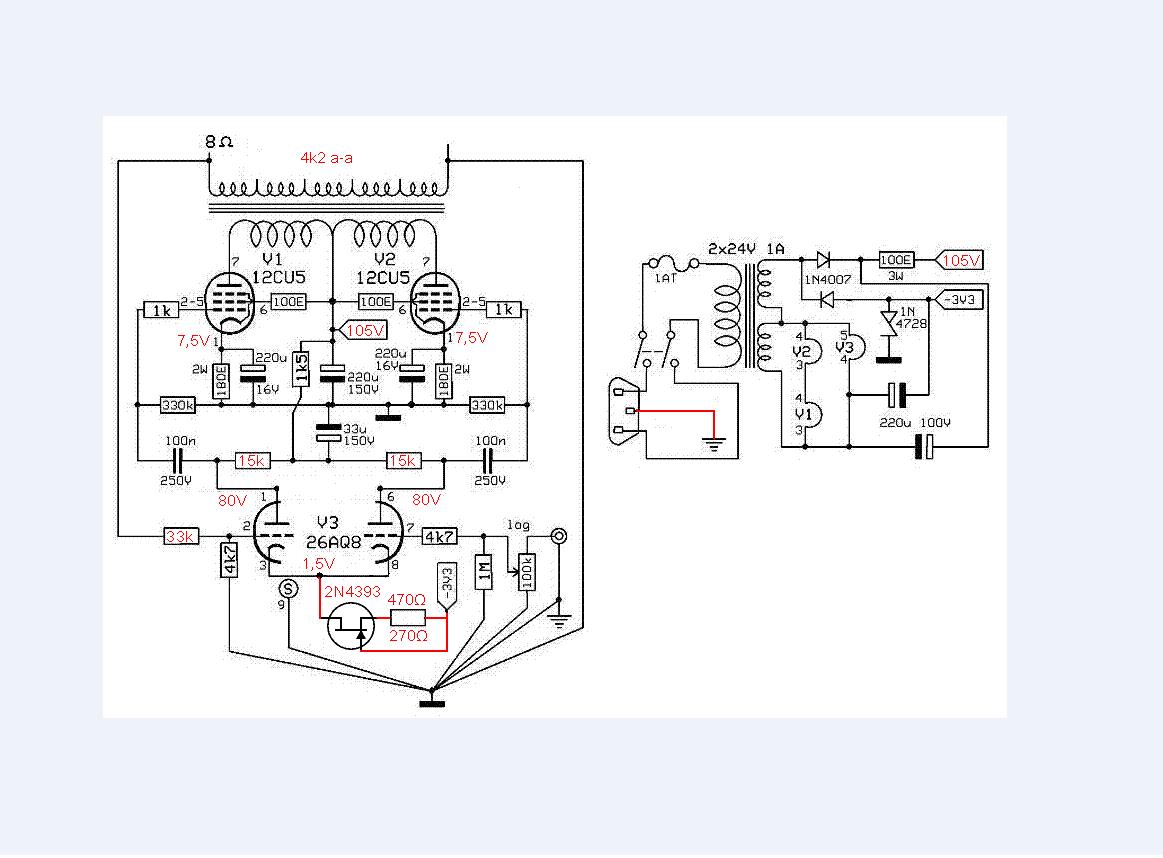

Really small but speedy and lots of grip.:D Keeping the 100ohm filter resistor at the psu gave lower B+. That was not a problem for the power stage but I had to reduce the load resistors of the input tube. The jfet CCS was just to save space on the pcb.
I used this for OPT: Toroidal Transformer for audio: Out ~11V/0.55A; Input ~100/110/120/220/230/240V | eBay I had to reduce feedback to make it stable. Frequency response is nothing like flat but it does the full audio spectrum. Given the purpose being radio listening afterhours, this is a very nice sounding little amp.
PS. I just remembered the very first test of this amp connected to my 94dB/W/m open baffles. I thought to make it easy and chose Ry Cooder's "Paris-Texas". It made it clear once and for all that it's only small to the eye!

I have found that many 70V or 100V line transformers have a mid band resonance or efficiency centred about 2kHz, when I have tried then for a SET parallel feed OPT. The DC blocking capacitor, in that case may need to be larger. I didnt stay with that particular toroid long. I found smaller (5VA or less) toroids worked better in what was a headphone amplifier.
