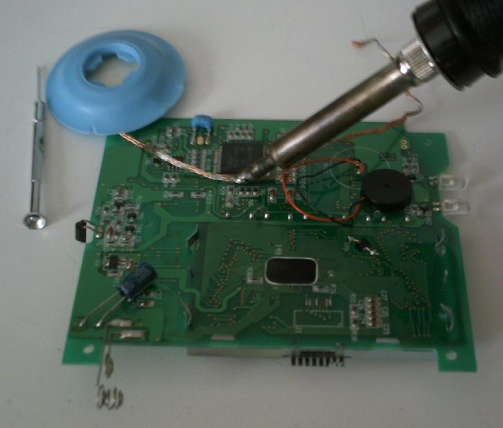

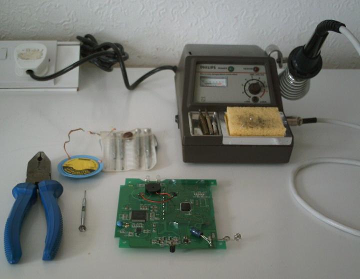

Something I have been meaning to do, put down in words and pictures how to work with surface mount components. This is a technique I developed years ago when SMD first appeared and we hadn't the luxury of re-work stations etc.
These pictures show how to remove a "postage stamp" I/C. Timewise it would take me around 6 or 7 minutes to remove.
First picture shows the tools used. Nothing special, just a good iron and braid and a jewellers screwdriver that fit well between the legs of the IC.

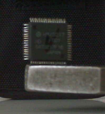

This shows how to apply the braid. Use a hot iron, I used a large tip as you will see, and don't be afraid to even "apply" a little fresh solder to help it wick up into the braid. You will never "unsolder" the legs this way, just quickly remove excess solder.

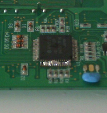

Using the jewellers screwdriver. Carefully ( I fitted a smaller tip in the iron for this) heat the print directly in front of the first leg and at the same time with the driver between this leg and the adjoining lever gently to "break" the bond. Do this for all the legs-- takes minutes thats all.

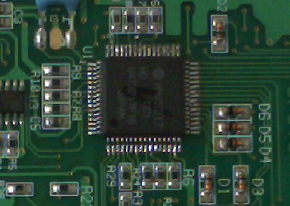

This is the "unprepared" print. Using braid "wrapped" over the iron tip gently wipe the print ( never crossways - it WILL lift and be damaged) and remove all excess solder. Clean with ISO if required.

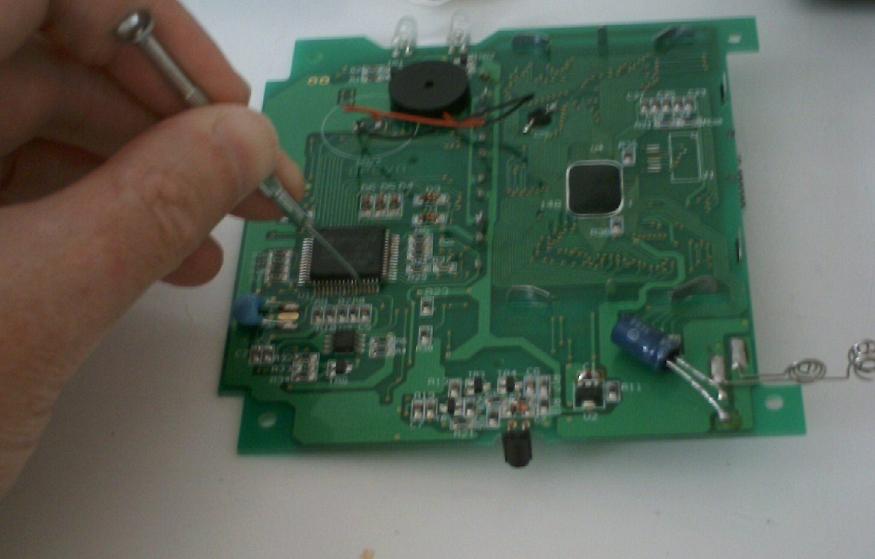

Position the new IC. Make sure it is correctly positioned. You can either try and solder each leg by applying solder to the print directly in front or try this. Put plenty on, then use the braid as earlier to remove.

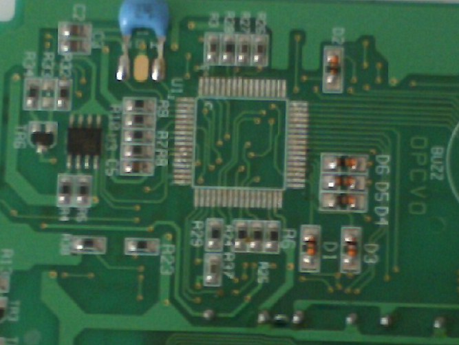

Job done. Remember this was a re used IC and the pins were not perfectly straight. In reality it looks pretty good, and a new part should be virtually idestinguisable from a factory fit.
So if you are wondering how to get that OpAmp out. Now you know :)
I should add that a lot of parts are glued as well. No problem. Just be 100% sure ALL the legs are free and either prise off or "grip" with pliers and twist.
