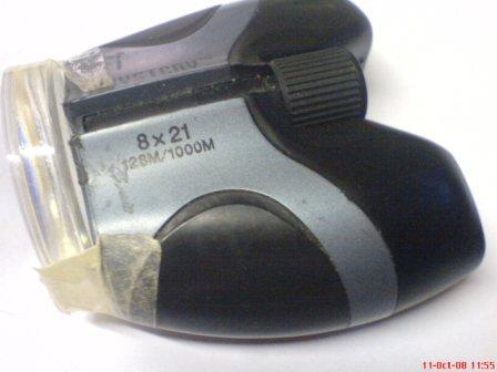

I use my glasses and a magnifying glass. I used to be able to see everything fine, even the markings on smt stuff. Approaching 50 now and my eyes really don't wok that well any more, not for close up stuff anyway.
-Chris
