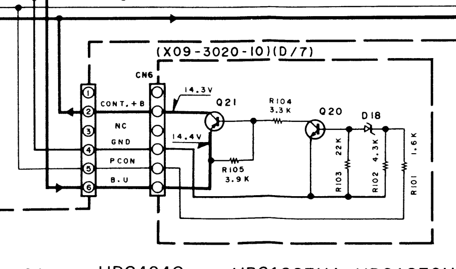

Does the amp have good fuses in it?
Is that transistor shorted or reading really low resistance from base to emitter (ohms, no power applied)?
If not, follow the circuit back to the next transistor. Black on emitter of that transistor, voltage on base and collector with power applied.
The is a next transistor which is center leg is connected to a resistor and to the emitor of the a1543 is that the transistor that your talking?

I don't know. Give me the voltages on it.

Not likely. This amp looks like it went swimming. If so, it may not be worth repairing.

Clean up r board with alcohol and then ill try to send you a better quality picture of the trace, and no I didn't went for a swim. The board had Grease all over it so I had to clean it with gasoline what could be damaged by using gas? To clean Grease

There is a cracked diode in the remote section

Yes the components are scarcely the same, I have r101 r102,r103 which means d18 on that diagram is the same as this one?

If that's the same as D18, it will have to be replaced. For now, you could replace it with a piece of wire to see if the amp will power up. Don't leave it powered on for more than about 10 seconds at a time.

Don't run it without having the transistors tightly clamped to the heatsinks.
That zener is likely a 5.1v.

I have no experience with zener what should looking for or testing for?

If the transistors are clamped down, you can run it longer. The risk is to the resistor that feeds the zener. It will be dissipating more power without the voltage drop of the zener and may fail.

A zener tests like a normal diode.
You don't need to test. Just replace it if the original was broken.

Replace it with any zener?

Ik that when replacing a zener is different from a regular diode
