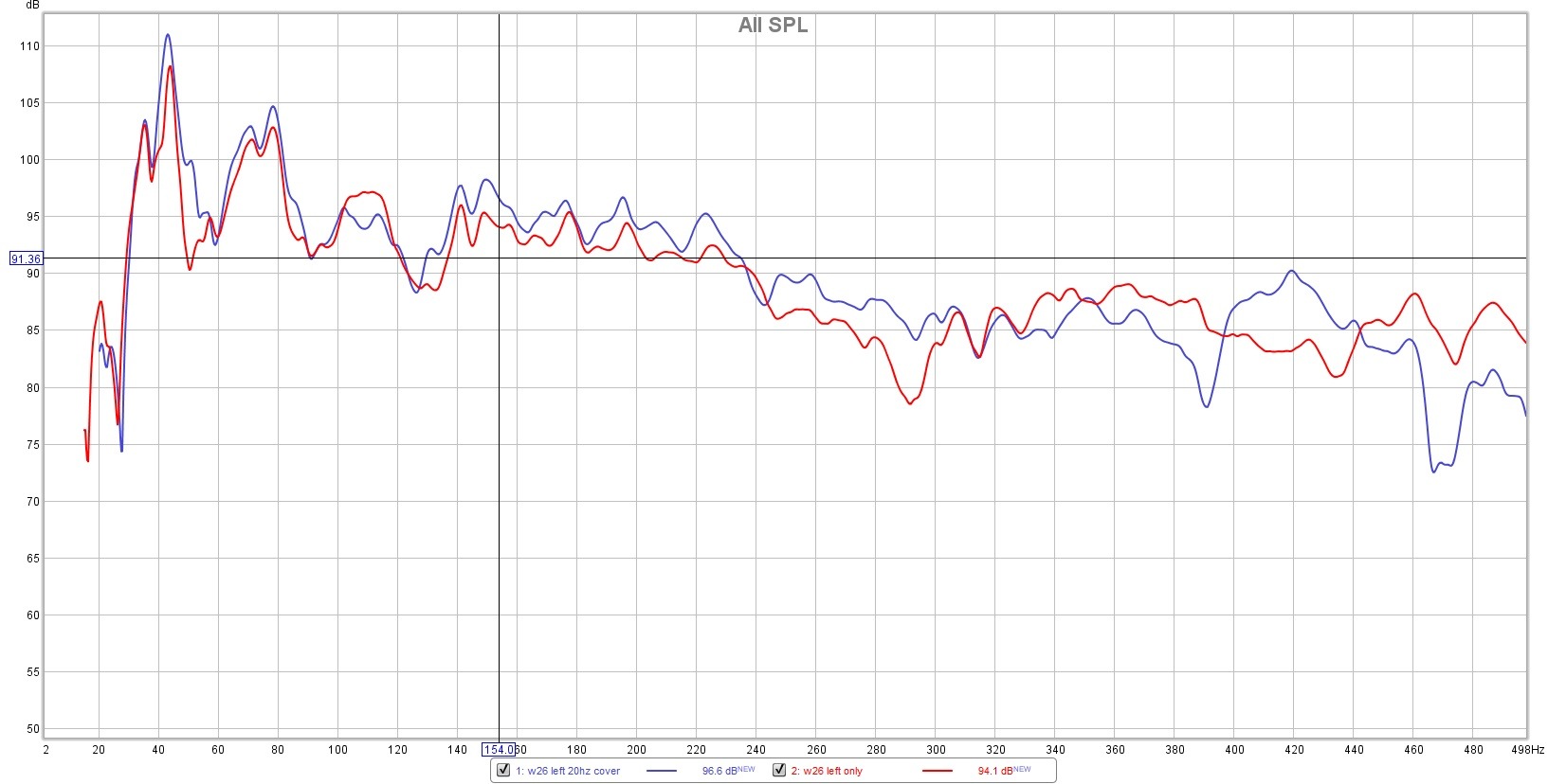

So here is the lower tune, from 34Hz (blue line) to 28Hz (red line), featuring the Seas 10" W26FX002:

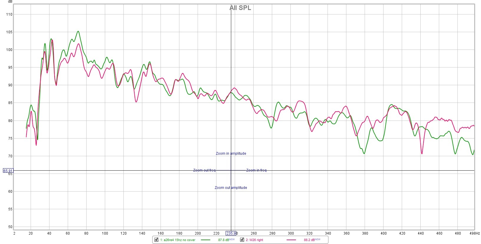

In the right channel I still had the Seas A26RE4 (green line) at 34Hz tune, and I switched to W26FX002 at 28Hz (pink line):

Your room (and speaker position) is blessed (or coursed - depending on the view) with raising powerful bass, but what is important - the frequency response is rather smooth, without major resonances. Although measured difference is only decibel or two (or three...), ear is surprisingly sensitive to such small differences in speaker output, "seeing" through the room resonances.

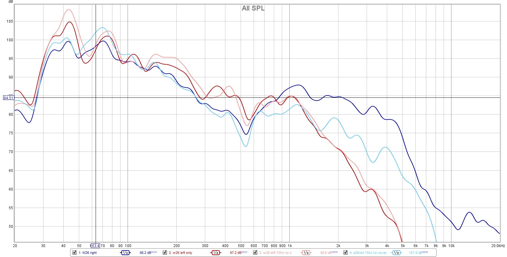

Could you, please, change the frequency axis from linear to logarithmic one? Frequency axis usually is logarithmic.

Ok, logaritmic coming up soon.

I like what you get as a frequency response. Frequency response plot should be 1/6 octave smoothed, you don't need super-zoomed resolution.

As requested: The W26FX002 in Logarithmic scale and 1/6 smoothing:
Bright blue line: the A26RE4 with a 34Hz tune in the RIGHT CHANNEL
Dark blue line: the W26FX002 with a 28Hz tune in the RIGHT CHANNEL
Bright red line: the W26FX002 with a 28Hz tune in the LEFT CHANNEL
Dark red line: the W26FX002 with a 28Hz tune in the LEFT CHANNEL
The lower tune gave a noticably smoother bass, and less obnoxious bass on certain tracks. Still a bit too much bass.
When I plugged the port with foam I got a tighter and dry bass that was just right, but almost underwhelming after a few days with ringing ears.
These are new drivers with 0-10h burn. The stiffest of the bunch is the one with the most upper midrange.
The dip at 550Hz is a mystery. I moved out the speeakers from the wall but it did nothing.

Dip at 550Hz probably is cancellation caused by the reflected wave from the floor. Put some really thick rug on the floor in front of the speakers - find the correct position by placing a mirror on the floor: where you can see the woofer (while you are sitting in the listening position) - that is the right place for the rug.
Room modes are at 43Hz and at 70-75Hz. Lower tuning at 28Hz definitely helps with the 43Hz resonance, and I suppose it is even better with plugging the ports. Unfortunately, maybe it will not help with the 70-75 Hz mode, because the closed box has almost the some output here as vented, but it is worth trying. Another measurements (closed vs vented) perhaps?

Thank you, very insightfull. Today I will try closed vs vented with 28Hz tune.

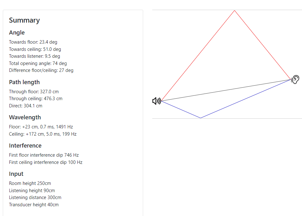

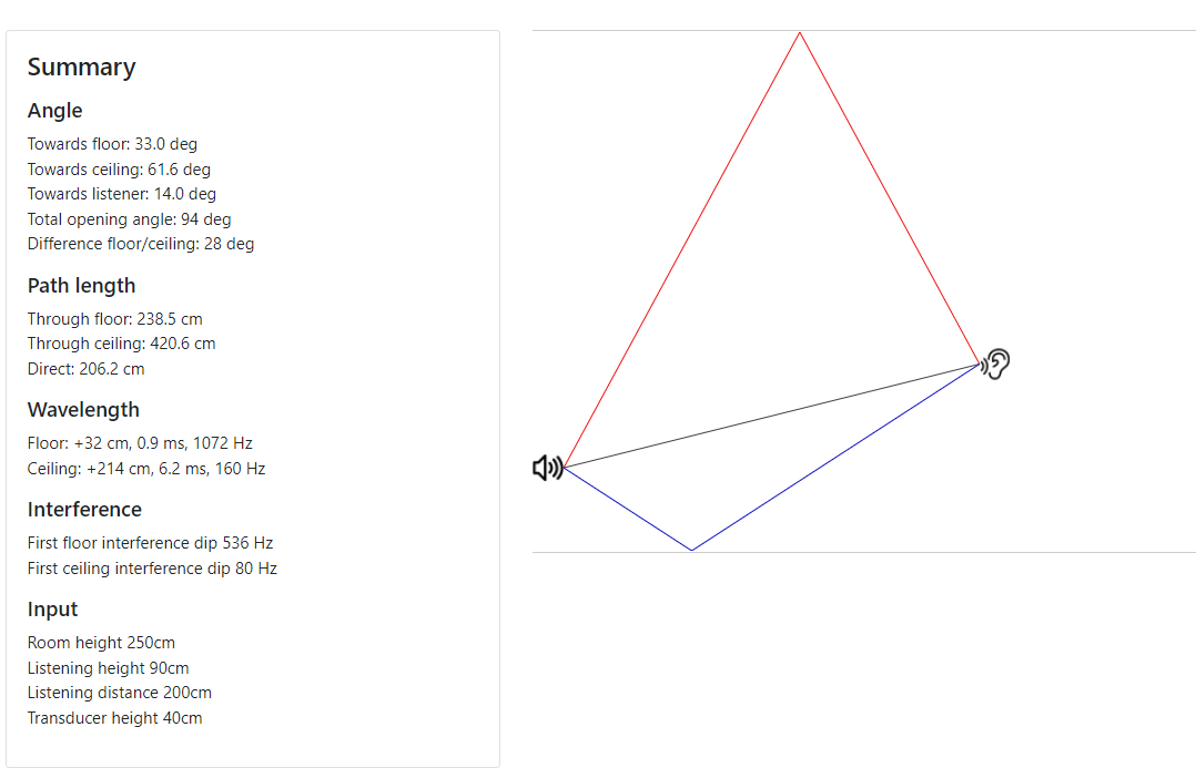

There is direct sound + six first reflections from the room boundaries, single boundary won't affect much, it is combination of all. You could measure further away or closer up and see if the dip stays or moves in frequency to determine if it is caused by the floor. All other reflection paths change as well so not so easy. Would rule out the response is indeed from the room and not something inherent in the speaker.
Here is rough approximation of your situation, trying to estimate if floor reflection contributing to the null is possibility. Here is example with 40cm driver height from floor, 90cm mic height, 2m microphone distance from source and the path length difference of direct and floor reflected sound is roughly 30cm, a dip ~500Hz. If measured from 3m distance the path length difference is less and dip is now higher up ~700Hz. You should measure the whole system response though, there might be no hint of 500Hz dip. If there is then worry about it.
