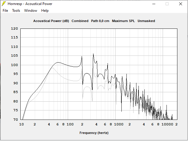

I am happy to announce that we have the solution. David McBean for one reason or another knew what he is doing ahead of the time, and kindof implemented my desired function in the Hornresp, so we can reap the fruits of further analysis together.
For Max power tool, he uses the formula including CosFi on the power, and displays the output based on real heating power of the driver.
Therefore there is nothing easier, than just input 1Watt of maximum power, and compare results as well!
Here is 18IPAL versus Seas A26RE4 in 100l box tuned at ~25Hz:
It can be seen, that 18IPAL, despite having such disadvantages as much stiffer suspension and heavier cone, and higher damping with insanely low Qes, outputs more SPL per 1Watt of real power than Seas, even in bass region.
As mentioned, the massive coil of the 18IPAL will help with progressing the lead with more input power. At the point where the efficiency seems the same, very little power flows in both drivers. It doesn´t matter much, if 10Watts or 20Watts of power flows into the voice coil, because the coil can handle that without much thermal compression. But at 25Hz and ~100Hz with lowest impedance, hundreds of watts will flow, and the difference in heat strain and thus power compression and linearity will be massive.

I am glad HornResp Efficiency/1W (Acoustical Power) plot proved my analysis that efficiency SPL will show valley at tuning frequency, together with peak around the frequency of the second impedance peak - which is especially visible with the Seas 10" driver (grey curve). Efficiency SPL peak at the first impedance peak is very low, because the whole Efficiency/1W graph is shaped by the SPL vs frequency graph (not shown) which is measured with constant 2.83V - at frequency of the first impedance peak there is very low SPL. That is another way to show why we must not equalize vented box lower than tuning frequency.
What is the practical implication of this graph? Look at the 13dB (approx) difference between the valley at 25Hz (where impedance minimum is) and the peak at 46Hz (where second impedance peak is) for Seas 10" (grey curve). The real-world SPL measured with 2.83V (not shown) is flat at 46Hz and above, and only 6dB down at 30Hz. If we try to equalize this (to make perfectly flat frequency response), we must apply +6dB boost at 25Hz - but that is four times more power! In a view of 13dB difference in efficiency, we can conclude: We can not use the higher efficiency of the driver in the vicinity of the 46Hz to help to increase the SPL at 25Hz, so the DSP/IPAL equalization (which OP raved about) can not help in any meaningful way to be "more efficiency green", "low Watt/heath - high SPL", "save the Earth" and so on...

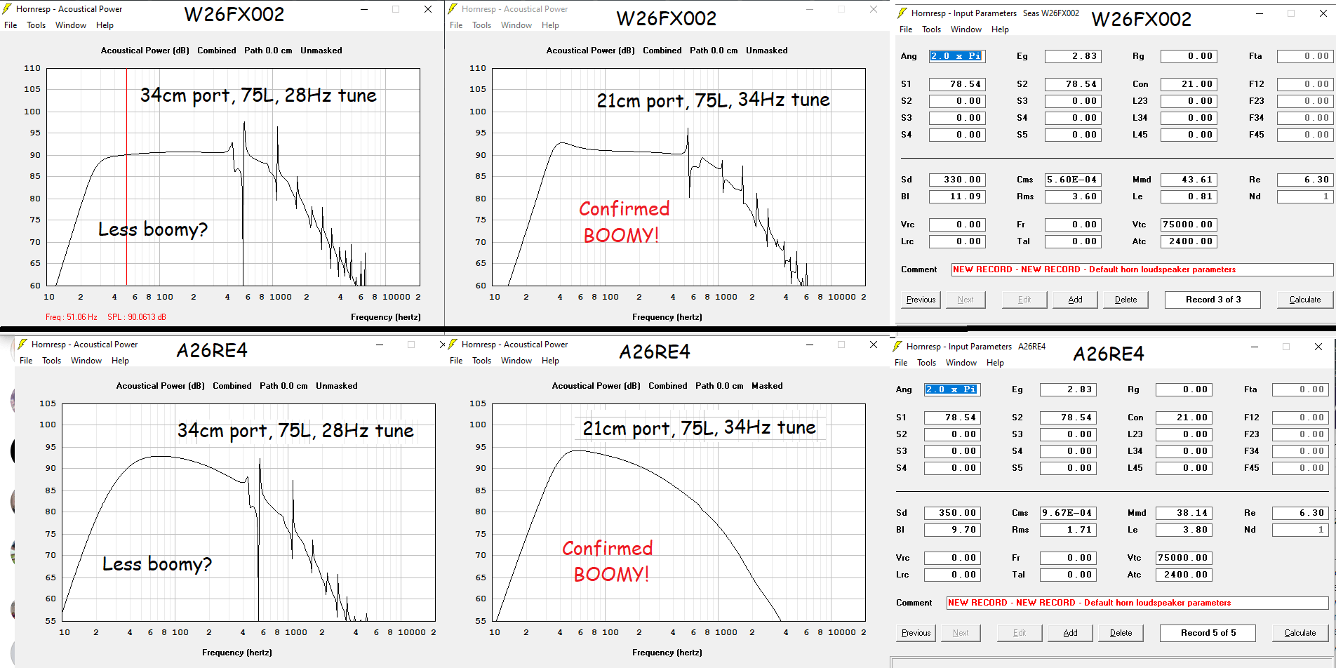

Both the Seas 10" A26RE4 and Seas W26FX002 were confirmed a bit too boomy for my taste:
My ears are still ringing, so something had to be done. I epoxied some leftover tubes and voila!
I don't get to test it just yet, it is night time, but I sure am hopeful. Unless I made a huge mistake somewhere.
The W26FX002 looks great in sims with the new long tubes, so I will measure those first.
