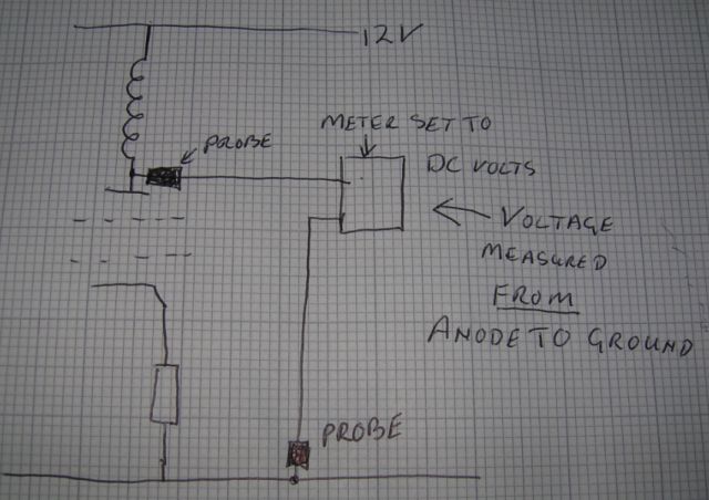

What voltage do you have across the cathode resistor of the 12du7?
You need to be systematic so forget the preamp at the moment.

What voltage do you have from the anode to ground?
Ie the connection from the output transformer to the tube..

Voltage measurement,
Anode to ground..
All measurements through the meter from one point to another..😀
If you click on the picture it makes it bigger..
Then..
Cathode resistor voltage from cathode to Ground using the meter set to DC volts.
Don't short anything out ever..LOL

ok i got a reading of 12v
Ok what voltage from the cathode to ground across the cathode resistor.
Regards
M. Gregg
0 volts..
This is where the problem is at the moment..
The tube is not conducting.
Either the cathode resistor is open circuit or the connection on the output transformer is wrong.
SO POWER OFF
and check the cathode resistor to see if it's OK.
Then post what you find..is the cathode resistor OK?
Remember to put your meter back to DC volts after you do this..
Regards
M. Gregg
ok it has not blown. it reads 330 ohms - what it is supposed to be. it is only 0.25w though so that it the problem?
