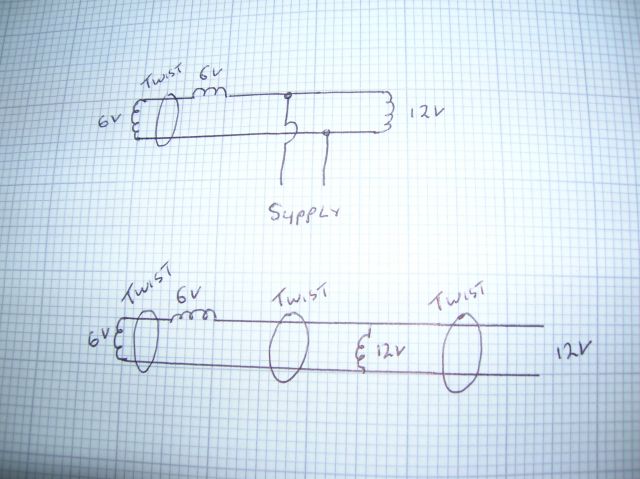

Quick scribble..
Then it depends if they are elevated or Gnd referenced ..

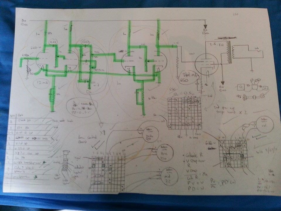

ahh thanks man, i will consider that sometime, for now getting my tube amp to work. all the tubes light up accordingly and my wiring should be good but i am getting no signal. on the output tube, the anode is connected to the 5k primary and b+ is connected to the other primary input. what am i doing wrong? at first i thought it was the speaker and it was in fact the wrong way but still no joy. should i be wiring my OPT different? thanks.
p.s i know how amps work - push pull, not very familiar with SE output stages 🙁
well it is sort of a combo - im using my own knowledge to make the 2 preamp stages and then having a single ended output tube on the other, all ran by 12v (don't worry, the output tube is a space charge tube) let me find a schematic to compare.
Aran
EDIT - it is based off the space charger PP (also on this forum) but instead of PP config. i chose SE but like i said, am having alot of trouble with and actual output stage (i have built it all to a schematic, not the PP output like i mentioned but it simply does not output anything and now the output tube's heater doesn't glow, great!)

If I remember correctly old TV's with valves used to wire the heaters in series with the mains. They probably had a voltage dropper resistor in series too.
yeah, Nigel that's what i figured - if i can run the two tubes in series with the mains, it would work but i forgot that i had jumpered the first tube heater to ground for 6v testing, and so it overvolted as it had a direct route to ground, now I'm trying to wrap my head around the OPT wiring and why it does not work based off the schematics 🙁
Aran
Aran
Aran,yeah, Nigel that's what i figured - if i can run the two tubes in series with the mains, it would work but i forgot that i had jumpered the first tube heater to ground for 6v testing, and so it overvolted as it had a direct route to ground, now I'm trying to wrap my head around the OPT wiring and why it does not work based off the schematics 🙁
Aran
The mains dropper was an old and dangerous idea.
Never try to run any part of a circuit direct from the mains.
The reason is the fault and shock current is not limited and contact even by accident can and often is fatal.
So you should run the heaters from a dedicated supply ie even 12V DC is OK from a supply that can handle the running current.
However the start up current (cold start) can be an issue more with DC supplies and regulators.
So dedicated mains isolation transformers are the thing to use. You can use separate transformers for HT (B+) and heaters and even feed each supply with its own transformer. One for the B+ and one for the heaters and one for the bias supply if you need one.
The other thing is the way heaters are used sometimes means you have to elevate the heater supply eg on SRPP the top tube in the chain needs to be higher reference than the lower tube.
So sometimes you can float the heater chain, sometimes its ground referenced, and sometimes the 6.3 or 12V is lifted with another voltage to keep it above ground. This means that a heater supply is 6.3 or 12V between heaters but can be 100V above ground. So don't just assume that heater voltage is safe if you expect 12V or 6.3.
Another issue with mains droppers was if the heater chain went open circuit the ends of the chain were now at mains potential and that is why old Xmas tree lights were so dangerous. When a lamp failed it put the two wires at Live and neutral potential people thought it was safe because 12V lamps were used ie 20 X 12V = 240V in series each lamp gets 12V until one goes open circuit then the whole chain is at 240V. So people then changed and substituted a lamp unscrewing each in turn and screwing a new lamp in. They did not know they were holding live 240V mains in their hands even children were asked to try a new lamp.
Get the 12V supply working😀
Now if we can have a circuit diagram of what you are doing we can fault find..🙂 even a pen and paper one is OK.
