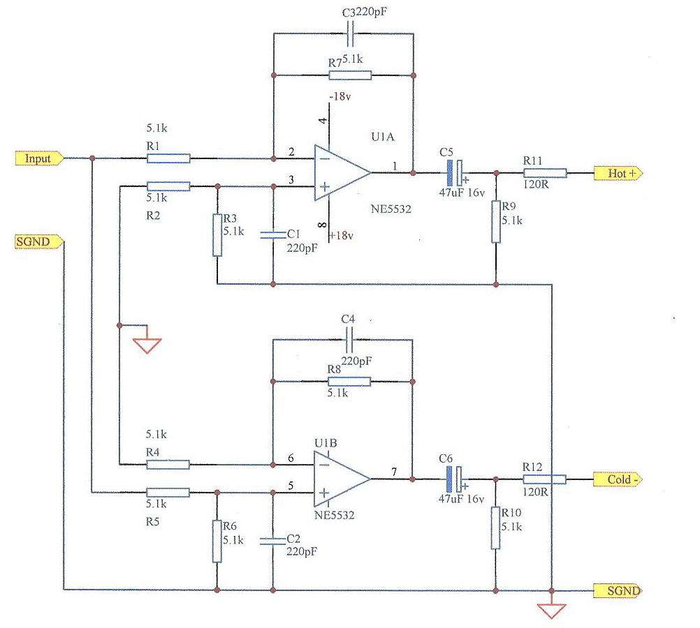

You have to swap the "+" and "-" inputs of the op-amps. Right now you have a positive feedback.
Hi JensH
Thanks for your inputs but I still not sure how to swap the + and - inputs of the two op-amps therefore submitting a drawing will be highly appreciated.

Swap pins 2 and 3. Swap pins 5 and 6. That's all.

Hi stratus
I have revised the schematic. Would you please check it for me?

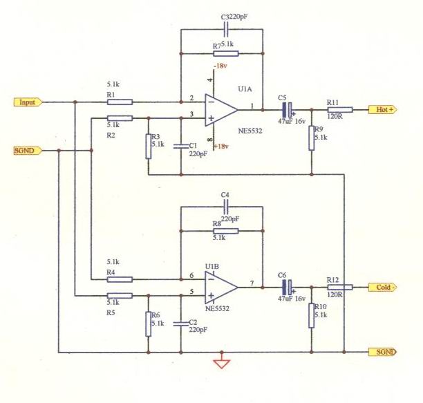

Looks like you nailed it. I think the junction of R2 and R4 should be tied to ground.

Hi stratus
You mean something like this:
No.
The two resistor junction should be connected direct to Signal Ground (Signal Return) in the top left.
The Signal current has to pass into the amplifier and has to pass back out. The current must go around a circuit, back to the origin.
I also suspect that the "SGND" in the lower right hand corner will be mis-wired to the output connector.
As long as you DO NOT connect the "SGND" to the output XLR's pin #1, that part is OK.

Easy answer - NO.
XLR pin #1 is only connected to the chassis.

I should have also pointed out that the circuit's "SGND" buss may be connected to the chassis but probably not at the XLR connector.

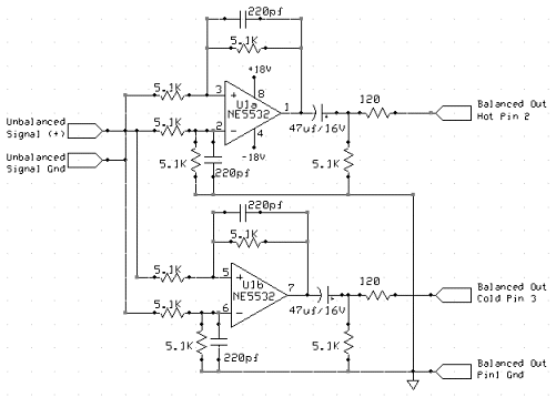

Since the top opamp inverts the input, its output should be labeled "Cold-" (and go to Pin 2 for US wiring of a balanced XLR connector) and the other one "Hot+" (and likewise to go Pin 3).Hi Andrew & Kevin

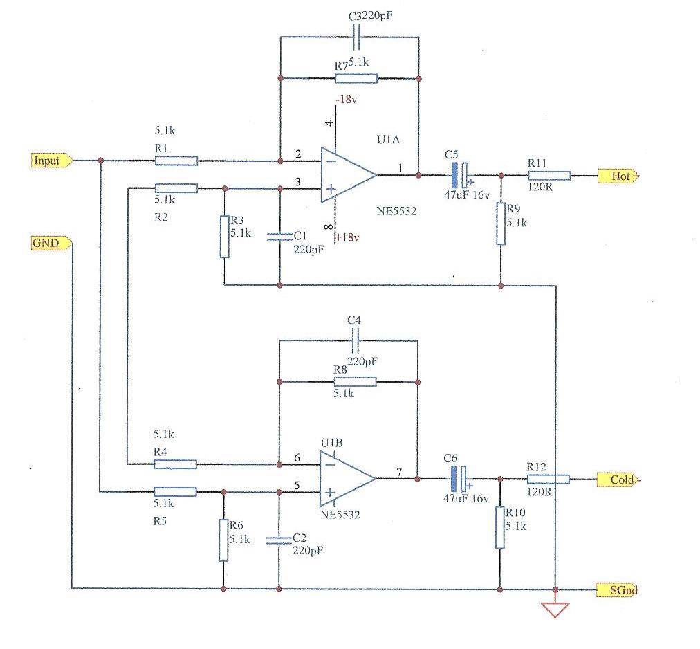

What do you think about this revision:

I just realized I made a mistake in my earlier post. It's too late to go back and edit it, so I've corrected it below in red - pin 2 should go to the "Hot" or positive-polarity signal:
Since the top opamp inverts the input, its output should be labeled "Cold-" (and go to [Pin 2] Pin 3 for US wiring of a balanced XLR connector) and the other one "Hot+" (and likewise to go [Pin 3] Pin 2).

Hi Everyone thank you very much for all your inputs. I still have the following question about this circuit:
What is the different between positive feedback and negative feedback of the unbalance to balance converter we have discussed in this thread? Since the original schmatic of this converter was illustrated with a positive feedback and we have revised it to negative feedback. Is the original schmatic a drawing error? Please advice.

The first schematic will oscillate! + & - inputs are backwards.
