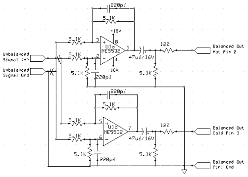

the input on the right hand diagram (correct unbalaned to balanced circuit) has ~3k4 of input resistance. The Source must be capable of driving this and all the parasitic capacitances drawing on the Source's output stage.

Thanks for the giving the information. Will I have any problem if I use this Unbalance to Balance converter to hook up my CD player and the pre-amp? Please advice.
try it, but I am confused by why you think you need to go from unbalanced at the CDP to balanced at the next receiver and give the CDP at harder job to drive the convertor.
What are you gaining?
Try converting the CDP output direct to psuedo balanced. Jensen describes.
Now you can have the advantages of long cables driving balanced input and not need an extra converter and not need to load up the CDP output.

Balanced (and "pseudo balanced," also called impedance balanced) connections solve certain problems, but most such problems generally don't happen in stereo equipment with three-foot-long interconnects.
The noise that balanced lines help with tends to be injected from things such as SCR-based light dimmers powered on a long power cable with a long cable for a microphone or line-level signal laying right next to it.

Is there a SPECIFIC problem you have that you're hoping balanced connections will fix?
