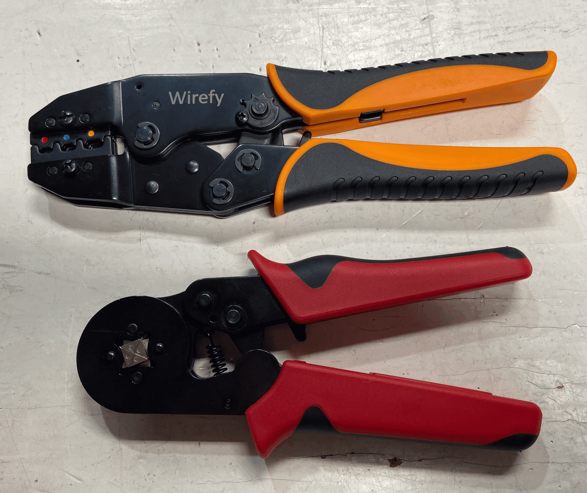

Folks:
Your counsel would be appreciated: I have a Wirefy crimper and a ferrule crimper and both serve me very well. I could also use a crimper for tiny non-insulated female connectors (whose identity I am ignorant of). It appears that Wirefy sells an individual crimping die for the non-insulated female connectors that could be inserted in my Wirefy crimper (see https://wirefyshop.com/products/wir...tm_campaign=Google Shopping&stkn=df0d398c45bf) but, at about 18 USD (plus shipping), it seems over-priced. Would one of the SN-48BS units available on AliExpress (e.g., https://www.aliexpress.us/item/3256....0.0.6e0738da20WgcD&mp=1&gatewayAdapt=glo2usa) serve just as well?

There's literally no way to know. For $5 you could just try it.
I do know that a Molex ratcheting crimp tool does a perfect job on Molex connectors.
I've got that same Ali crimping tool with a bunch of dies for various terminals. It has managed to make DIY satisfactory crimps with any terminal I've tried, so it will probably be ok for those ones (with the correct size of die).
For aerospace work, I use a DMC kit with correct dies for the mil-spec connectors, but the kits cost $$$$ because they are calibrated tooling. And soldering a crimped connection is not aerospace standard, so it's simply not done. In a commercial setting, you should abide by the datasheet of the terminal, using the correct tool.
For home use, the Ali ratcheting crimp tool that cost me about $20 does what I need to do. Soldering a terminal after crimping 'just to be sure' has happened on more than one occasion.... For home use, in a dry environment, it's not been a problem, but perhaps unnecessary if the crimp is good (this is not assured when the tool is an uncalibrated Ali special though).

Ali knock off ratcheting crimper is a good option for hobby use. Even with the correct name brand crimping tool you still need to test by tugging a bit however. Chances are the terminals are different from brand to brand, and that can make a difference.

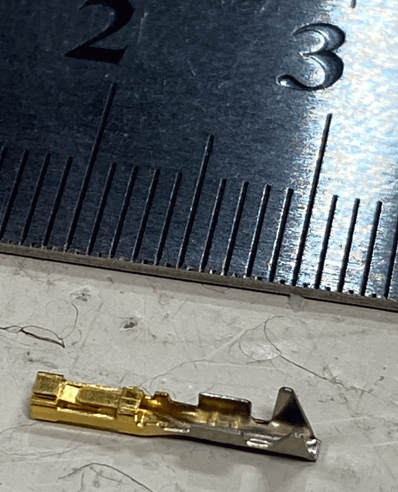

Back to the OP photo......those thin terminals I come across in car electronics...& those wires are brittle....you really need to carefully twist the wire tight to "capture" all the strands before you place it in the terminal to then crimp...I wouldn't solder it to the terminal but I have lightly tinned the wire beforehand to "glue" the strands back together when I've had to repair a connection & don't have much room in the wire to cut back to fresh!

That's reasonable.Back to the OP photo......those thin terminals I come across in car electronics...& those wires are brittle....you really need to carefully twist the wire tight to "capture" all the strands before you place it in the terminal to then crimp...I wouldn't solder it to the terminal but I have lightly tinned the wire beforehand to "glue" the strands back together when I've had to repair a connection & don't have much room in the wire to cut back to fresh!

Ratcheting crimpers are great. You can insert the Spade connector or whatever connector you're using into the tool, bring it to the first ratchet click which just holds it and starts the crimp curl over. Insert your wire then ratchet it the rest of the way. You don't need three hands dropping connectors! Definitely don't strip too long, you need the insulation and wire to line up with both curl over areas separately. The best crimps I've ever done is using silver plated Teflon wire 20 Awg, but I'd use the 22 awg anvil in the crimper to get even more pressure on the deformation. Use heat shrink then. A ratcheting crimper gets more pressure than any plier crimper can.

I went thru the same process, thinking it would be nice to have a crimper which you could get interchangeable dies for, but then started looking at the price of the dies and decided against it (I think I was looking at the same Wirefy crimper that you got). I wound bying one of these instead, and it has worked well for Molex KK, Spox and Micro-Fit terminals that I have been using as long as you are careful: https://www.amazon.com/gp/product/B078WPT5M1/ref=ppx_yo_dt_b_asin_title_o04_s00?ie=UTF8&psc=1 In your case, I might just buy the Wirefy die if you already have the crimper since this one is more than the die costs.
ItsAllInMyHead and Pars:
Thank you! Good advice all around. The crimper Pars suggested is also available at AliExpress (under 21 USD tomorrow, during their Winter Sale), but I'm leaning towards https://www.aliexpress.us/item/3256....0.0.7e6c38daoO53im&mp=1&gatewayAdapt=glo2usa (see the sixth option, model CLB-58B), which will cost about 12.50 USD. At that price, it's too cheap to not test.

Seems like all the crimp pins I get are not sized properly for the wire, the little ears that wrap the wire and insulated part of the wire are to small (22 guage wire) but I never see any kind of selection.
Bill
