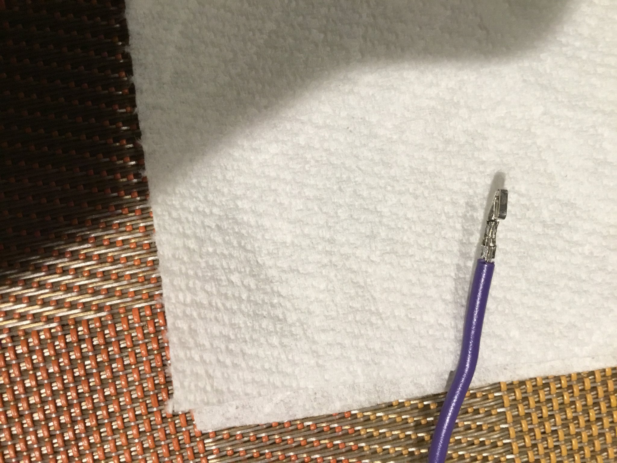

I’ve been stripping back the wire cover all the way so only bare wire is being crimped in, then I solder it. I just watched a video where the person only stripped enough to be crimped in the top set of crimp tabs. The bottom crimp tabs were crimped around the wire covering. Is that the preferred method or is the way I’ve been doing it ok?
Nothing has failed on me and I never leave exposed wire or connectors. This is before soldering.

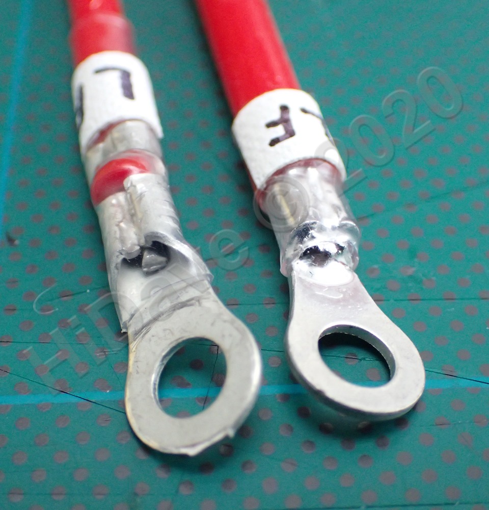

Photo below from when I rebuilt my speakers. The terminal on the left has 2 sets of wings & the wire was tinned & crimped, but not re-soldered. The terminal on the right has only one set of wings & the tinned wire has been re-soldered after crimping. Both have clear heat-shrink, & have been I.D. marked with white tape & a "Sharpie" pen.
I originally made all the speakers internal cables as per the left terminal, but later remade them all as per the right terminal. This to remove extraneous metal from the signal path & to provide a much better electrical connection. The cable terminals are not under any pull "stress", so additional "wings" (strain relief) around the insulation are not required.
For reference, both the cables are silicone insulated, 1000V, “test/measurement” OFC multi-strand wire called “Silivolt-1V” made by MC/Staubli as its highly flexible & soldering iron resistant. The left cable is the 0.75mm CSA version, & the right being their 2.5mm CSA version. The eye is for a M4 bolt/stud connection.
As for solder or not...Most of the time I don't, & it depends on the wire thickness & quality. However, when I want to make a 100% best connection I tin the wire, crimp the terminal over & then place the soldering iron tip on the terminal (crimped section) to melt the solder on the tinned wire. I also feed a bit more solder into the terminal. Then place heat-shrink over the terminal (you might have to slide the heat-shrink onto the wire before you crimp the terminal).

If you know how to solder properly the solder doesn't run up the wire past the end of the last "wing" of the crimp.....therefore not a problem of the wire "breaking".
It all depends on the wire & the crimp terminal used....
The OP wire (as shown in their photo) is thin & the crimp terminal type is not suitable for solder & is solely a crimp as its designed that way with close & solid contact between the wire & the terminal...use the correct crimp tool & all should be ok...
In the wire & terminal combinations that I was using (photo in above post) the terminal was the correct size for the wire CSA.....but you never get 100% contact between the terminal & the wire..& I've known the terminal crimp to break some of the strands of thin multi-strand wire...this is why I tin, then crimp & then solder the above type of crimp terminals...100% contact & no chance of some of the strands breaking off..
