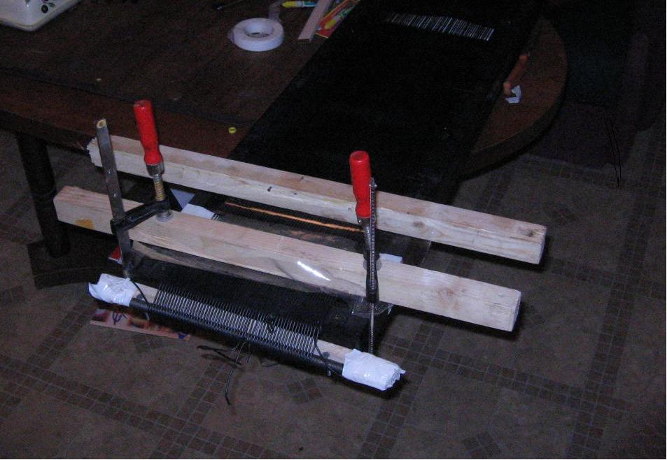

BillH said:Lukas, looks good so far. That's a good idea you had for stretching - simple and effective. Have you seen much flex in the threaded rod?
The threaded rod flexed slightly together with wooden stick.
However , now i see that 9 cm gaps between support points are probably too wide.I don't know if electrostatic force will be strong enogh to bow wires.I am afraid that this effect could cause capacitance to vary , depending on field strength and therefore increase distortion.
I will probably try to divide 9 cm support points into 4 cm ones.

Lukas: That is still a big gap for a small gage wire. Acoustat used 24 gage stranded wire with a heavy build PVC dielectric for thier stator wires (fairly stiff stuff) and chose to use the smallest size commercial egg crate louvre available which is a 1/2 inch open grid (2.5 cm across). I am sure that they looked into larger size louvres before deciding on the 1/2 inch format. With smaller gage wires hand tensioned I would think that you could go up to 3/4 inch cube but the wires will not be as well supported and the grid not as rigid so I don't see any advantage to going larger than a 1/2 inch spacing. Light louvre with 1/2 inch cubes at 3/8 inch thickness make a nice panel. The material is easy to obtain and inexpensive. This can save you a lot of work building your own grid to wind your stator wires on. I use a 30 gage magnet wire (specific type) and find that this works very well. I have used Testers model cement glue, thier non toxic (citrus based version) and also used Acoustat's method and assorted epoxy glues. I have even tried some UV cure adhesives but these are not practical for home based diy construction.

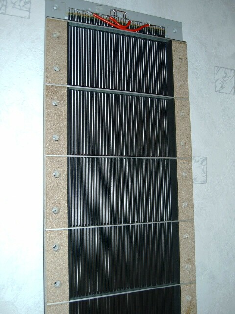

this is a Pic of my first stator.
Used 5mm PVC and 2*10mm aluminium strips. Added wooden strips between the aluminium bars for stability reasons and to have a flat mounting surface. The wires (1.5mm²) is glued to the alu-bars. This gave a spacing of 5mm(PVC) - 2.7mm(wire-diameter) = 2.3mm airgap.
the alu.bars are spaced app. 100m apart which is ok for a wire that thick, but spacing should be reduced for thinner wires. Between every bar and the diaphragm is a soft strip spacer. These thick wires don´t need mechanical tension, so after straightening they´re just glued to the frame.

BillH said:Lukas, I was ready to ask you how large a wire you were using in your last picture. I zoomed in and thought I saw string instead of wires. Is it your wires?
I used 0.8mm diameter(copper) wires.With PVC it is approx 2 mm.
