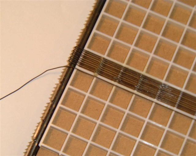

Interious
Sorry for the poor photographs, my camera is an older digital and not very good for closeup work.
The sliding end pieces have small horizontal pegs near the top the same diameter as the Kynar wirewrap .035" . There are 5 pegs /louver opening so 10 wires/louver square.Loop the wire around the pegs at each end then then tighten the screws on the sliding end piece to pull the wires tight.I had the jig built by the machine shop next to my office about 5 yrs ago in return for some computer work.Here is another picture with a white piece of paper in the background so you can see the pins.
I think I would cut up the plastic louver so that there would only be horizontal plastic squares about every 3".I would then glue a piece of PVC about 1/4" wide by .020 thick to this row of squares.That would give me something more substantial to attach the wires to.Plastic PVC glue might work for attaching the wires to the plastic strips.

Andrew--
I see, very clear. Have you succesfully built stators with this jig? How do you execute glue application? I like the idea of enlarging the openings and gluing a more substantial footing on for the glue interface.
Yes--I see it exactly, an excellent idea that never occured to me. I'm trying to think if 0.035" wire (20#) is stiff enough to span 3". The ductile copper seems to loose any tension induced in the wire. What do you think?

Are you able to retain spacing uniformity along the length of the stator with this method?

Dave
No, I haven't built a finished stator with the stretcher.After the first try at gluing the wire to the plastic frame I came to realize that the strecher works as I envisioned it would but there had to be a better way to glue the wires to the frame. So I put the whole thing on hold while I thought this out. I had plenty of other projects to keep me busy .I just started working on this recently again after I purchased the electronics c/w delay lines from an ESL63.
I think that the spacing would remain constant ,if not then maybe reducing the support to 2 " may work.The glue application would be a little easier with the wider supports a plastic type glue and a brush type applicator??

Mmmm...Good question. I would probably use epoxy applied with a syringe and use a heat gun to partially liquify the glue, causing it to flow,
but I'm unsure of bond strength to PVC.
I've only used plexi or lexan for spacers (thinking or your supports) in the past, but the thickness tolerance is notoriously poor. Whether that is audible is a difference question.
The arrangement of you stator/diaphragm spacers will be a consideration.

Excellent idea!I_Forgot said:
If you have a vacuum pump you could borrow a technique from composite lay-up and vacuum bag the assembly to apply pressure while the epoxy hardens. A small diaphragm pump can easily pull about 20" Hg vacuum which translates to 10 lbs per sq inch over the entire surface. Model rocket and airplane guys often use vacuum food sealers for this job.

Dave and all- there are adhesives specifically made for specific plastics. Once you've bought your frame or eggcrate, buy the adhesive specific to that material. Here in California, TAP Plastics and the always-reliable McMaster-Carr are good sources for those specialty materials.
