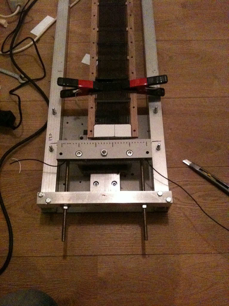

my experience is that the wire coming out of the box as it is has some kinks which You can´t get perfectly straight by just pulling. My method was to fix one end of the wire and to use a drilling machine and pull for the other end. This way the wire became perfectly flat. I tested each wire by letting it roll down on a slightly tilted (10°) glass plate. This way even flat looking devices were sorted out when they didn´t pass the test. While it is a good and typical DIY-method (excellent results but takes too much working time 😉 ) You can only use it for panels with just a few wires. If You want to use thinner wire it ends up in ridiculous time consumption.
I considered the method John.G proposed too, but I like my ESLs to be of an optically open style without cloth etc. so eggcrate wasn´t on my list. Too, with this method You still have something to do by cutting and soldering every wire.

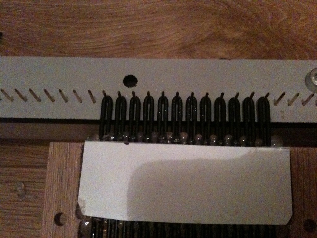

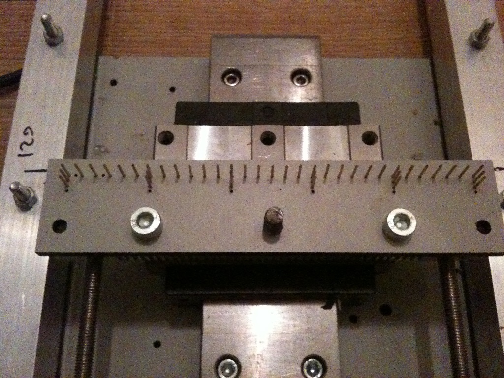

Thats why I thought about a method of winding ´back and forth´ and not round and round´.
I think of a kind of jig with a row of pins at both ends to wind the wire on and to glue the stator frame on the wires.
The wire would come of off the box and would run through a device consisting of several roller dressers (?) with perpendicular (or at least some angular) orientation to each other. Together with the bending this device could supply for the needed and constant pull. When the wire is bent slightly and pulled in different directions every kink in it vanishes. The device could be made up of two or three rollers (ball bearings or just rods with smooth surfaces or those ceramic rings for fishing rods)...so nothing complicated big or heavy.
What do You think?
jauu
Calvin
something like this 🙂 but then it is complicated and heavy 😉 bought a bit oversized linear rail 🙂 but dont need 2 now 🙂 so got one sitting on the shelf haha
