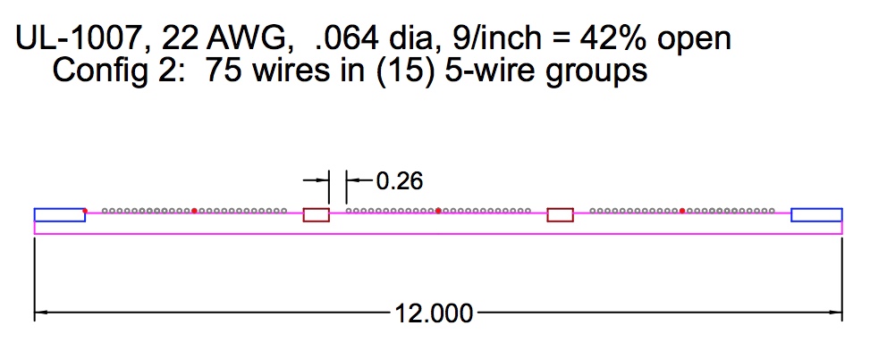

Here's another option:
You could use 22AWG UL-1007 wires in Config 2 with (15) 5-wire groups, and retain the 12" panel width.
Most drawing features could remain the same except the stator lattice slot depths would have to be adjusted for .064 diameter wire, and the pin locations on the stretching jig would have to be changed from 90 wires to 75 wires. Also; 5-wire groups would not return a sixth wire to the bottom of the jig-- so you would have to clip some wires at the top of the stator. Not as easy but still do-able.

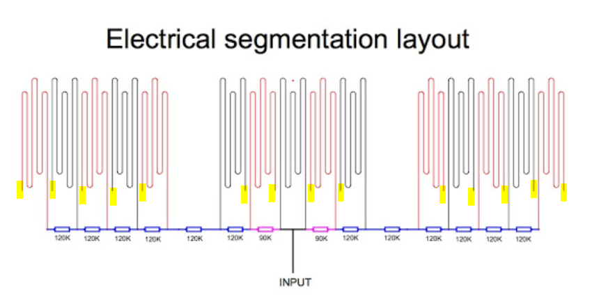

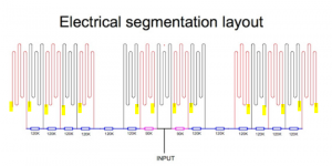

Hey Charlie,
I thought I might continue on our conversation here instead of e-mails so we can benefit everyone. I went through your e-mail and you told me the stators and the diaphragm are essentially like capacitors. I think I roughly understand, but I would love to get some clarity on wiring these guys up if it's possible?

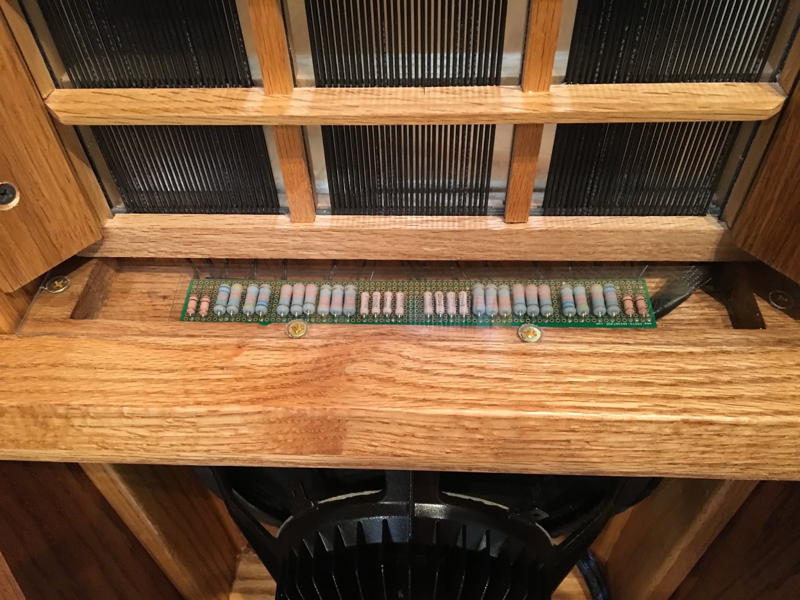

Looking at the electrical segmentation picture (attached, first picture) I still don't really understand where does the other end of the wire gets connected to (those highlighted in yellow). If i understand correctly, they should make a complete circuit and hence be connected to the diaphragm am I right?
Looking at the second picture instead, it seems to me they are connected to the perfboard instead? Would probably help if there are some pictures and markings on the underside of the perfboard. If it's too troublesome, does that mean the other end of wire (where there is no resistor) is just soldered to any of the tabs on the perfboard and they'll still be able to make a complete circuit with the diaphragm over there? 😕
