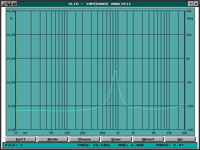

This is an impedance measurement of a Focal Be tweeter (6 years ago)
from car audio program I had used to make a buddy of mine a home DIY
version of an Utopia like speaker, only the rest of the drivers were 21V2
and 5W 4211.
The sound is very refined with this tweeter, but so is with any other good
quality driver.

Well given its price I'd certainly expect better! Those are some serious impedance wiggles at 2.7kHz and 4.5kHz. Most likely poor venting beneath the dome/surround. I always thought that the focal Be domes had too small a motor/chamber going on in the rear shots of the driver for optimum performance.
I am sure it can be made to sound nice.

The \earlier Focal tweeters did not have a vented pole piece, I'm not sure that the new ones are any different?
Kind, not sure if it was a matter of motor changes or case. Wilson's Focal tweeters relied on customization of the rear tweeter chamber. My guess is that the tweeter motor itself was always an open back design, and that they are just making a big deal that they are using a thick piece of particle board to glue together two MDF tubes in the Sopra.
It doesn't seem to do them much audible good though.
