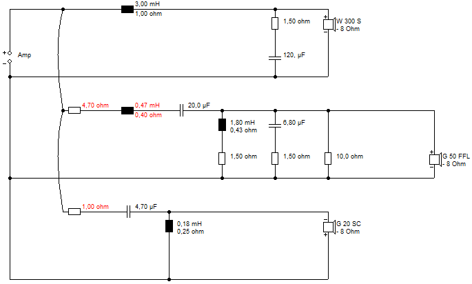

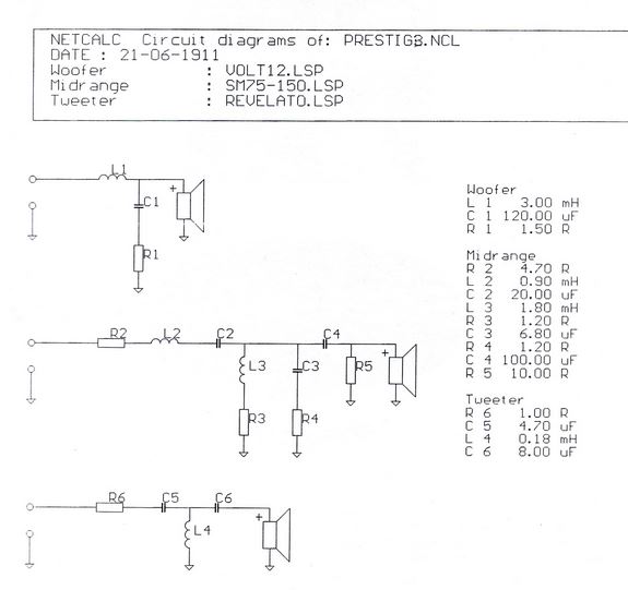

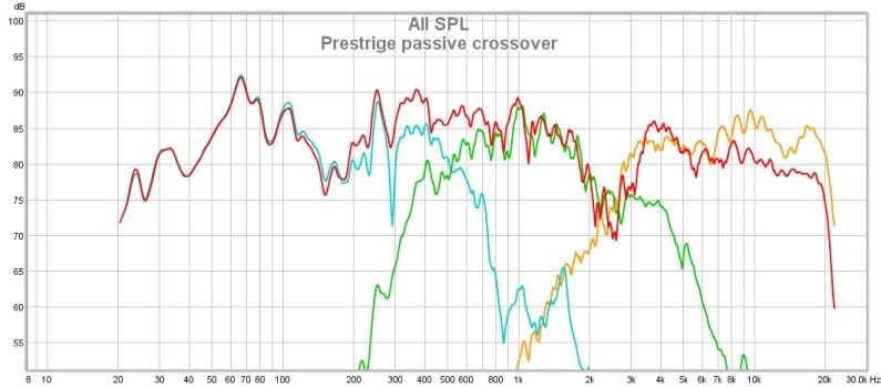

Can't make much sense of the many variations of Prestige being discussed here, but I've been looking at bushmeister's inherited crossover. Here's a review.
Correct polarity is ++-. Anything else is due to inaccuracies in component values.
Problem with Katieanddad's filter was it had too much rolloff on the mid, and should really have a second order tweeter filter for an LR2 response at the top end. Crossing from bass to mid is problematic, because it's near butterworth 90 degree phase difference.
I have a feeling we are talking about ATC SM75-150 16 ohm here. And a ring radiator. Just have to hope the ring radiator works on a second order.
My advice is to lose the 100uF, the 8uF and change the 0.9mH to something between 0.4 and 0.5mH. It will all look a lot better then. Impedance stays above 4 ohms.

In 2013 Wilmslow Audio sent me this in an email:
"Looking back at what we have been supplying over the last few months, it seems that we have returned to using the same crossover for both the Gold and Platinum designs. The main parameters of the two midranges are very similar and although we did have slightly different designs for both, we have found that the Gold crossover does actually produce a better soundstage than our original Platinum design. However it quite often comes down to individual hearing. So if you feel after running them for a while, that the sound needs tweaking, we would be happy to advise accordingly
If you change the tweeter from the Gold to the Platinum unit, you may need to change the resistor value, but again that depends more on how they sound than a theoretical design. So again, see how they sound and if a tweak is required, we would be pleased to advise."
The Gold Prestige used ATC midrange drivers while the Platinum used Volt. The frequency responses for these drivers are quite different, esp at the lower end. I was surprised to say the least.
The Volt wants crossing at about 500 Hz given the 400 Hz Fs and indeed this looks to be about where it is crossed in Bushmeister's plot. The ATC probably wants crossing at about the same place given the small surface area but it often seems to be crossed a 100Hz or so lower. At the top end the crossover frequency should probably lie somewhere around 3-4kHz and it is this that looks wrong in Bushmeister's plot.In 2013 Wilmslow Audio sent me this in an email:

Have they confirmed that the supplied values are correct or just that it looks like one of their crossovers? The high pass for the tweeter and the low pass for the midrange are clearly not aligned with the latter looking to be at about half the intended frequency.I have been in contact with WA and sent them a picture of the crossovers. They have confirmed that these are the correct Prestige Platinum crossovers.
Did they see the frequency response? If they did and have replied that these are correct crossovers then that would be extraordinary.
