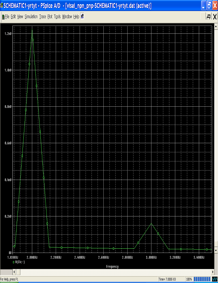

if basic tone is 1khz, then 2nd harmonic is 2khz, is the 3rd harmonic 4khz? What we call 3khz here?

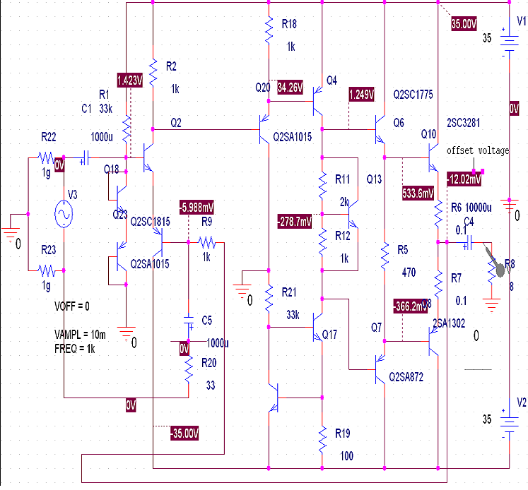

Nice gift you have. What is the need of C4=10000uF?
Your FFT is only from 2khz-3.4khz, very narrow. What is the FFT for wider band?
Is the idea of "Differential Replacement" Q1-Q2 really works as a "non-harmonic cancelation" input stage?
Is this better than singleton input like JLH?

Just observing your gift. Very clever of you, arranging Q1,Q2,Q18,Q23 like that. Dont need servo, but consequence is you have put C5. Is there any possibility not to have C5 / DC coupled in your gift, but still having good DC offset stability?
Is your gift has a "non-harmonic cancelation" properties like my first drawing? Will your wider bandwith FFT similiar to Dad's in post #34?

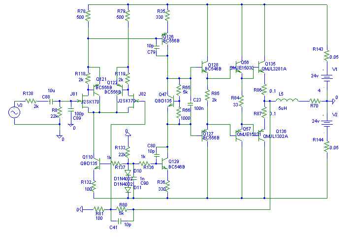

Is that JLH design is trying not-to cancel harmonic?
Is it the fuse that cause it? How come? Whats your design like?
If i remember JLH right, its very asymetrical, so it shouldn't
cancel out even harmonics. Maybe should simulate ?
The resistance in the fuses (~0.05ohm measured) creates
an asymetrical ripple in the voltagerails. That creates even harmonics.
The design is simple. One diffamp with jfets + bjt-cfp, fed with
ccs, then VAS, and finally "tripledarlington" output, but the
driverstages classA'd. Schooldesign with cfp, optimized
for bandwidth, and very low THD.

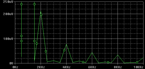

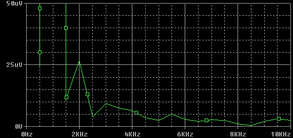

With the 0.05ohm at output 16volts into 4ohm, it generates
200uv 2nd, and 15uv 3rd. (1khz)
Without the fuses (or compensated) it makes 30uv 2nd, 10uv 3rd.
Have to try if it sounds different.
I will post some schematics later this evening.

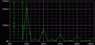

Aah, now I see the difference between single current path input stage (like Dad's FFT #34) and differential input stage (asymamp1_fft2.gif). In single current path, all harmonics, even and odd, are following the same pattern, decaying in the same pattern.
In differential input stage, the odd and even harmonics has their own decay pattern, so it look like mountains. So, this is what differential pair do to harmonics.
Mike, the low odd harmonics in your cct is caused by CFP differential input, isnt it?

The low odd harmonics are achieved by two things:
1, yes, the CFP. Its not only good for linearizing, it boosts the gain
of the diffamp. Openloopgain of the circuit is ~1:625000.
Its a wonder it doesn't oscillate.
2, the asymetrical design. With symetrical design 2nd and 3rd
harmonic would be exchanged. (like fft1, but exchanged)
The even harmonics in fft2 are generated by the "weak" supply.
I had no time yet to check if it sounds different if i remove this
"weakness".

Oh! about 800MhzWhat is the FFT for wider band?
🙂 I see that this thread is paying attendtion for 2nd and 3rd so I post the picture which only has 2nd and 3rd
Oh! Do you try? I have not yetIs there any possibility not to have C5 / DC coupled in your gift, but still having good DC offset stability?

I wanted to see the harmonic pattern. Is it smooth like #34 or have mountains like Mike'sI see that this thread is paying attendtion for 2nd and 3rd so I post the picture which only has 2nd and 3rd
You called -12mV quite high? How many amps have you built? You must appreciate -12mV😀 --- I just afraid that prototype doesn't as beautiful as SIM.Because offset voltage is quite high,I think
