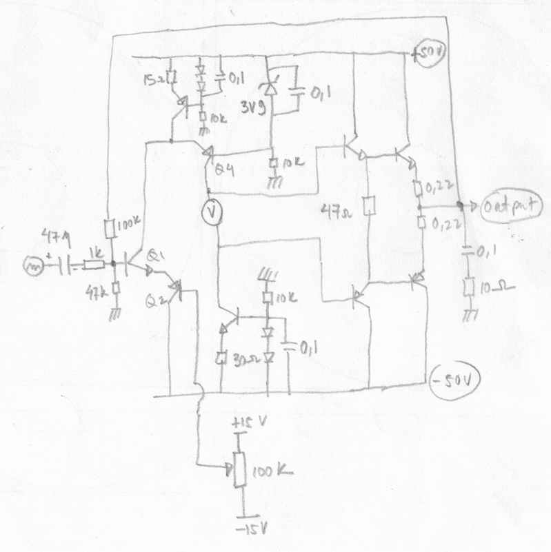

Will this work as audio amplifier?
lumanauw said:
My design has already NFB, with 100K feedback and 1K input R, hasn't it?
Bad output stage, eh?😀 How about parrareling the output device, will it help?
or do you have simpler solution for the problem you found, but please not so difficult as putting Hawksford error correction.
Damping factor is a dissaster. What is the sound of audio amp with dissaster damping factor? Bad bass?
No, your design is a classical feedback. NFB means No FeedBack.
This means you have a 1cap + 1 resistor connected to the input,
nothing else. NFB is openloop !
Paralelling output devices reduces the effect, but does not solve it.
The sound of bad dampingfactor is bad bass, and bad frequency
response. As a speaker does not have a linear impedance, the
frequencyresponse will show the same curves. Bad bass means
too much of it and totally uncontrolled/unprecise. It can destroy
you speaker !
Mike

Sorry, wrong assumption about NFB. How to maintain DC offset? Servo? My servo design is not working. How to make servo for this design?
FAB,
I just experimenting with CFP-Jfet/Bipolar differential (like Mike use) and single mosfet differential (IRF510). The sound of mosfet differential have "something" that sounds better. You should try this.
Don't give up ! 🙂

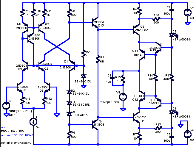

Hi All !
I'am really intrested about this thread !!!
I also have a project to build an amp with these
solutions like CFP stages, cascodes and so an...
I attach a version of my design, its based on
peufru-s site and on memory distortions.
Its only a copy-paste design at this point, but
soon i will built it, and make some listening test !
I readed a lot of docs about this kind of solutions in
power amps but there is a lot of confusing oppinion.
Please write your opinion about my amp !
For example this kind of CCS is the better or the
cascoded type, like at peufru-s site ?
And imho it would be an intresting test to try out
drive your test-amps in inverting mode with high
values of the feedback resistors, ~ 1Meg and 33k...
And i'am waiting impatiently for the real listening
tests about MikeB's symmetrical CFP input stage too ! 🙂
Thanx a lot !
Cortez

Re: Don't give up ! 🙂
Cortez said:
Hi All !
(NFB ?= Negative FB)
Welcome Cortez !
I am not familiar with the peufeu, but your design looks good to me.
The ccs-driven buffer after vas is always good... But i tried in sims,
a "normal" VAS followed by a classA-predriver performs better.
The classA-predriver seems to put nearly no load to the vas.
The diode at the emitter of vasinput seems suspect to me.
Yes, i am waiting impatiently for the real listening too, but i have to
solve this instability before.
NFB = negative feedback, oops ! :ashamed:
Maybe NoGFB ? 😀
Mike

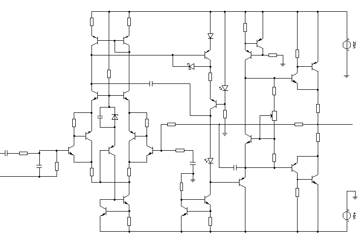

If you want cascode & push-pull vas why not:
In addition to being easier to read because I used .gif (or .png; please, please don’t use jpg for schematics), I think the diff pair cascoding shown here is simpler that the “mike.jpg” schematic in post #135 – ac bootstrapping the cascodes to the input common mode V can help too
I did throw in the kitchen sink on the vas section though; 6 power mosfet source followers are going to be a fairly large capacitive load so I think a large current multiplication of the diff pair’s current is in order ( = complemetary darlington vas)
I’ve also shown a compound cascode with a Baxandall Super Pair for the cascode transistors, the sim seems to be happy with the C2,3 bypass (DC bootstraped R16,17) but anyone embarking on cascodes of any flavor should be good at rf debugging
The vas output is the collectors of Q11,12 – I’ve left out the output stage V bias and was playing with the load Z and V4 ac source to get an idea of the current source output impedance and linearity (I don’t like the idea of throwing away gain by adding shunt Z to ground in the amp though)
The sim seems happy putting out +/- 150 mA with the distortion looking like the classic diff pair tanh spectrum (even harmonics supressed to ~ = amplitude of odds), pretty independent of frequency, looks the same at 2K and 20KHz
(default LtSpice zeners top out at 15 V, the BD139/140 models are from fairchild)
LtSpice file, change .txt to .asc

Hi, all,
The main idea of this thread is this design. I was exploring, what its like to have a SS amp that do not cancel harmonics. So I dont use differential at front stage, but using configuration of Q1 and Q2 to advoid cancelation. It works, if base of Q2 is held by -1V2, it will perform signal depended current path, that feed the folded cascode--->who drives the final stage. Folded cascode VAS doesn't have gain, it just level-shift the current produced by Q1-Q2 to drive final stages.
