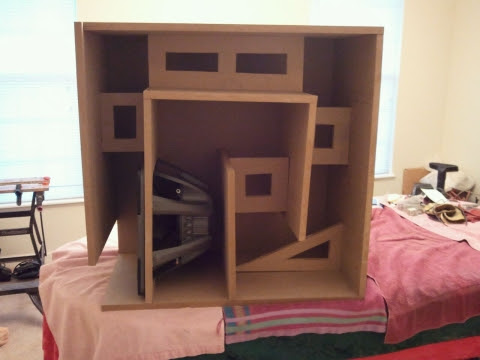

Will this driver in the Tapped Horn configuration?

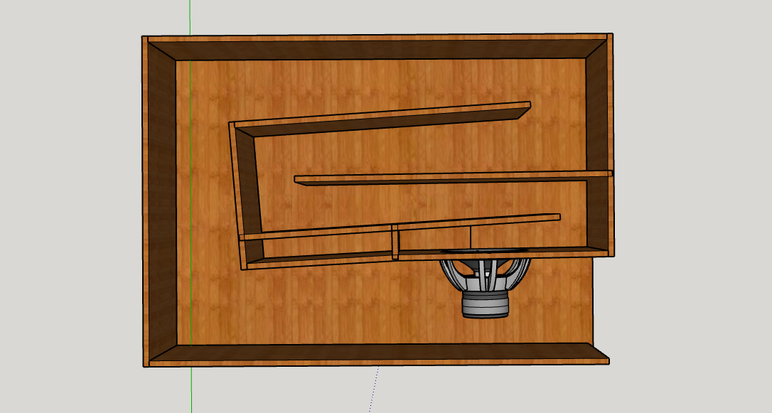

And this is how it is gonna look like in wood:
attachment.php
Cool! I tried to find a fold where you would not have any wasted space. But, sometimes you gotta do what you gotta do!
Yeah. Will calculate segment areas and the length of the horn one more time and see how it deviates from unfolded sim. I think i grasp the idea of calculating distance with centerline method (well, if i read about it one more time). But do i have to measure segment area in each of the fold and enter new values in horresp sim? I guess, i will run out of segments, since i have 5 folds. I guess AkAbak allows to use unlimited amount of segments in the sim?

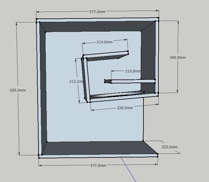

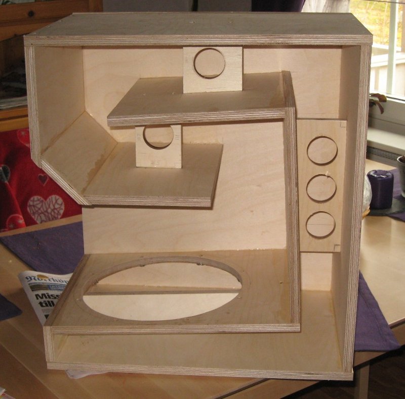

You have to break up the horn path into sections. Double folds are normally 4 sections. You can use a MTH (pic 1) or THAM (pic 2) type fold.
A 10ft horn = 4 x 30" sections.
If your expansion is going from 4" to 12", then your four 2" expansion paths look like this....
Section 1 = 4" to 6" rise for 30".
Section 2 = 6" to 8" rise for 30".
Section 3 = 8" to 10" rise for 30".
Section 4 = 10" to 12" rise for 30".
Height = 30" + 0.75" (the 1 internal perpendicular panel) + (2 external panels x 0.75") = 32.25".
Depth = 4" + 12" + 8" + 8" + [(3 internal panels + 2 external panels) x 0.75"] = 35.75".
Width for a 12" sub = at least 12.5" + (2 external panels x 0.75") = 14".

I was able to get a nice and flat model out of BOXPLAN-OTHORN.
Here is how it models in HornResp:
Looks in spreadsheet:
A nice surprise was a group delay graph, which was a lot lower than in my model:
The downside is low end - it is only good to about 28-30Hz.
Any way to make it longer in the spreadsheet and still be able to optimize the folds? I would really like to tune it to about 19-22Hz.
FWIW, the HF corner is governed by its effective upper mass corner: [Fhm] = 2*Fs/Qts'
Acoustic path-length: [Fb or Fp] = SoS/4/frequency
Qts': Qts + any added series resistance [Rs]: Calculate new Qts with Series Resistor
Qts' = ~0.774
Fhm = ~2*33.65/~0.774 = ~84 Hz
Fp = ~34400/4/19 Hz = ~453 cm S2-S3 or S4
~34400/4/84 = ~102 cm divided between S1-S2, S3-S4 or S4-S5
~453+102 = ~555 cm total length
