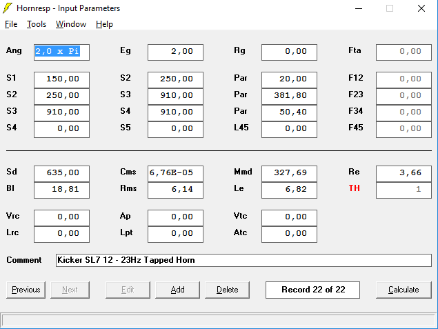

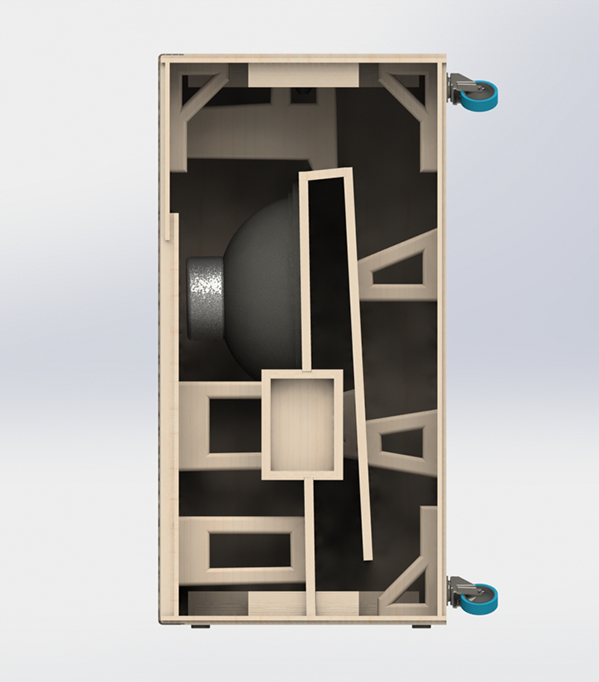

Considering the high Le of that driver, the semi-inductance parameters should definitely be included in the model. Those will change the response at the higher end of the passband by a bit.
Not only that, if using red LE, the tendency to tune lower than one might otherwise for a Qes/Qts is now subject to doubling or more. If Le/Re is <> 1.0 <>. The impedance plot and driver data will show this. However, the red LE has proven itself to be a very legitamate tool when green or black werent. Thats up to the layout and everything involved. and simply put, its just another way, like a person uses an easy acoustic shape but then adds a Re to a Qms change unpurspose. i aint gonna win that or sell it. Just suggesting it in leu of one way or another in regards to application in HR sims of higher order or higher loading or offset pressure phases as a differntial on a cone.
As per Brian's advice, i asked manufacturer to supply detailed t/s parameters of this driver. And - yes, Le is included in the model, as can be seen in the screenshot.
Le is the value of the driver's inductance at one particular frequency, usually 1kHz for subwoofers.
Unfortunately the driver's inductance is not a static value - it varies with frequency. And with some subwoofer drivers, this variance is significant enough to appreciably alter the frequency response in comparison to what's predicted by speaker models that don't take this into consideration. The extra "semi-inductance" parameters can be used to take this variance into consideration, to produce a more accurate simulation.
Very few manufacturers, if any, quote the semi-inductance parameters. However they can easily be derived from the driver's impedance curve.

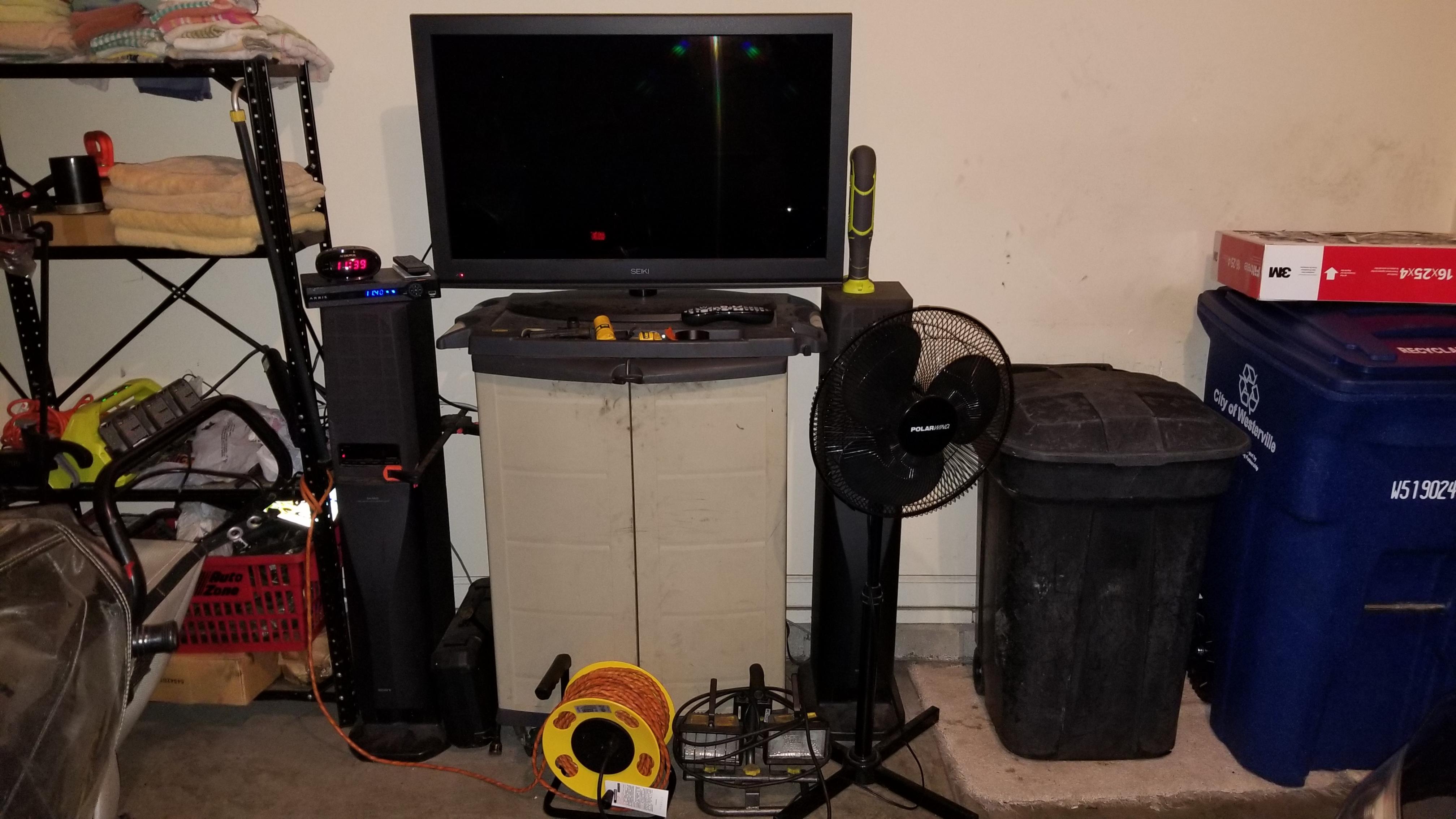

The garage has Sony towers with a built in Dolby Surround amplifier and 5.25" BP6 subwoofers. I remember getting those speaker off of craigslist in the early 2000's for $50 to go with a 1997 Sony 53" rear projection TV. I could never get the TV to control the amplifier or vice versa. I think I needed 1 model up on the TV to control those speakers. I got rid of the TV last April when I upgraded to the 55" TCL in the basement.
That is interesting. BTW, the first Google result for term "semi-inductance parameters" is your post at parts-express' forum.
I will definitely try to derive those from that speaker a bit later. In an earlier post you said it affects the upper end of the passband. Is it still a concern if i intend to cut it at 40-45Hz at the upper end?
BTW, when crossing a TH, is LR24 a good type of filter? Coming from a car-audio world, i crossed everything with this type of filter.

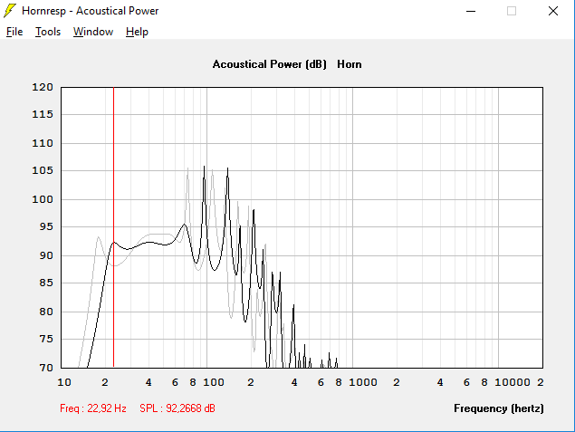

I think i found a sweet spot for this driver. Here is how the expected result looks compared to the previous sim (which basically was just a scaled version of the leaked SPUD design):
attachment.php
I've lost a few Hz of LF extension, but gained flatness and SPL. Oh and the spike at around 70Hz is a lot weaker.
Now, if only i could fold those horns as easily...
The LR24 is down -6dB at the filter point. For the LP filter that may be what is desired, but for the HP (low cut) filter a BW24 (down -3dB at the filter point) will not cut as much at the low corner, better for getting the last few Hz of extension out of the sub without running into excursion limits.

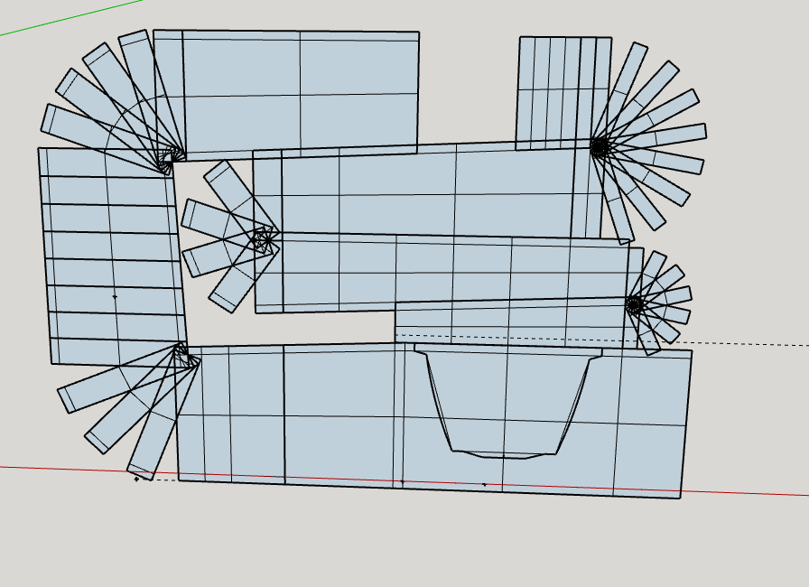

This is what i am slowly coming up with:
attachment.php
Since effective distance and volume is gonna be off in the folds due to them being of rectangular shape rather than an arc in the plywood version of this speaker, how do i account for that in the HR sim?
