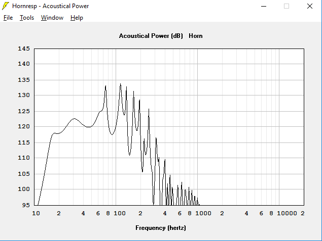

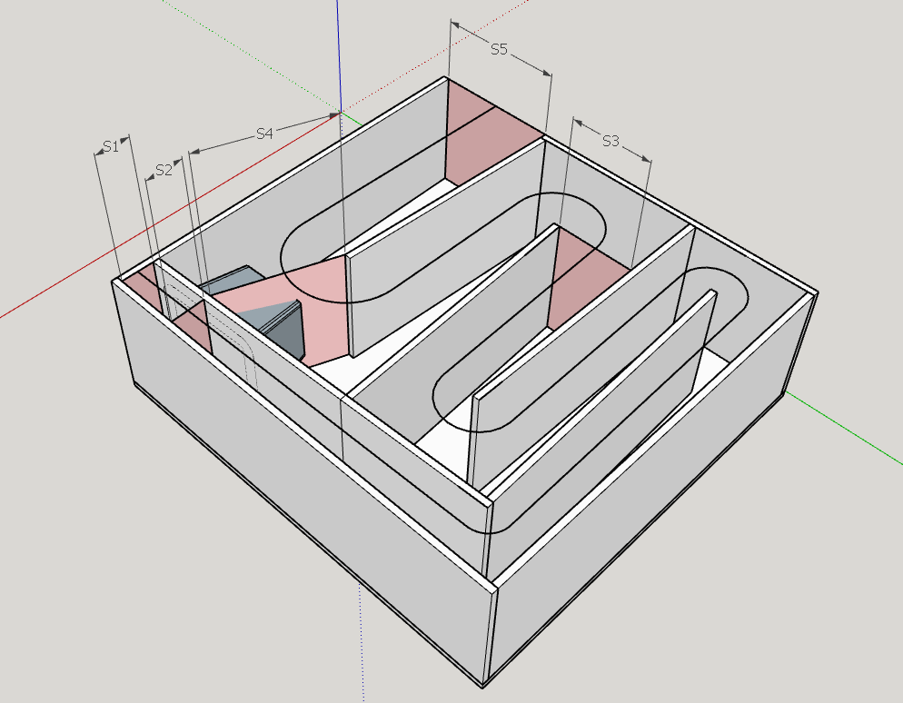

So i have this Kicker L7 12" subwoofer laying around and i thought i'd use it in a TH fashion. So i took the SPUD 'leaked' drawing and adapted them to my application by basically making the box wider and accommodating the placement of the driver.
Here is how it looks like in the Sketchup:
928730d1614947092-hornresp-jxfambc-png

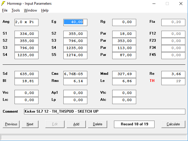

Here is the Hornresp input:
attachment.php

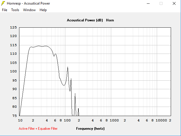

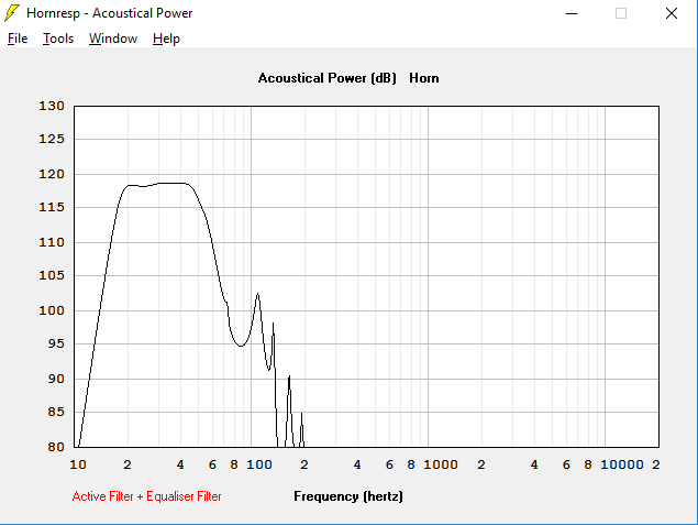

Power response with no filters or EQ:
attachment.php

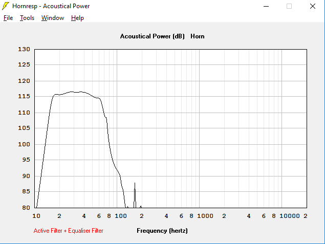

Filters and EQ applied:
attachment.php

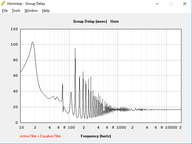

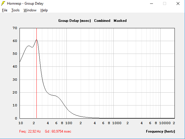

GD graph:
attachment.php

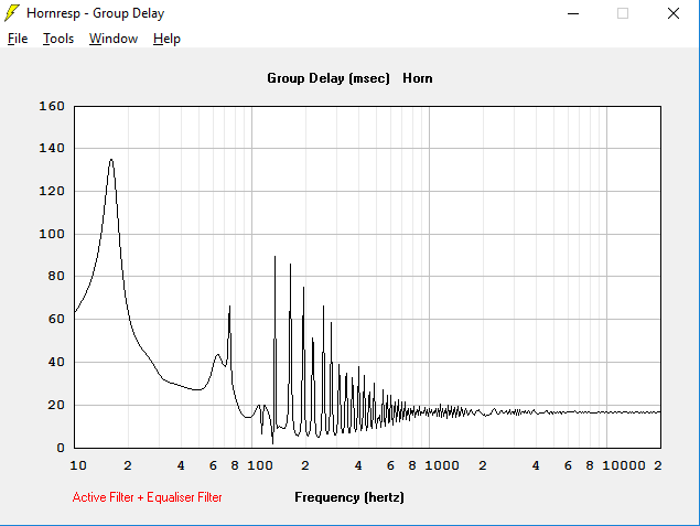

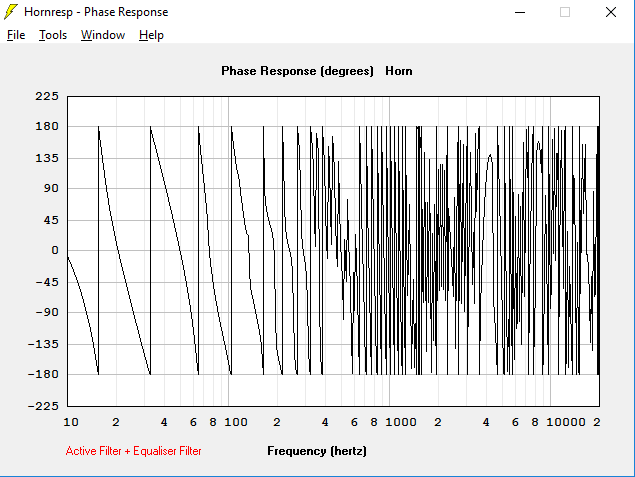

Phase:
attachment.php
When looking at the power response with EQ and filters, seems like this driver can be very loud in this configuration. But when looking at GD and Phase, is there any hope that this sub will not sound like a lot of mud?
The same driver in a 90 liter vented box with the same low corner would have 180 degrees of phase shift over the pass band.
If delay equivalent to the path length is inserted in the TH sim, you should see around 145 degrees of phase shift over it's band-pass, the multiple phase "wraps" will go away.
The TH should not sound like "mud", though there may be some ringing noticed if used above around 70 Hz.

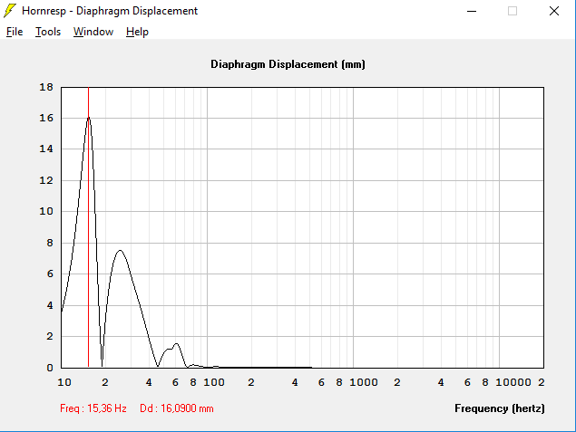

Looks like the L7S12 Xmax is 16.25mm, what excursion does it reach in your sim at 40v input?
As per Brian's advice, i asked manufacturer to supply detailed t/s parameters of this driver. And - yes, Le is included in the model, as can be seen in the screenshot.
Well, i will be using it with my K-402-MEH replicas and those should be good down to about 40-50Hz.
I first thought that xmax of this driver was 20mm, but it is in fact 16.25 as it is confirmed by Kicker's support.
It can take 32V with xmax reached at about ~15Hz

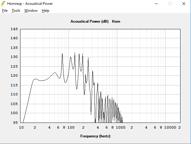

I can also source Alpine 12 SWRD2 for cheap.
Here is how it models with and without EQ/Filtering:
attachment.php
attachment.php
attachment.php
GD seems a bit lower on Alpine than on Kicker. But ringing is comparable.
A few questions:
- When designing a tapped horn (or rather trying to fit drivers in an existing design), what one should be concerned about the most? Group delay, huge peaks, smooth frequency response? How much is too much for parameters like group delay or peaks?
Can you elaborate a bit more on this - are you implying delay between sub and "mains" or some other type of delay that can be modeled in HornResp?

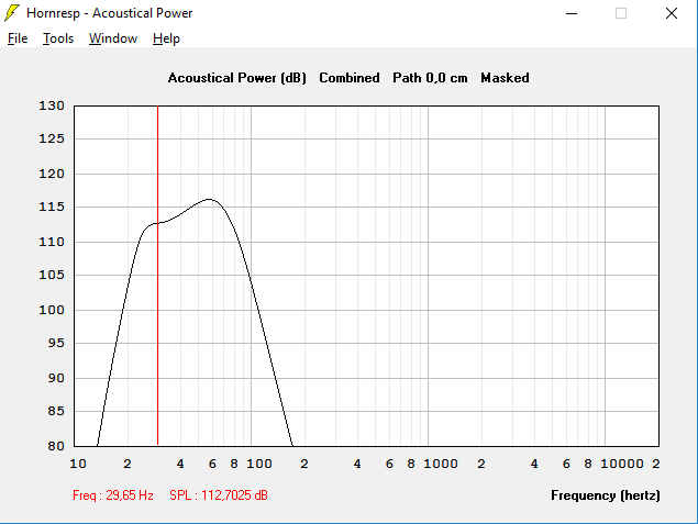

You mention one driver here, and your sketchup model seems to have about the right amount of space in it for one driver, but your Hornresp input screen shows 2 drivers in parallel - are you sure this is correct? (If so, that seems a pretty high compression ratio - are you sure these drivers will be happy with that?)
I'm not a tapped horn expert by any means, so I could be missing something here myself, but I wouldn't want you to build it then realise it doesn't perform as expected just because of an oversight like that.
D.
Hm, yes, that is a huge mistake on my part. Need to correct that.
With correct sim, this driver maxes out at about 113dB:

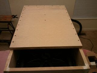

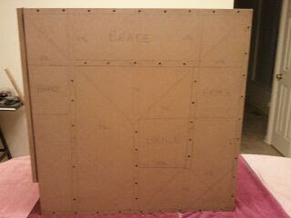

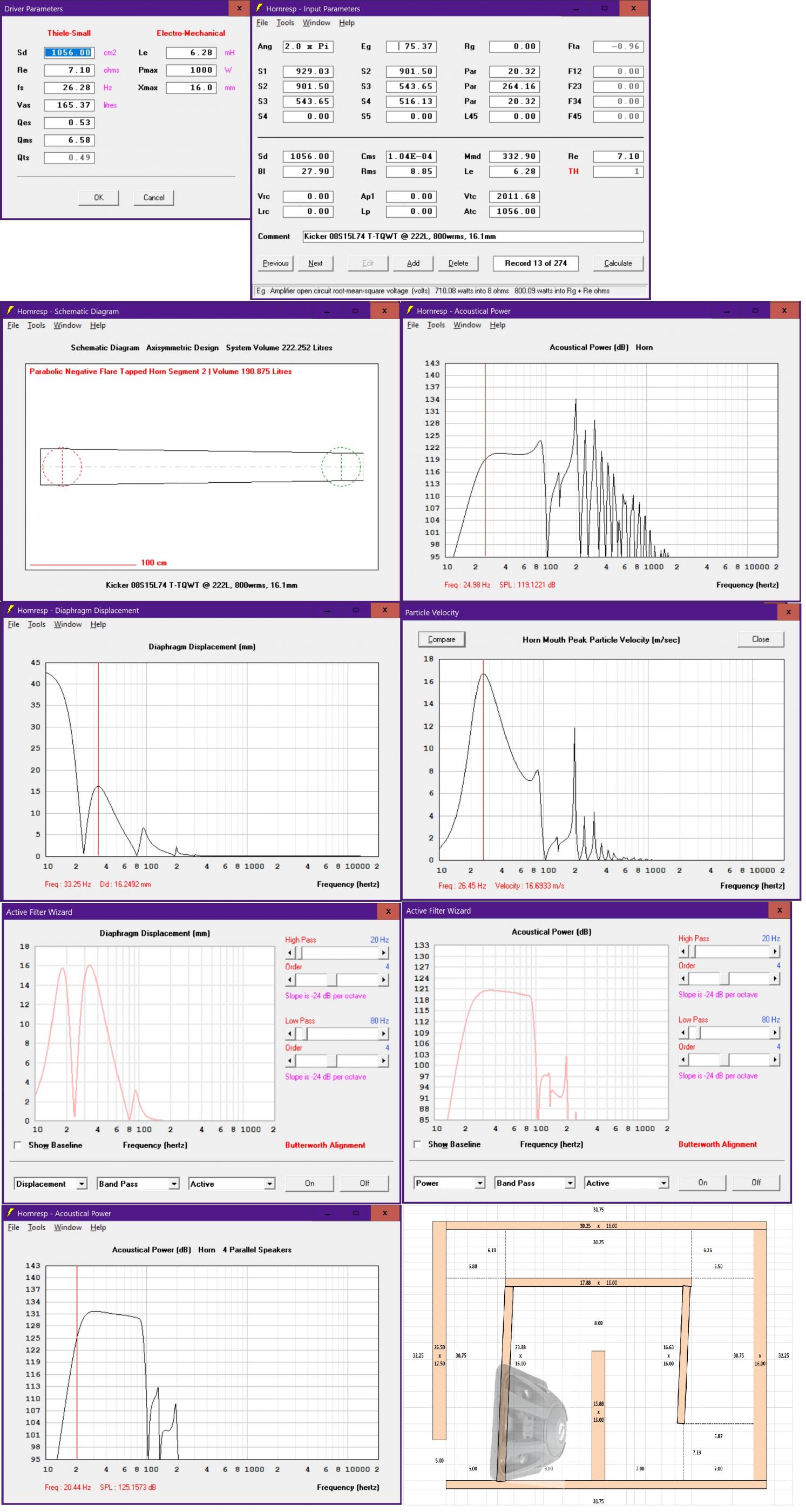

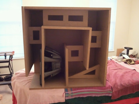

Here is my 08S15L74 in a negative flare TH (T-TQWT or T-TQWP).
Smooth, as in lacking a "saddle" shape between the low and high range of use is good to shoot for, but usually room response has so much effect that the shape of the response is not critical as long as you have DSP to work with. Deep (more than 6dB) narrow dips should be avoided in the pass band, as they may not be correctable- can't fix a phase cancellation within the horn.
Auto Phase in Hornresp may pick the wrong delay settings. The delay time should be roughly a negative second for every foot (30.48 centimeters) of the horn path as sound travels 1130 feet per second.
Group delay and phase won't be representative until subtracting delay equivalent to the path length, see posts #12-16:
Simple Tapped Horn Tutorial using Hornresp | AVS Forum
You should also apply filtering a few Hz below the lowest excursion minima (Fb), excursion above that can be as much as Xmax permits, but excursion below Fb is a mostly a waste of power and results in useless flapping noises ;^).
Your sim in #4 could increase level by 6dB by using a slightly higher filter.
Also, you can put two drivers in your tapped horn, the DTS 10 would be a good example of how to do it. In the DTS 10, one driver is reversed and also connected reverse polarity.
