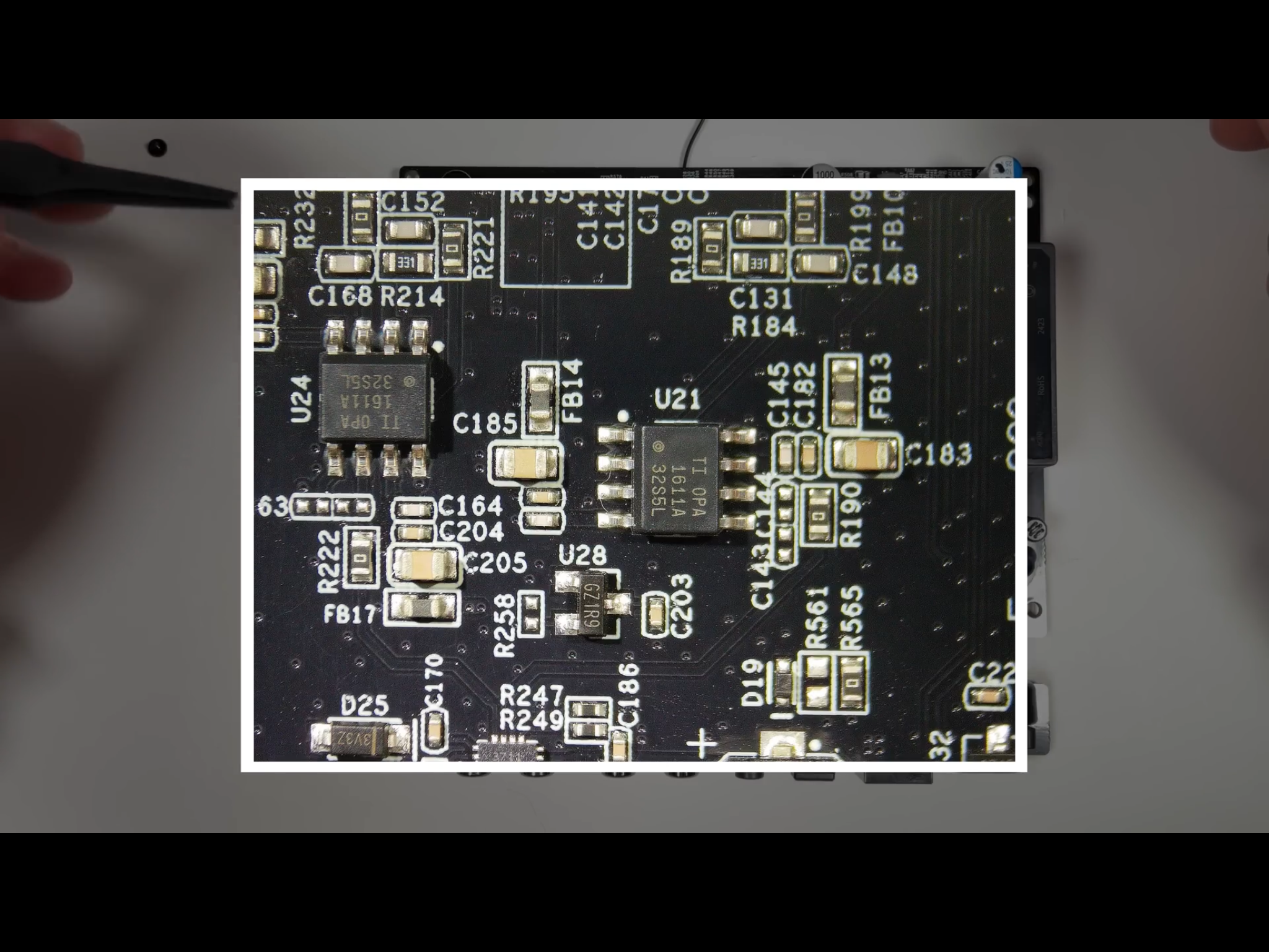

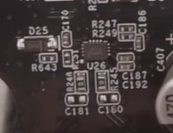

2 Resistors of 0 Ohm as it is now. Normally 47 Ohm suffices but 100 is certainly OK. No ugly/unreliable constructions necessary, just replacing the 0 Ohm resistors that are on the right spot where they should be. Also we meet the dreaded muting-IC (SGM3710?) of questionable reliability again. I have dealt with defective ones a few times and the suspicion is that these die from ESD on the RCA cables so try to avoid touching cables when disconnected.

Putting two zero resistors after each opa 1611 is not good practice , agree .
Wouldnt it be a good idea to take the left and right signal right from the + out leg of each of the opa:s 1611 , with a series resistor of 47 ohm and a series polycap 2.2 uF , cut the + lead of the rca connector and solder the capacitor directly to that + connector ?
bypassing the dreaded muting IC completely ?
I think you don't want to omit good working muting (yet). Maybe the SGM3710 has undergone a revision that makes them more sturdy (that is what I wish to think how things work and they sometimes do work out that way 🙂). Maybe it is not SGM3710 but a newer version as there exist a few types by SGmicro. Apparently there is no need for output caps as they are lacking in the design. Including them seems unnecessary and the best coupling cap is no coupling cap.
On paper SGM3710 seems adequate but I'd rather not see them in devices 😀: https://www.visvie.com/static/upload/file/20220121/1642747164583685.pdf
Agree, but the 1611 will oscillate with zero ohm resistors if using high capacitance rca cable - so the resistor mod of 47 or 100 ohms is absolutely nessessary. Easiest done using the inside of the rca connector of the cable at the source end .
Users of power amps like hypex ncore and others without DC protection on the input should beware of the risk without output capacitor .
No not easiest and sloppy. Right is to replace R245 and the other one for 47 or 100 Ohm resistors and you are done.
The circuit and the SGM3710 are designed for direct coupling so DC offset should be very low. Knowing is measuring but it would not surprise me that it is about 1 mV. Of course good power amplifier designers and clever DIYers know that about the only useful/necessary place where coupling caps belong is as "DC fuses" so input caps in the amplifier. Just 2 caps are insurance against catastrophe. Having again 2 caps in the Ultra would make the dreaded "2 caps in series" scenario.

SGM3711 (and 3710) have a closed resistance of 11ohms, so the measurements of the output z of the Wiim at 11ohms makes perfect sense. Haven't poured over the DS of the two parts so I haven't seen what differentiates between them
You can just make out '3711' on the image posted above

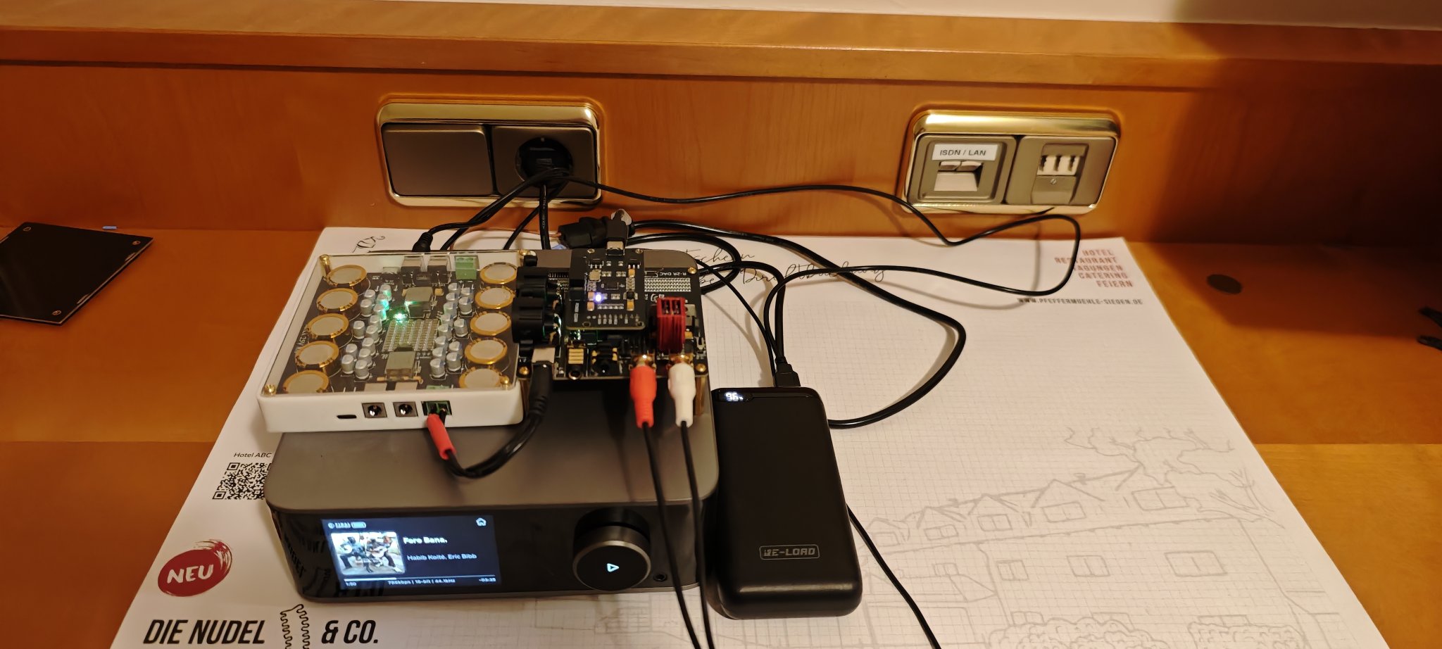

Had it in the Hotel the last week. Test setup as always. External China r2r dac with Burson V7V sounds way better than the internal one, but passive volume control is a must as this China dac is noisy at low level signal. No clean up after LM317/117 might be the main cause.
Sennheiser HD540 Reference II for Evaluation.
