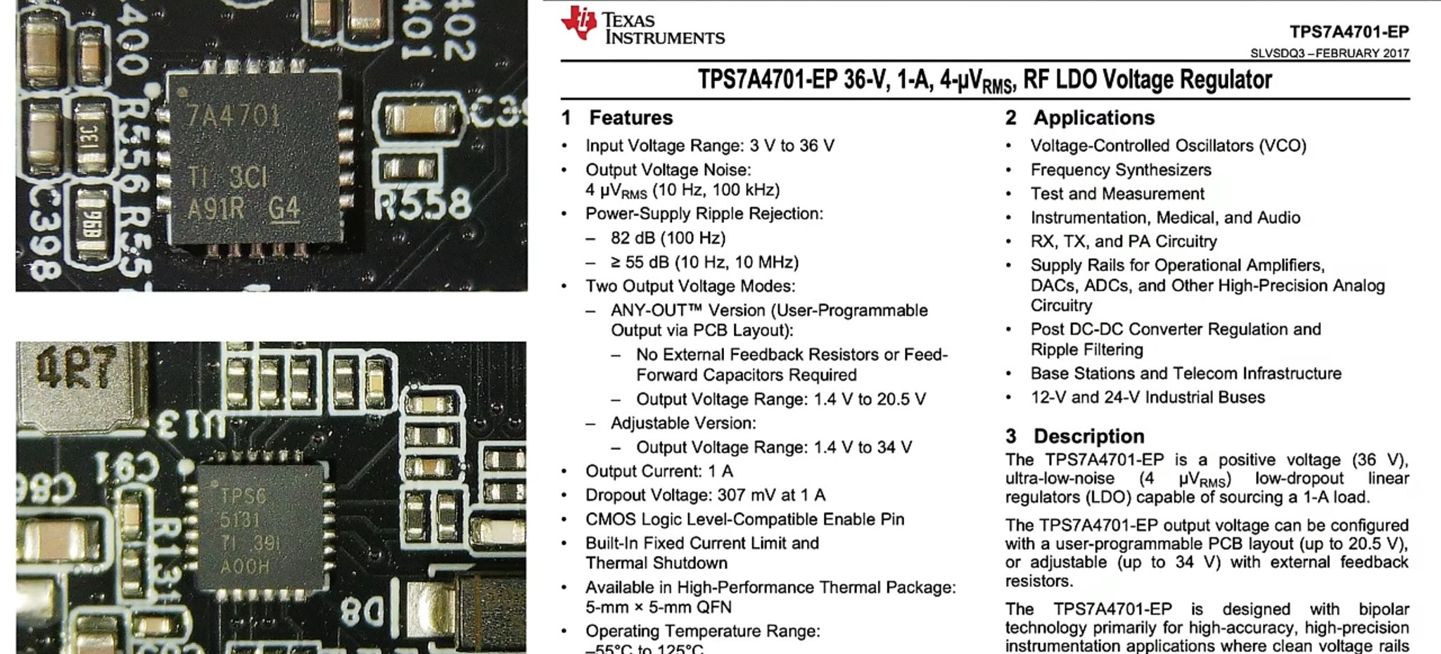

Remember there is a negative rail too. The embedded SMPS just does the +12v. There is an IC TPS6513 that is a dual rail buck converterHi,

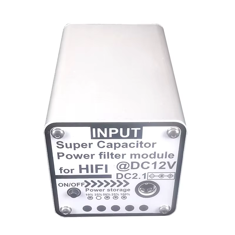

am really impressed with the sound quality from the ultra and agree with the comments made about using a linear power supply.
Have measured the switching supply and it is 12 V DC out and looks same as Mornsun LD20-23B12R2, though no makers name markings on it.
I've removed it and have tried a linear power supply and 12 V super capacitator connected to the 2 pins where the Mornsun output to.
Seems to work ok and sounds a bit better, but am interested if this is the correct way of doing it and wondered what solution you guys would come up with ?

It must be -12v according to the Teddy Pardo PSU. The pos rail uses a Tps7a4701 so not much improving the regulation of the positive.
TPS7A4701 is good.

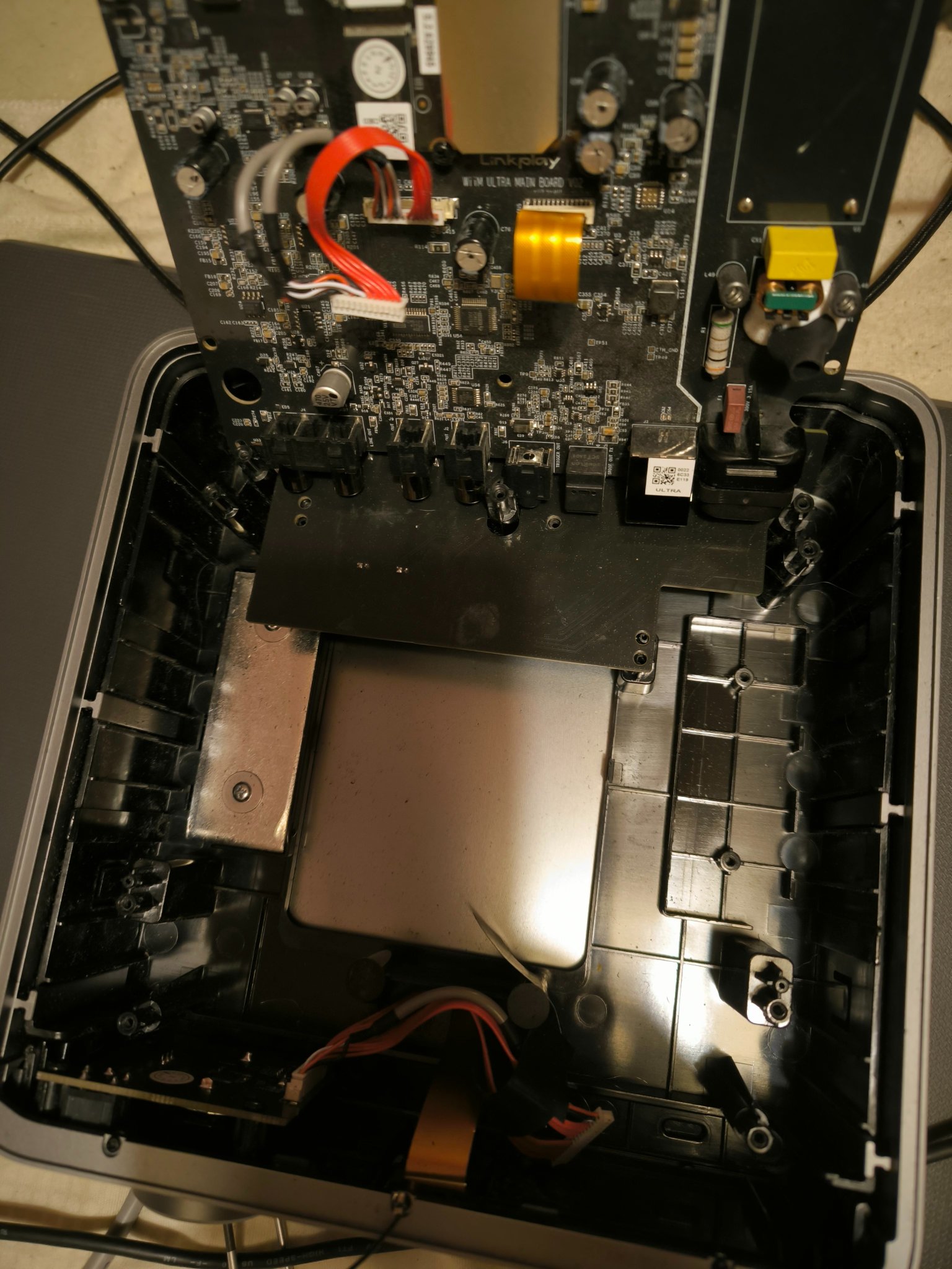

Since I do not have an Ultra people that do have one can measure internal space. I can draw a PCB for a Talema 25VA transformer. It all depends of available space and it sure is tight seen from pictures. When an internal PSU is absolutely impossible then I would not choose the Ultra 😉
Another option as said before is to make a replacement board for the Mornsun but now with AmyAlice filter and mounted upside down.

don't think you'll get the talema in there so would have to have external supply like teddy Pardo or recase the ultra
there's enough space for the amyalice
A 15VA and a 7 VA perhaps? We need to know actual worst case current draw of both rails.
The Mornsun upside down with AmyAlice can be done. Can be small. Then we again need all 3D dimensions. Please remember I am driving in the dark without lights.
Recasing the Ultra is a step too far IMHO. In effort and in cost.

Thank you! Regret to say it but the Ultra is a tad too small. It is pretty impossible to build a linear PSU in it. The upside down switcher with filter may work out OK.

having removed the switcher supply am getting good results with using a supercapacitor, so will stick with that instead of a linear supply
https://www.aliexpress.com/item/1005004856472173.html
