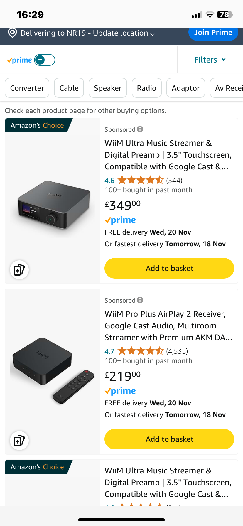

I’m looking for a streamer + decent DAC. I’m no digital expert but do you guys think one of these would work? I would like to get my 500 CD’s onto a SSD as well without breaking the bank.
Feedback/guidance greatly appreciated

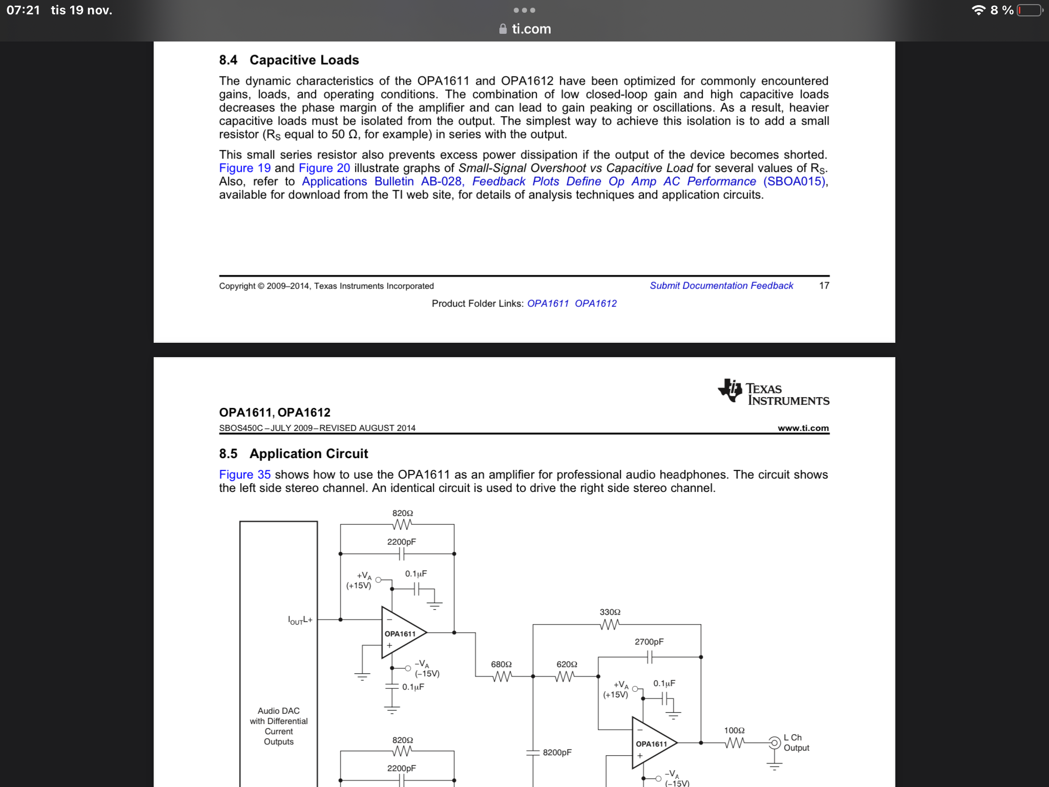

Not sure if changing the sound is necessary but having the normal stop resistor in the output (cable capacitance) of 47 to 100 Ohm is not much work.

About the very low 11 Ohm DAC output impedance of the ultra ( measured by onlyoneme at WiiM forum ) .
One should really solder a 50 or 100 ohms resistor in series with + inside the rca contact in the cable connected from the dac output of the ultra. Without this, theres a risk for oscillation of the opa1611.
