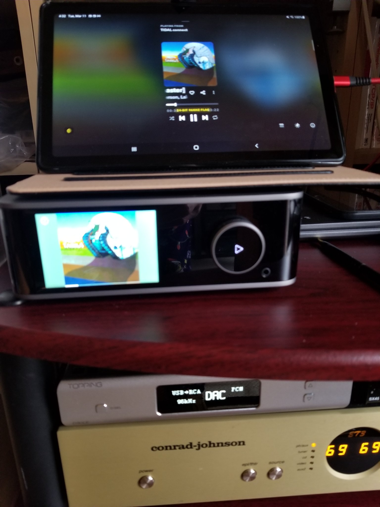

Here's bit perfect, note the 24/96 signal (FLAC)... and the D90 displays the correct bit rate.

See the picture above.
Tidal is playing a 24/96 file and the DAC shows a 96Khz signal. I see the same thing for low bit rates, 44.1Khz and 192 Khz. So, I assume the received data from the Tidal stream is being passed along to the DAC.
I hate to sound like an audiophile, but I was surprised at how much better the treble is with WiiM between the Android tablet and the DAC. It's set up in a rather good system ( tube preamp, F4, AE1s ).
Reactions: Extreme_Boky
As opposed to driving the Android Tablet or Chromebook directly into the DAC using a USB-OTG cable.
I turns out the both the tablet and chromebook are reclocking the signal that goes out USB ( 192K and 48K ),
Android Tablet -- USB OTG --- > DAC ( always 192K ). Sounds pretty good.
Chromebook ----USB-OTG ----> DAC ( always 48K ). Also sounds pretty good.
Android Tablet ---> WiFI ---> WiiM --- USB --> DAC ( bit rate received by the DAC follows the Tidal stream ). Sounds better.
