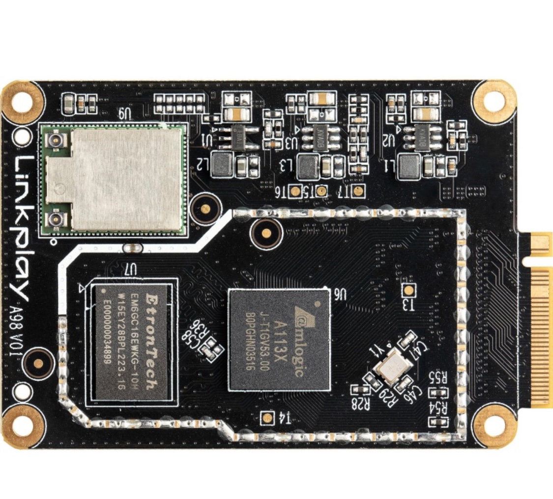

I can’t see any XO’s in the Ultra
Just one master oscillator in core module and the audio clocks synthesised for DACs etc. that explains the low cost and obviously don’t expect great performance from the box. As I see it will be difficult to mod for clock improvements. All the more reason to think outside the box for better performance using external clocks and DACs … the Ultra just as a transport for which it is really great with all the features bundledcan’t see any XO’s in the Ultra

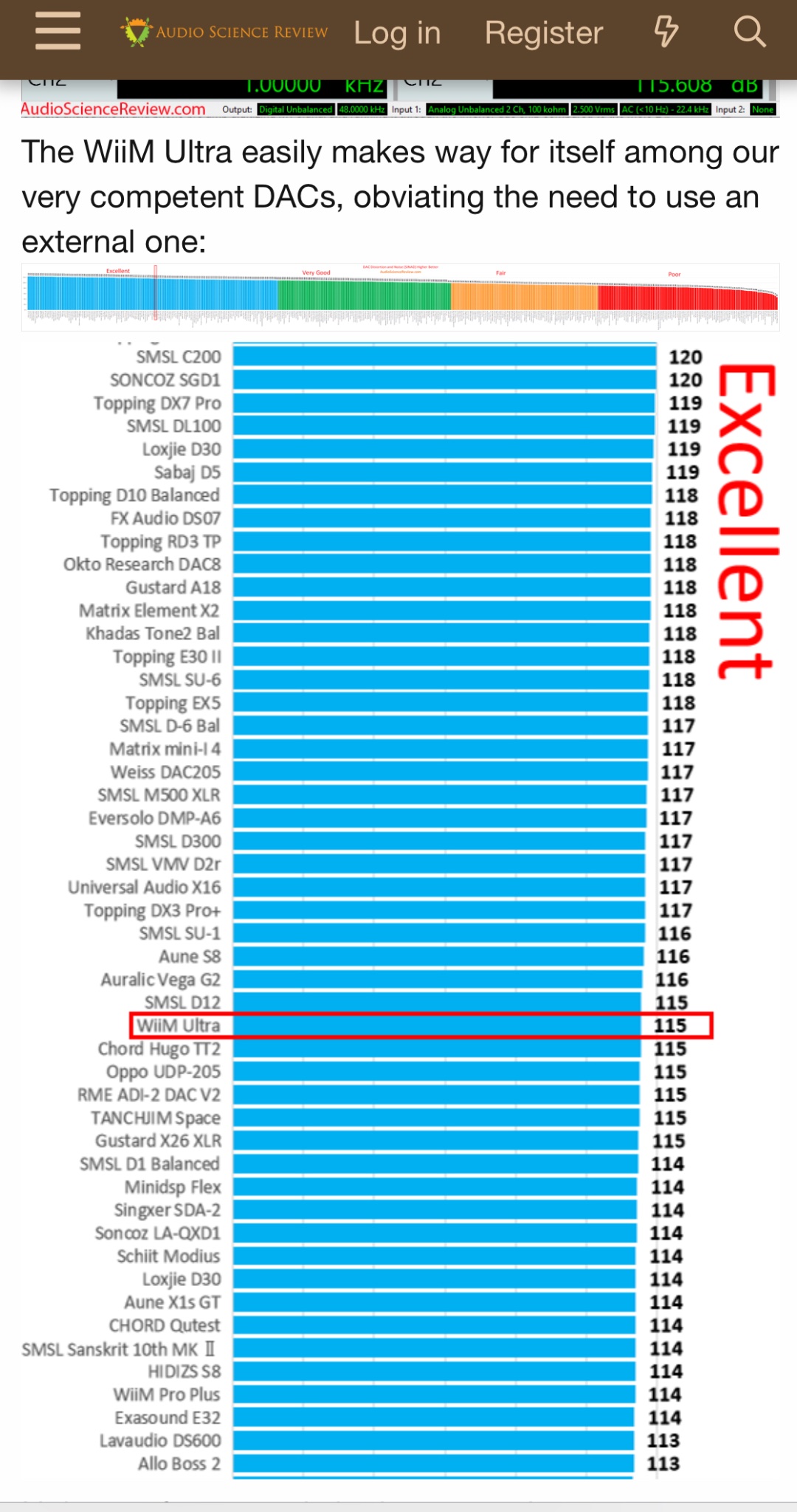

My Rega dac R sounds better than the ultra:s internal dac but measures much worse.🙂Just my opinion the Ultras analog out is ok but certainly not great . Compared to my Marcel Firdac with reclocker the Ultra sounds more messy , sound is forward but really lacks focus , no solid soundstage .
Aya 2 has more depth more organic midrange , I’m not sure how much improvements can be made to the ultras analog out . The biggest weakness for me is the Ultras soundstage compared to either of these other dacs .
The SINAD is 30dB worse.
Ultra uses 4 opa1612 amps at the analog stage costing much more than a top-quality crystal .

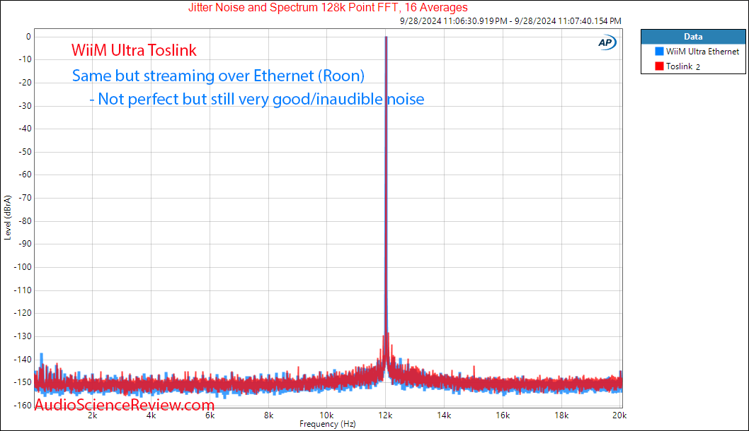

The jitter from the ultra toslink output is very low if we look at the measurements - it can hardly be any better using a better clock , so what is the problem ?
I think many of us hifi enthusiasts wants good sound, and many of us believes that the best, most analog sound can be found using expensive gear that measures very well.
I think this is not true, heck, many of use like the sound from turntables and tubeamplifiers, measuring very bad but makes us smile with all the colorations thats nice to the ear.
No owen baked clock can make the jitter performance audible better than this (picture below).
I believe the sound from the analog outputs on the ultra suffer from other things - its to perfect and needs some colorations to be perceived as ”highend”. The very low output impedance from the inbuilt dac of only 11 ohms makes the ultra sound less ”flowing” than the average cd output of 500 ohms.
To get high end sound, perceived as sounding better , it can probably be done with an extra external buffer with some extra analog mojo after the analog stage using sparkos, line transformers, or a fet input opa1642.

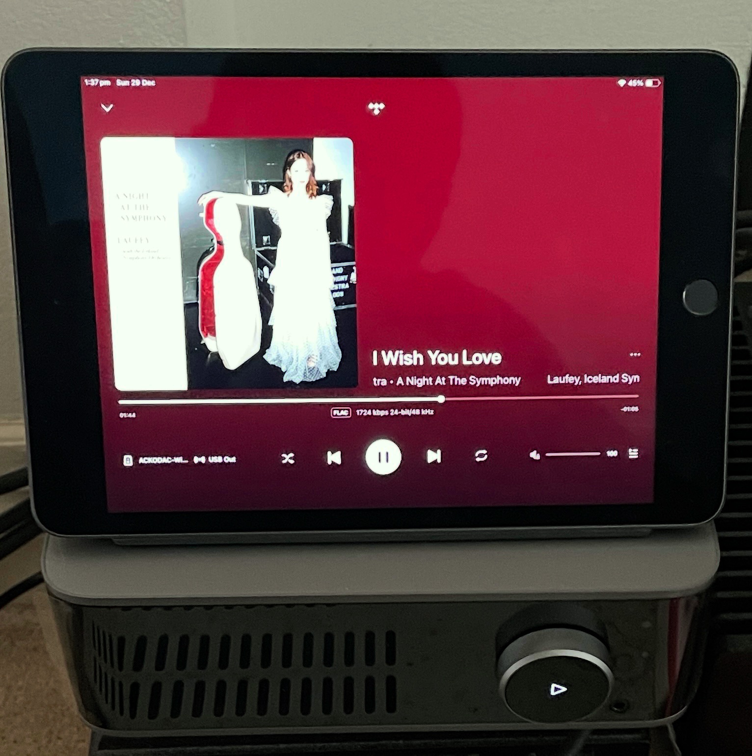

You guys got me curious with all this talk about the Ultra. I’ve wanted something besides a MacBook or iPad streaming iTunes/Apple Music lossless…with and without external DACs.
I have more than one system I do that with …the Dining Room, outdoor speakers for deck/pool etc…no centralized Sonos or anything like that.
I had an ancient Airport Express feeding the outdoor speakers this summer. It was fine considering the use…ambient/relaxation tunes.
I’d wanted something a little better for indoors…especially the Dining Room which we use a lot during meal prep and dining.
I picked an Ultra up over the holidays when they knocked $50 off the price.
Of course it doesn’t have Airplay…so that’s not an option.
I need to figure out what is the best way to use the Ultra as far as streaming music. I don’t have a large SSD with digitized music and only ever used Apple Music.
I think my son has a subscription to Spotify or the like. Any advice as how to proceed?

This looks to be a wi-fi module ? Seems strange to have the XO for dac on there ?Just one master oscillator in core module and the audio clocks synthesised for DACs etc. that explains the low cost and obviously don’t expect great performance from the box. As I see it will be difficult to mod for clock improvements. All the more reason to think outside the box for better performance using external clocks and DACs … the Ultra just as a transport for which it is really great with all the features bundled
https://www.linkplay.com/modules-wifi
Not something new, this practice of generating clocks from a single master located elsewhere and then distributing... e.g some USB Audio/DAC products to keep costs low
Wouldn't be a problem if the ESS dacs had the usual two clock multiples but they use a 100mhz clock to internaly generate the appropriate clock for the sample rate.
I had one ESS DAC that used the usual 22xxx and 24xxx clocks so there must be a register or pin configuration to select this option.
