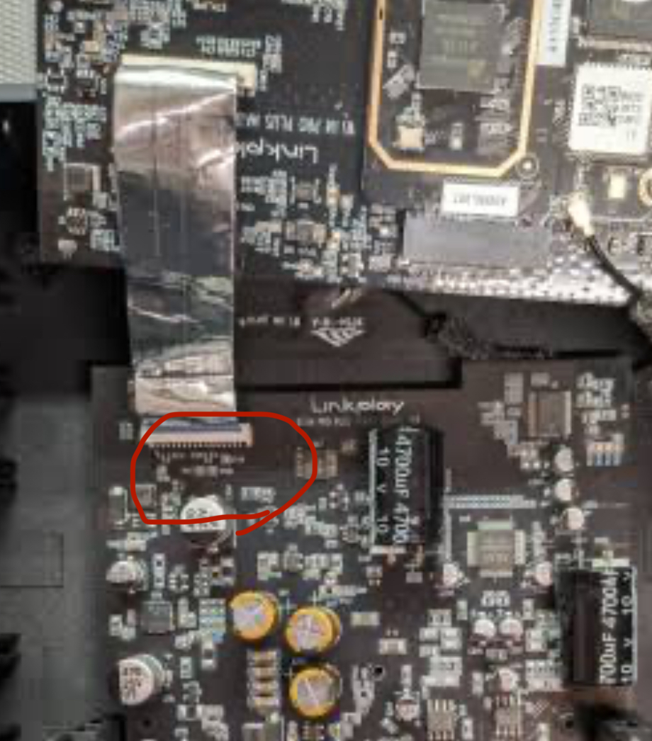

Hello. I wanted to know if you still use the i2s bus to connect another DAC? Do you like it? It seems like an interesting idea. I want to try connecting another DAC and maybe make an expansion board for the i2s output.Just seeking solder point of I2s output with tester.
You can see 4 point at red circle point, and buffer IC right hand side.View attachment 1405422
I forget to take any pictures about detail but you can understand detail with tester and dac chip (AK4493seq) document
Yes, without any problems and I am satisfied with.
Again, typically you need I2s to HDMI conversion board to connect DAC and maybe master clock needs to be converted to double.
