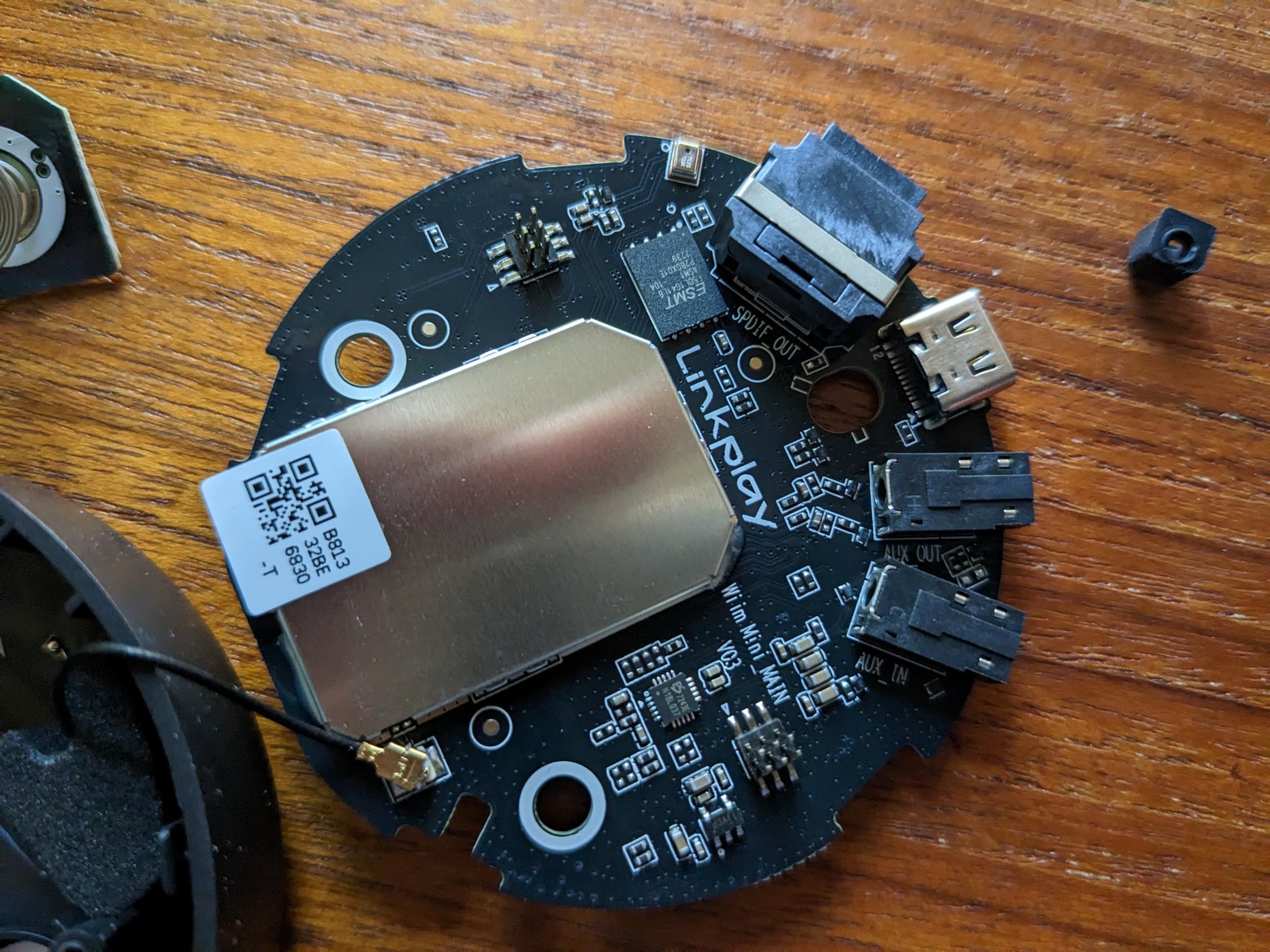

Hello. I wanted to know if you still use the i2s bus to connect another DAC? Do you like it? It seems like an interesting idea. I want to try connecting another DAC and maybe make an expansion board for the i2s output.
Hello! I am waiting for delivery of a wiim mini, my external Dac is only coaxial numerique input I own a toslink to coax converter to connect the wiim on the Dac. My question is to implant rca coax output directly on the wiim do you know where find the signal on the pcb? Thank you for this
